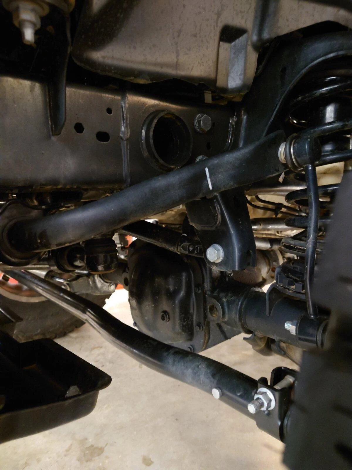

So what would be the need for changing the LCAs and sway bar links?? I don't do any serious off-roading. Just the beach and light trails.

I went with the 1" over the full 1.5" to keep a little rake. Hopefully when loaded up that with the max tow rear springs will keep it from squatting as much.
LCAs add caster, which helps steering and overall stability.
Sway bar links, because you just added 2 to 2.5" of height and your links are a bit short. It's not for offroading it's for geometry.
Check the angle of your sway bar, it should be parallel to the gront or even pointed to the sky a bit.

I only added less than 1 3/4" of height. Do you think it's still necessary?
I'd just take a look at the angle of your sway bar. If the ends are pointed down then yes.

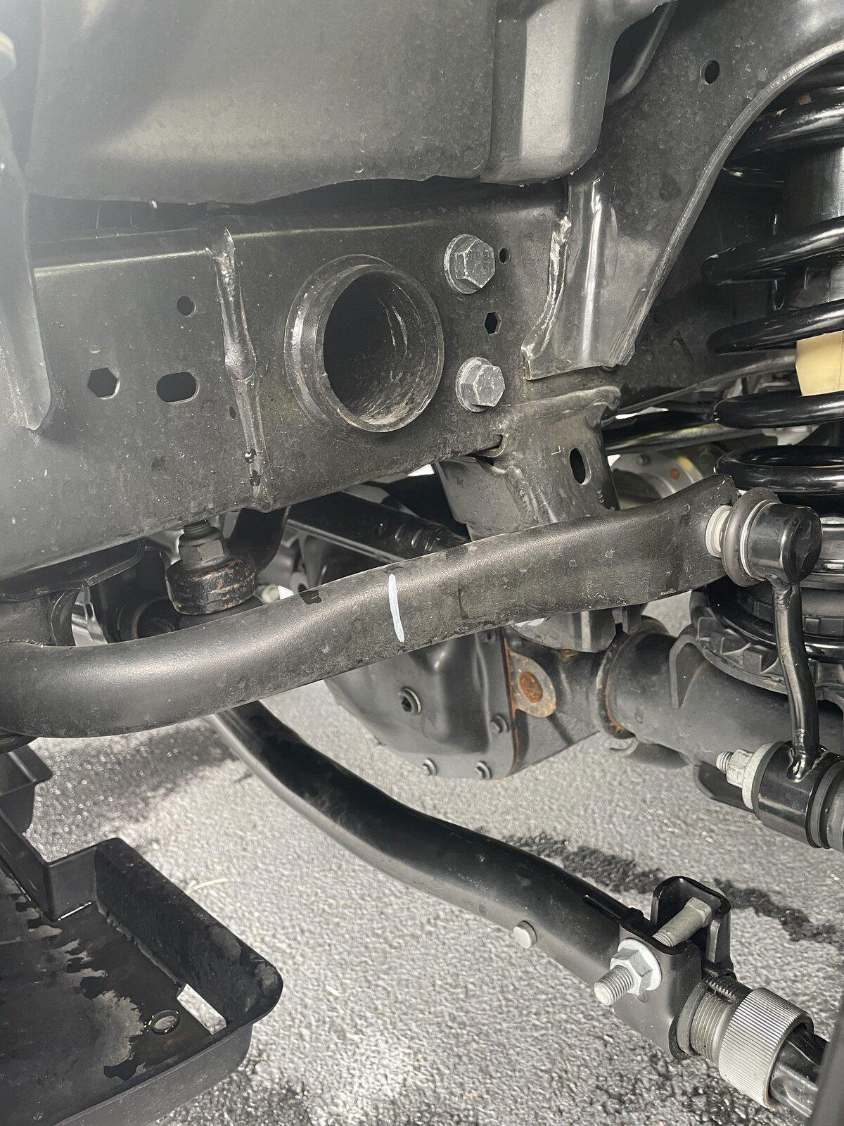

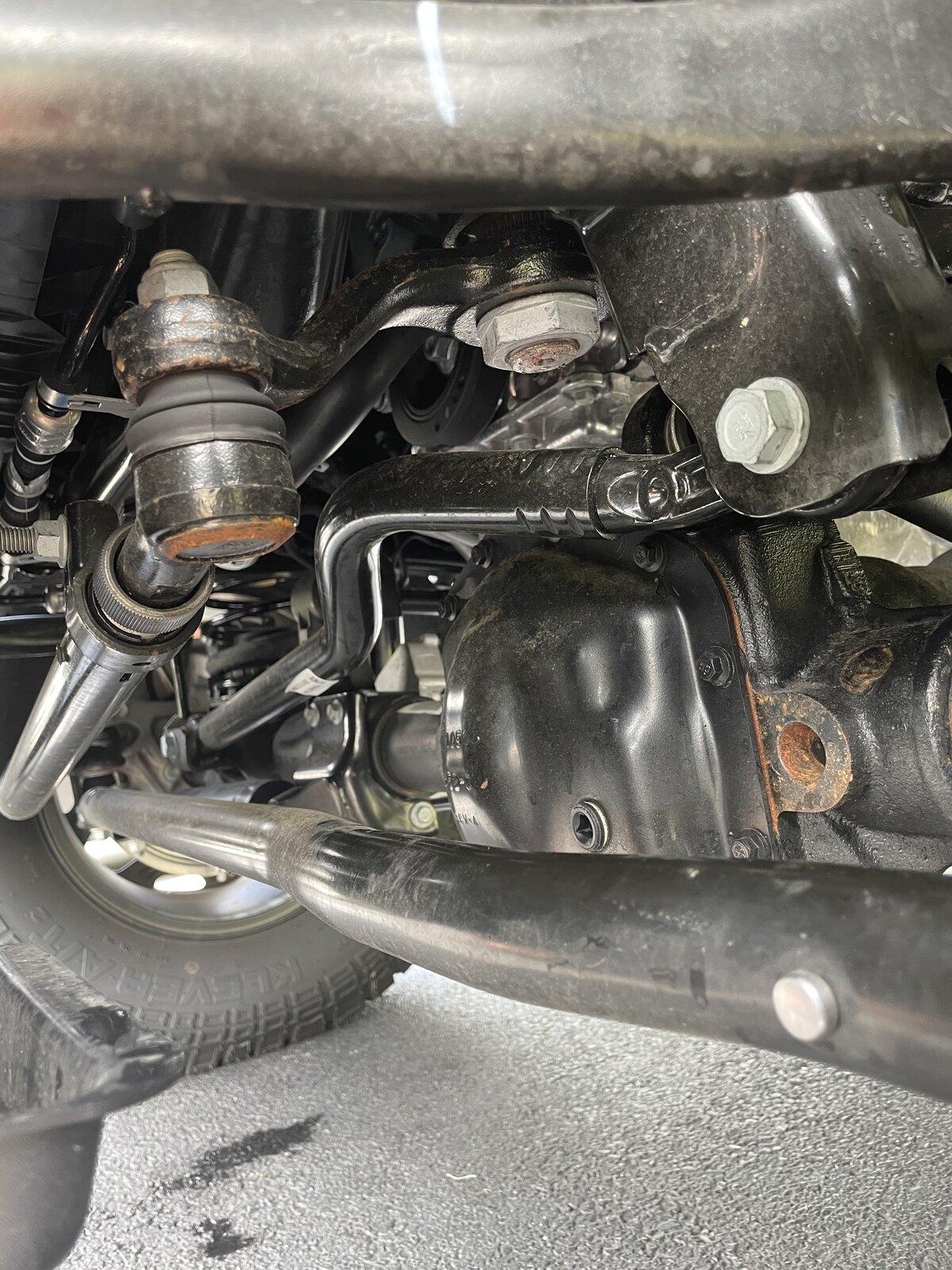

Jeep Gladiator Teraflex 1" front spacers installed - Suspension is done DSC_0640
This is mine.

Garemlin
Garemlin
Nov 4, 2017
90
1,373
1,958
2021 Nacho Willys Gladiator
That isn't your sway bar.
See the circular hole in my frame? The bar with the vertical white line is the sway bar.
Shoot I didn't notice I uploaded the wrong pic.
Jeep Gladiator Teraflex 1" front spacers installed - Suspension is done 70E79E95-FC1C-43EA-B104-F236057A905A
You're good. I used stock links with the whole Teraflex 1.5" lift. I didn't need to change the anti-sway bar links until I went up further.
Looks level. Any higher and I'd recommend longer links, so you are good!
