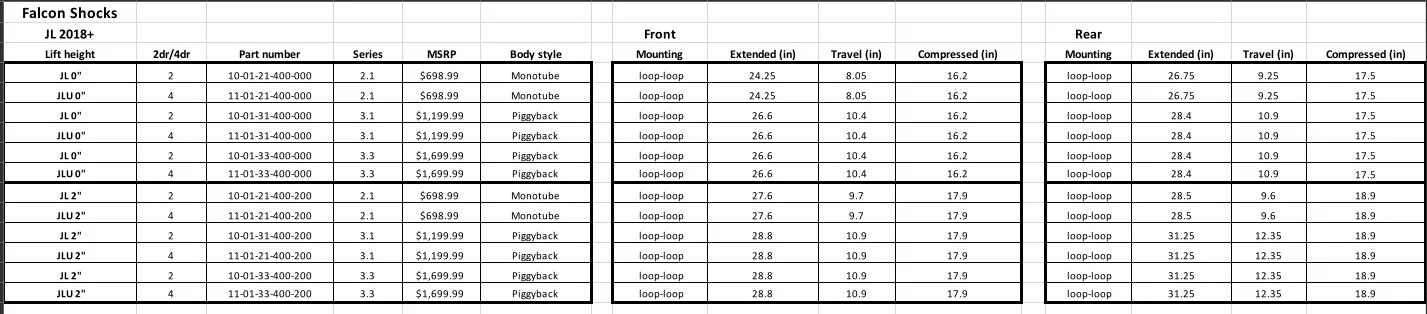

Good day guys I have a sports with stock suspension and daystar 2" leveling kit I'm looking to upgrade my shocks with falcon 3.1 do I need the model for 2" and up ? Or 2 differant model for the front and the back Because the back is only 1" spacer.

If you contact their customer service department, they will tell you the exact lengths of their various lift shocks for each shock model. I used to have them, but deleted the info after I decided on what to run. I can tell you that you can run a 28” long rear shock without needing new brake lines. In the front, the Daystar spacer will allow you to run a 26” long shock. I think their 2-3” spec is really close to that.

I just contact theme today and thay advised me to go with the 0-1.5 but my front is 2" so I'm still confused

The 3-series shocks are spec’d longer than the 2.1 shocks. Compare the front lengths on this chart for reference.
Jeep Gladiator Teraflex falcon 3.1 D2856253-68CA-404F-A0C3-1BF201B2B91B
