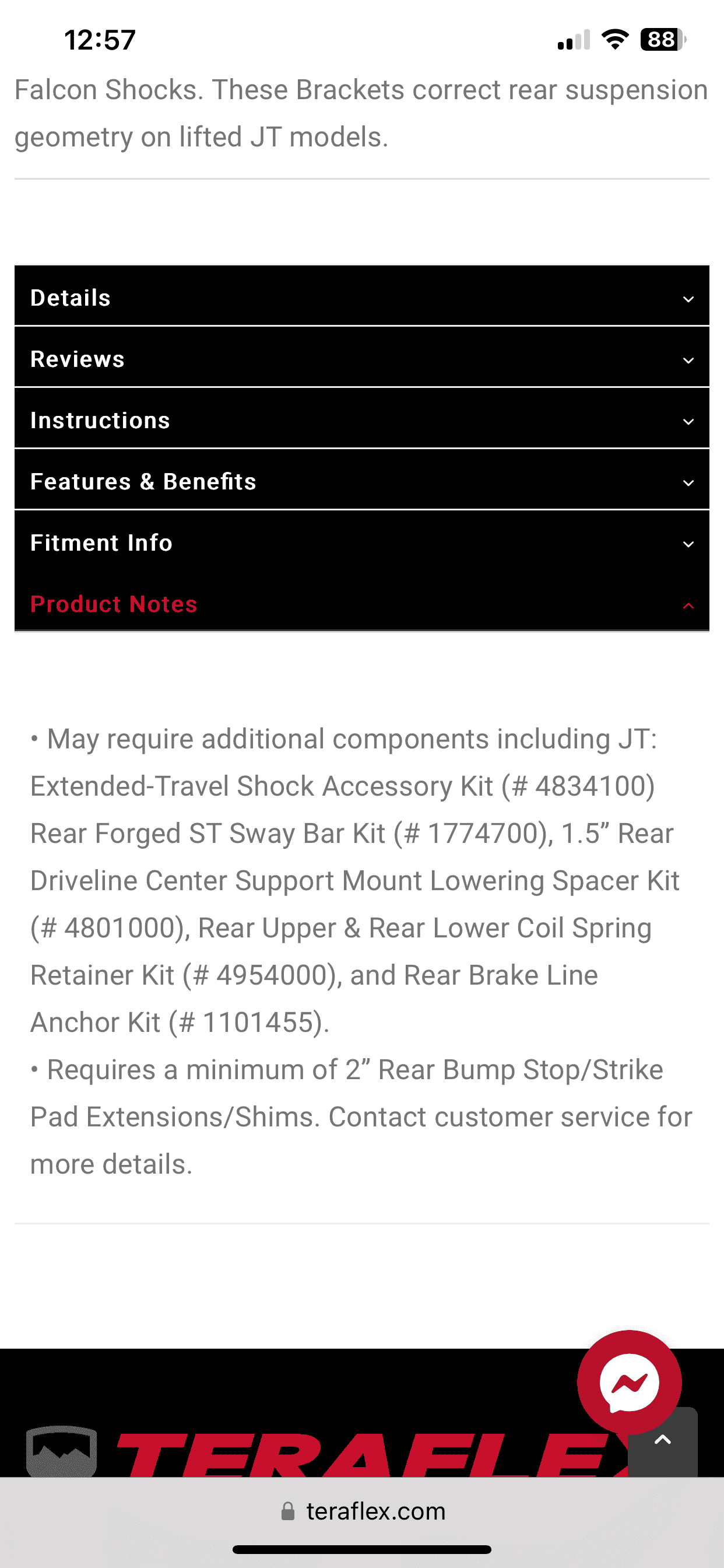

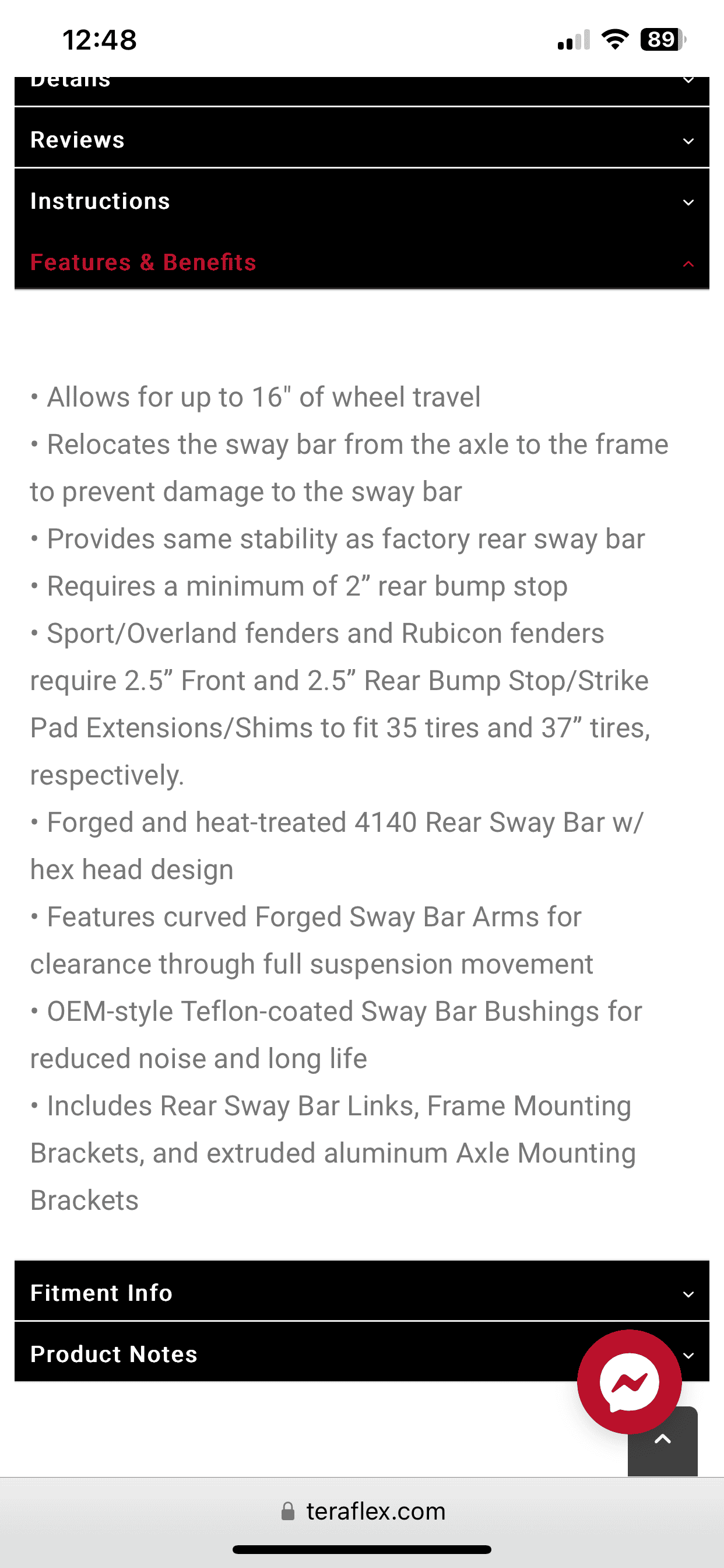

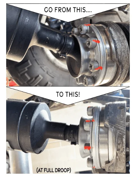

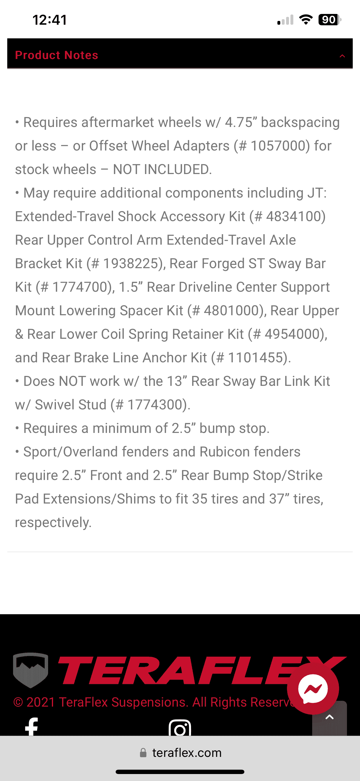

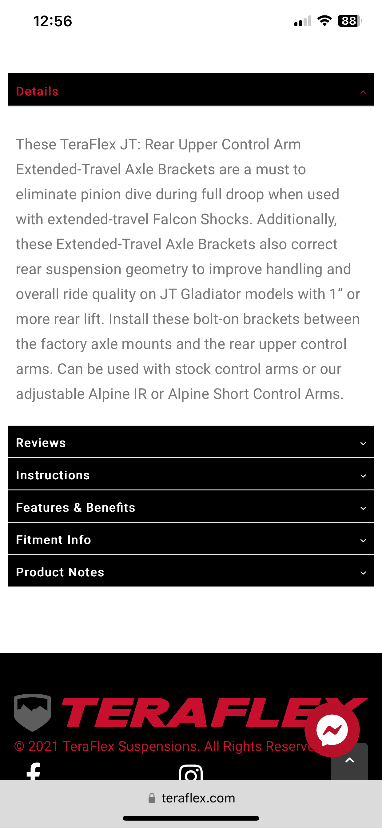

From the Rock jock page.. This is what the Rear Geo brackets do.
