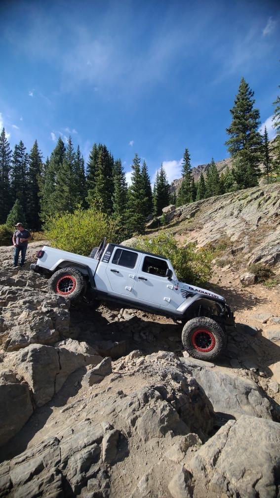

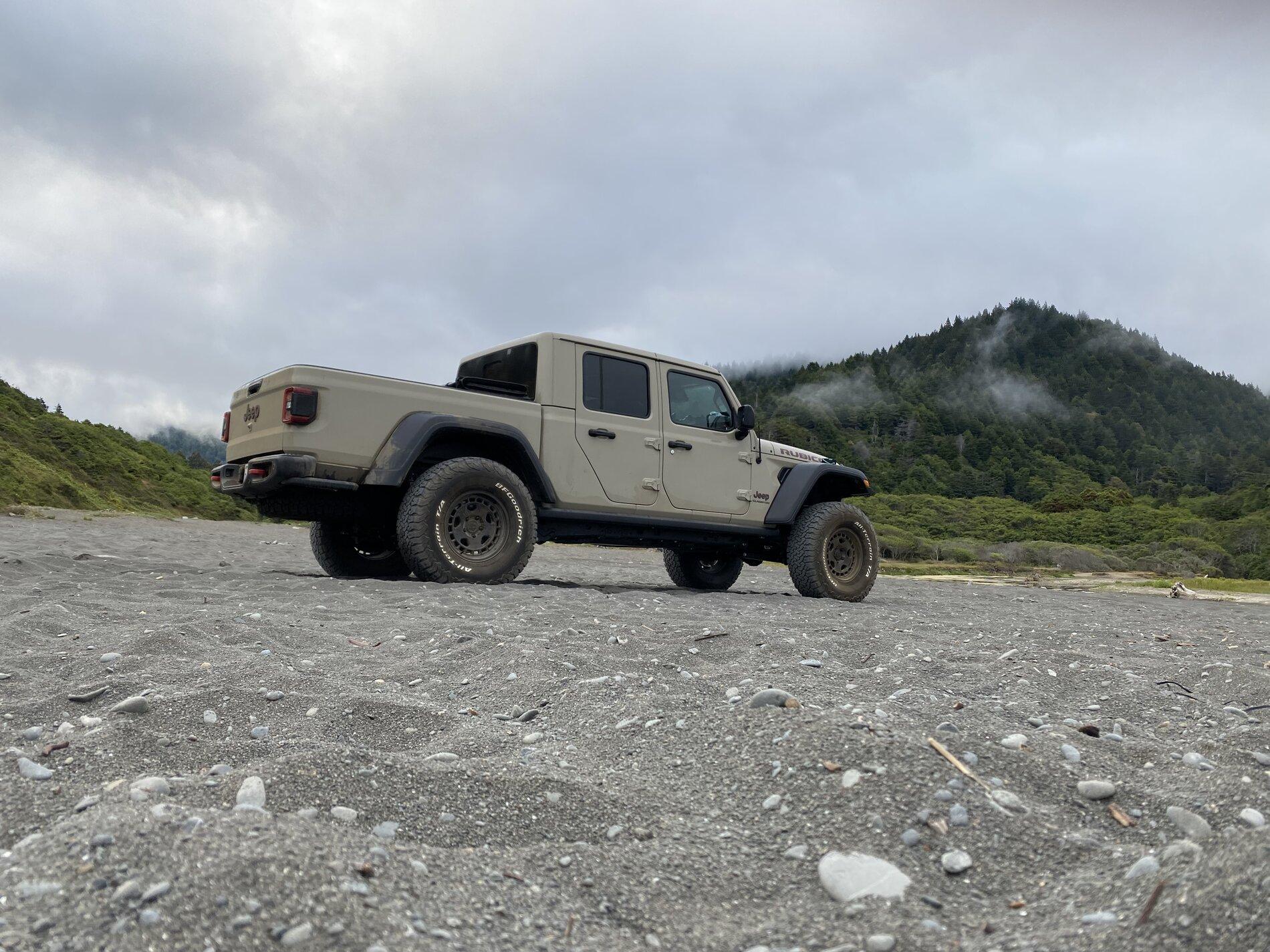

I’m running this set up. The rear springs settle in to be about 1/2” lower than the front. Just FYI, I’m measuring the rocks rail rear vs the front end. I’ve done a pretty extensive test with these over an 8 day journey. I was at 22% roll on boulders on a side of a cliff and the softness of the setup really helped me flex to safety (I think) . Happy to answer more questions.
PS
I’m running brackets: two track brackets (front and rear), with a drop arm bracket in the front.
with the truck loaded the rear sags to about an inch lower. I have a camper on order. After I install it, I might go to a 4.5 spring in the rear.
or
Get 1-1.5” rear spacer.
PS
or

Im very happy with the setup. I’ve beat it up and it’s been very reliable! I guess some rear springs sag more than others. I’ve yet to contact customer service to dig in. However, the ride is better than stock. The adjustable falcons are incredible and I can tell a real difference between the modes. I don’t recommend going to the soft setting on a twisty one lane highway unless you want to drift around.
Jeep Gladiator Teraflex 3.5” lift kit C0CD6D13-AFA7-4C7C-AC0D-D05E993E4A2D
Jeep Gladiator Teraflex 3.5” lift kit CE912024-2A78-42A1-BD30-C4052C03094C

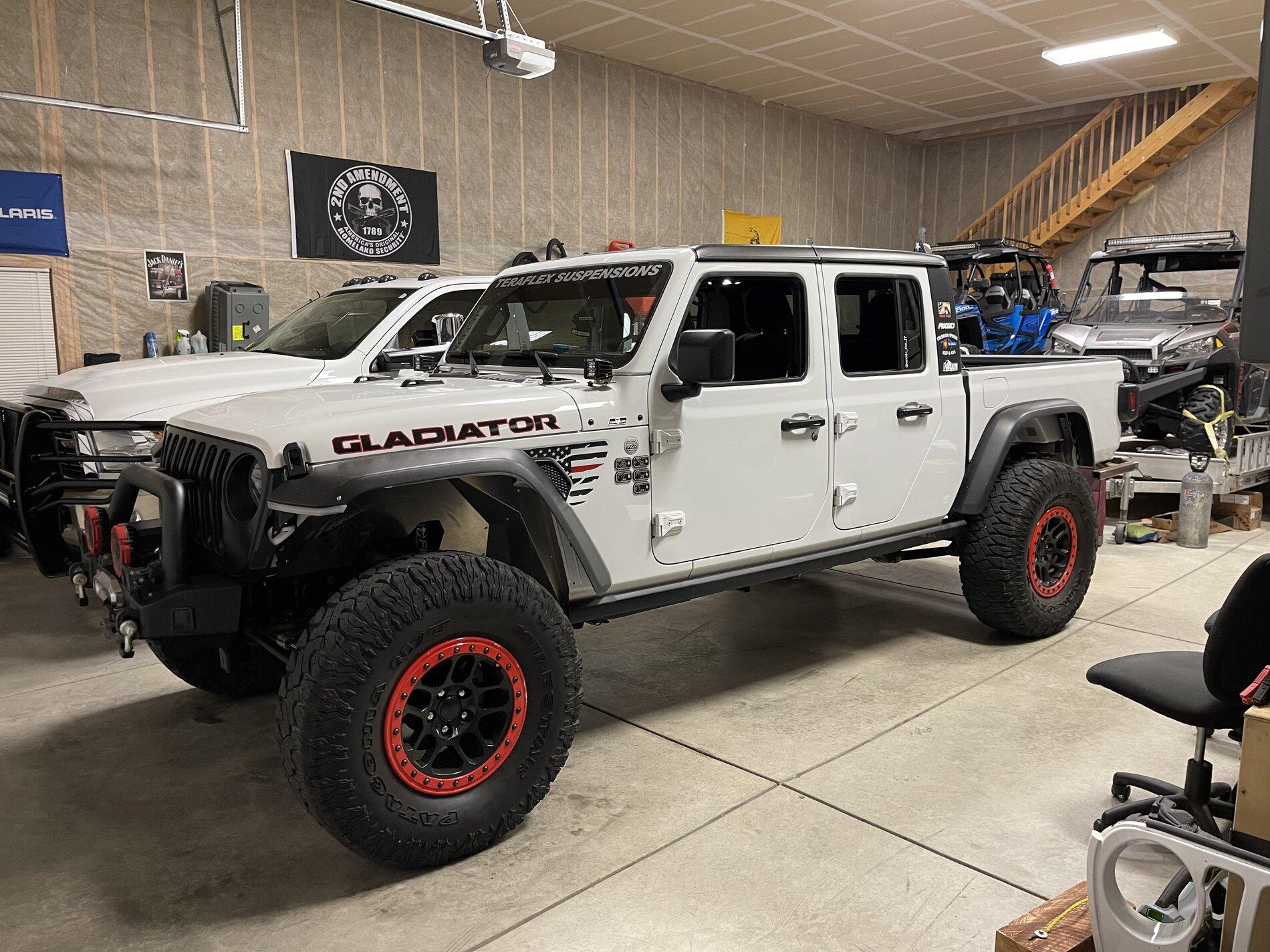

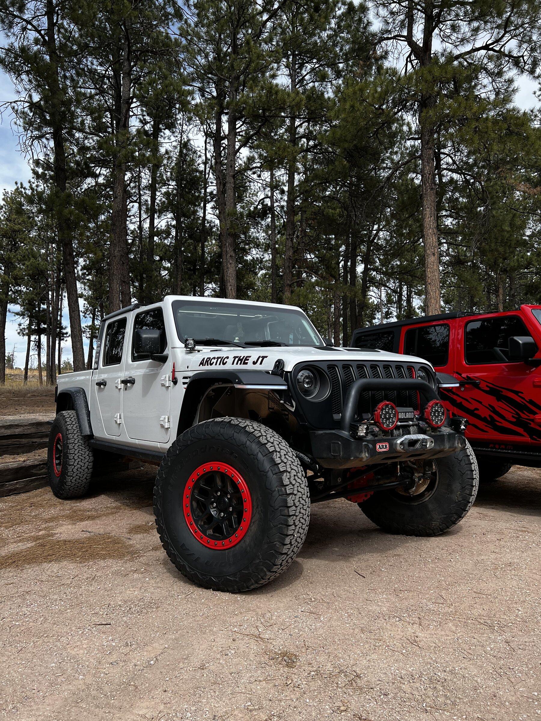

I also have the teraflex 3.5” on my truck! I love it! It drives nice and rides great! Off-road is almost as smooth as on road. Got me also to do 38s on mine so I got a 38” tire and one day imma go to 40s.
Jeep Gladiator Teraflex 3.5” lift kit 656AD5A7-858D-43BA-AA44-BDAF4E2D291A
Jeep Gladiator Teraflex 3.5” lift kit 9B9234FC-BE5D-4F54-985C-D4358E2B6675
Jeep Gladiator Teraflex 3.5” lift kit 10CDF010-210D-404F-9744-4915659B3EC1

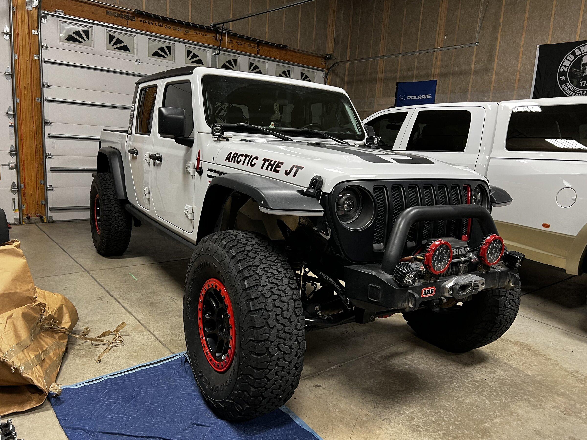

I stepped it up a little. Now I'm running 39s.
