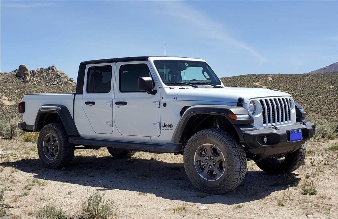

For what you want to do I would suggest the Mopar 2" lift. I put one on my Sport Max Tow and ended up with 3.25" in front and 2.5" in the rear. I've been very happy with it. It rides good on the street and off road.
I paid around $1250 with free shipping though it's probably a little more now.
Here it is with Rubi take-off 33" tires.

Looks great! Does your truck have a rake? If not how did you level it? I have a JTR and want to find a solution to getting rid of the rake with the mopar 2in lift

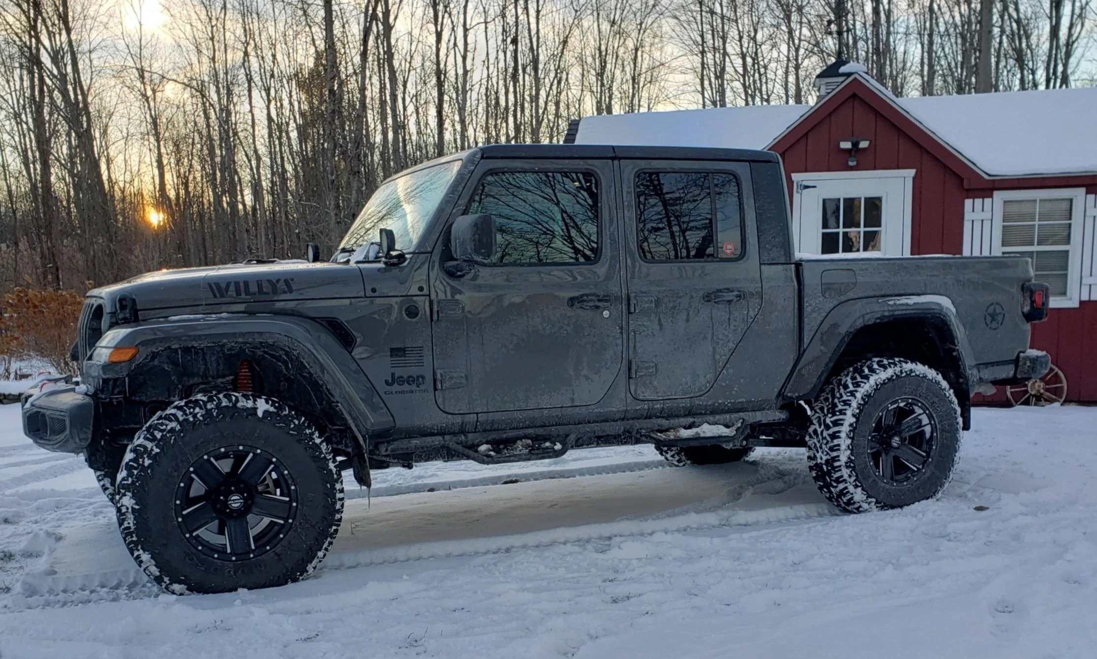

So I'll bet the 1st in re-guards to tampahoosier, I'm good w/my RC 3.5 coil lift. I also added 3/4" spacer in rear, front lower control arm brackets, dual steering stabilizer kit, Johnny Joint adjustable track bars, Rock Jock carrier bearing drop kit. Rides great, handles great. Works great for me, as well as many others. It leveled it, that's why I added the 3/4" rear spacer. When it's NOT single digits freezing cold outside, it rides great. Maybe down the road I'll change the shocks, no hurry. There's so many choices, it's hard to decide. Get what fits your budget, works for you, & makes YOU happy. Not everyone can afford, what others consider reasonable. I'm one of the lucky guys that had the time & enjoy doin it myself. Good luck & enjoy makin it your own!
I did not level it. There may be a slight rake but hard to tell. If there is a rake it is definitely less than the rake with stock springs.
A lot of folks use the Tereflex spacers with the Mopar lift to get rid of any rake.
Thank you!
