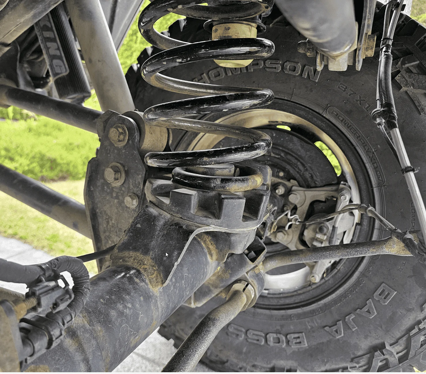

@Rusty PW Any chance you could you measure the widest part of the bump, the gold cap that the Hydro bump screws into? Have you noticed the spring hitting it at all? What about spring bow, the factory upper isolator is tapered and I had to rotate it to get rid of the bow in my springs. With the JKS adjustable front bump the spring sits on it which looks to have a flat rubber isolator.
The rubber isolator on top is a flat piece. I have a little bit of bow on each side, but in different directions. The springs haven't rubbed. Have to wait until it quits raining for the measurement.
The diameter is 2 13/16".
