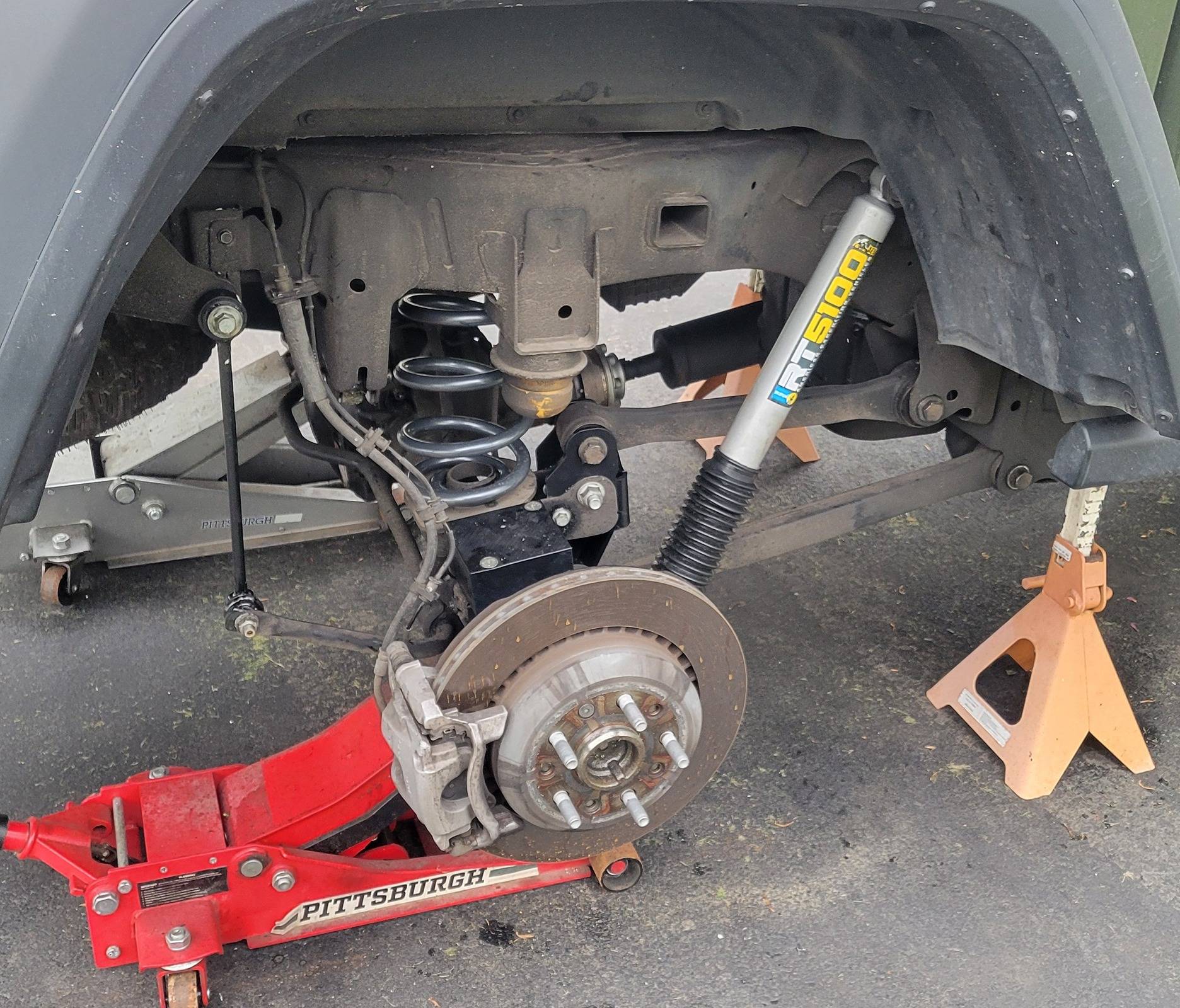

Interesting, I installed the Teraflex rear brackets when I did my AEV 2.5" lift install and have had no complaints. Rear stays firmly planted even on the crappy South Philly roads on my work commute.I guess some suspension setups are just different enough that it affects some people.
I have the same set up and same sentiment
