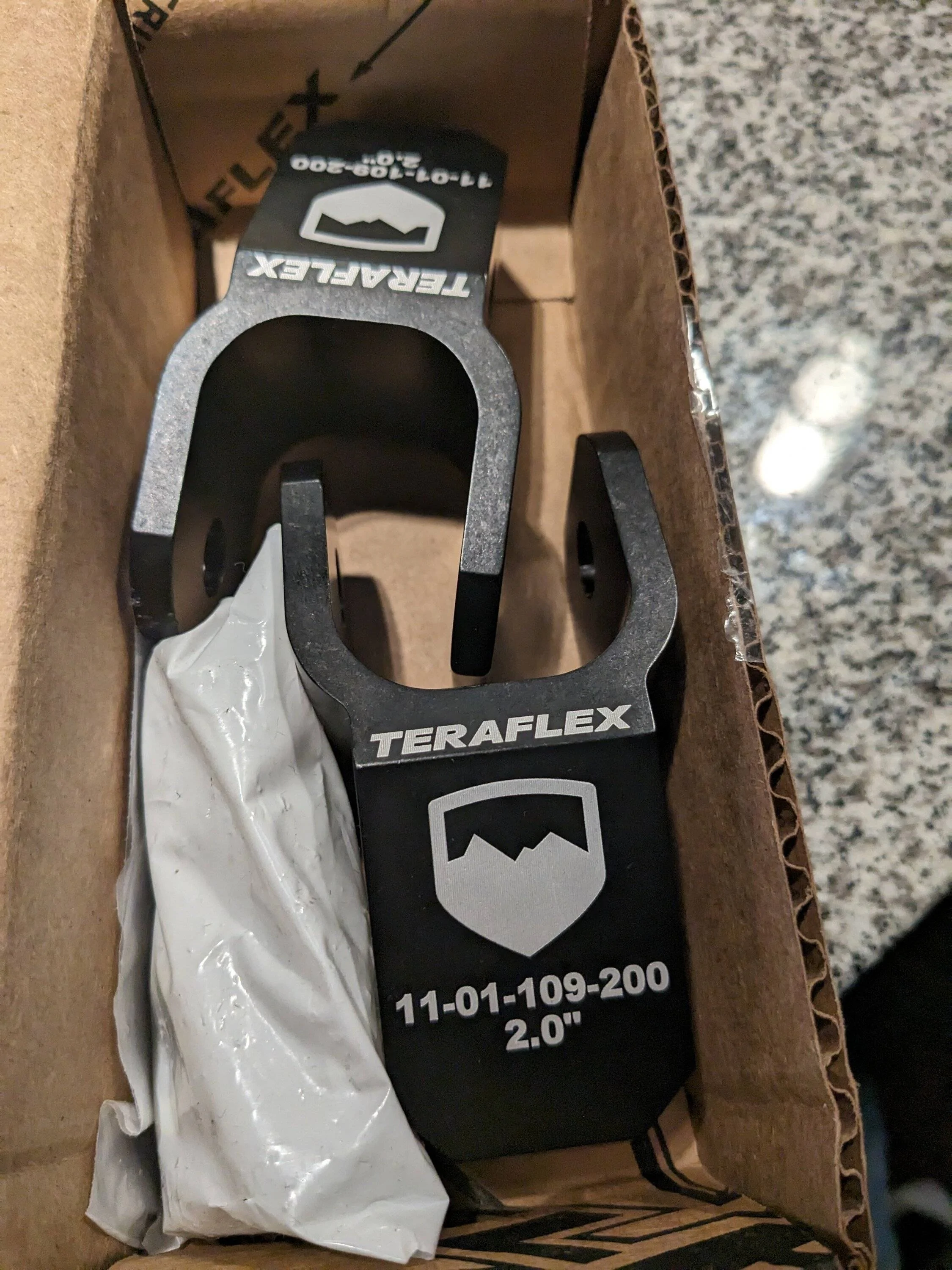

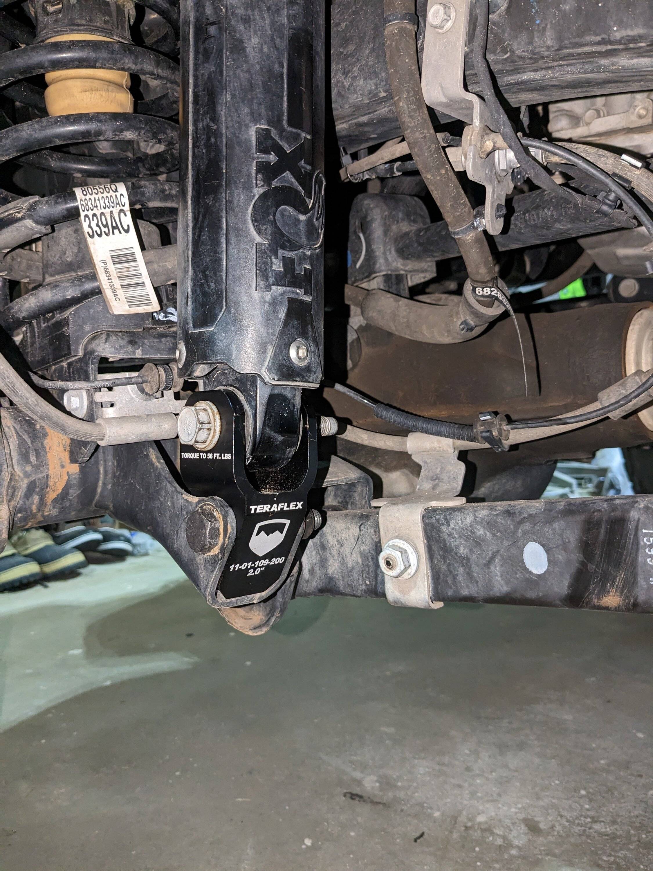

I'm running the TeraFlex 2" extensions. They definitely help with the shocks and suspension allowing more travel. I have 2" spacer lift front and rear.

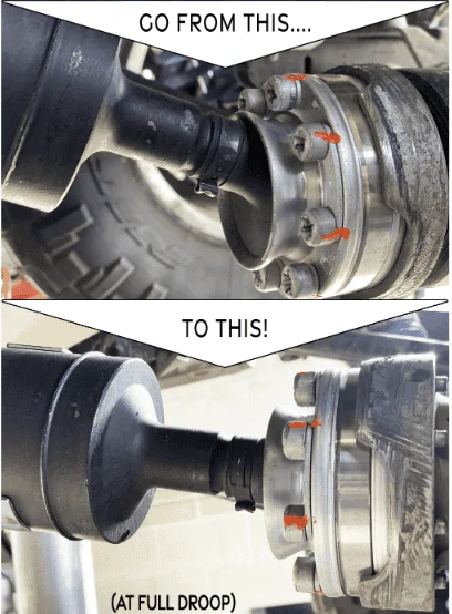

I have the Teraflex ones installed ( 1938225 ) installed, ie the ones in the original post for the control arm bracket. Helps when you droop the rear end. I was able to lift my rear end and get my 4.5" Evo springs out without disconnecting the rear drive shaft when I was doing some work. Without them it would bind up at the rear pinion so I used to have to remove the rear driveshaft to be able to droop enough to get the springs out.
They reduce pinion dive during suspension cycling which I can only see as a good thing.

Necro but might as well add my +1, I have these too (as part of their whole extended rear travel kit). Rear brackets (any make) are not like front brackets where you might expect a difference in daily driving (see post #6) - it's strictly for improved angles at full droop. And only if you've made it possible to droop more than stock anyway - stock sway bar, stock control arm joints, stock brake lines etc will all limit things. And you'll likely get away with the pinion angle shown above for a while too. Anyway I'm a big fan of the travel I get in my rear suspension with this setup, even with a big overland camper load on it
