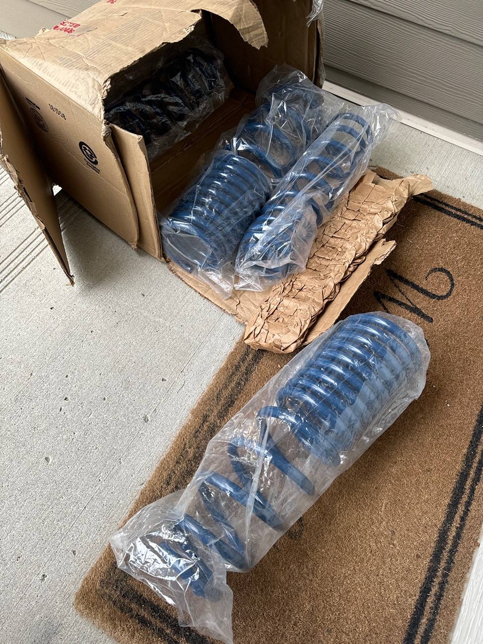

AEV HD’s have landed. They’re progressives, so I was mistaken calling them linears. Will have a go at it next week and report back with photos.

Any idea on the spring rates?
What's the unsprung length?
After you put them in, be curious what your ride height length is as well.
Could you grab the inner diameter as well.
22” tip to tip (not sure how they normally measure unpsrung length). Will get more Monday
Spring rates are a carefully guarded secret for AEV. Their standard duty coils are good up to 400 pounds over GVW. The HD's (blue ones) are good to 700 over GVW but I can say they hold well even pushing 1,000 over GVW. But with the HD coils its really best to have their remote reservoir shocks rather than just the standard.
