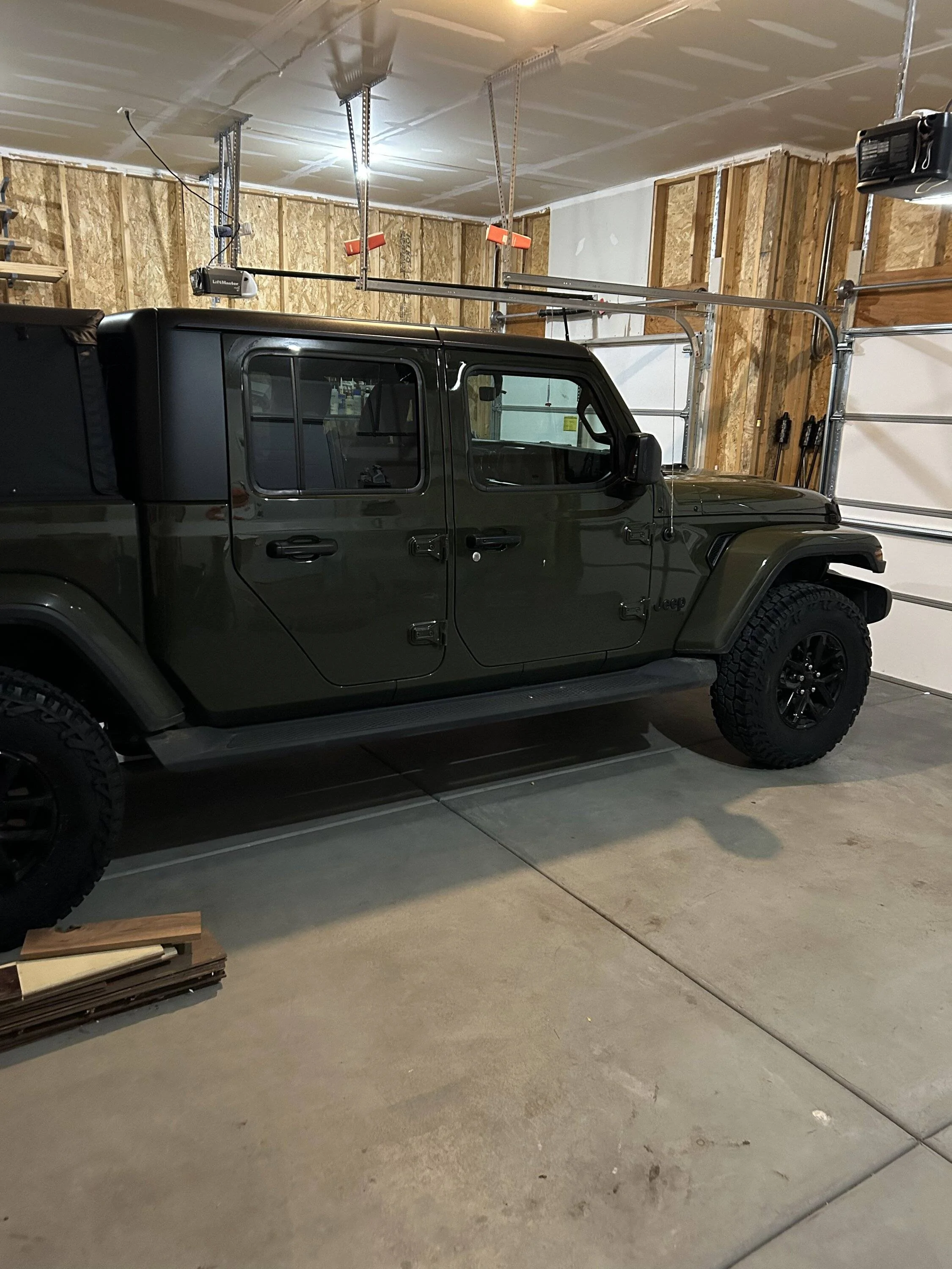

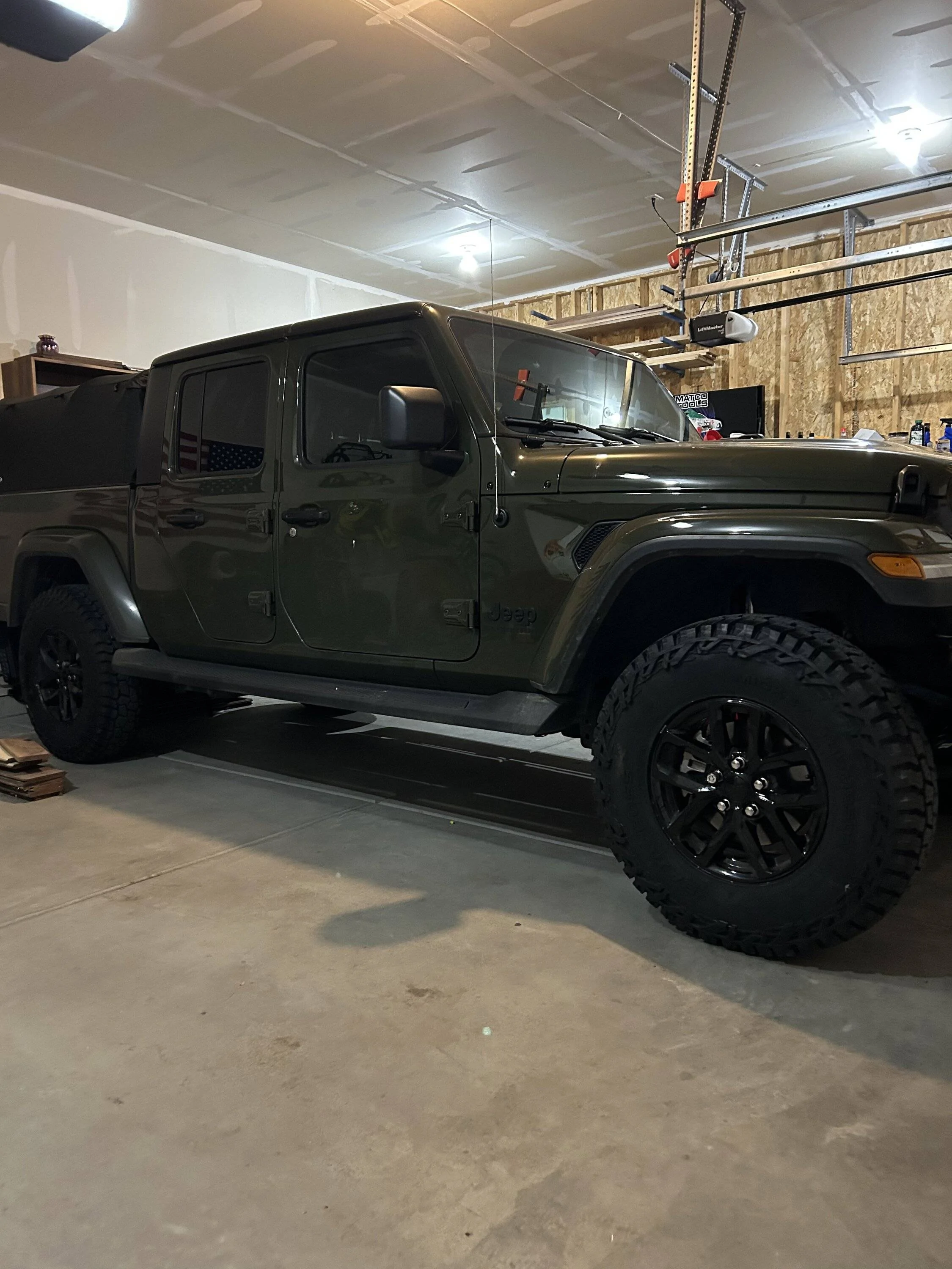

Just installed the 2.5” kit with adjustable track bar. Not seeing many reviews on it. I had no issues with similar product on my JK. Looking forward to trips to silver lake and panther rock next year.

Received email back from Teraflex. I asked about restoring some of factory rake ,after installing lift, for towing/hauling. They suggested 3.5” outback HD coil springs and confirmed it would be equal to 1.5” rear spacer in 3.5” spacer lift kit. I’m leaning towards the coil springs.

That looks really good! Was the stance pretty level with this kit or still some rake? Did you use the stock shocks or get different ones.
Thanks. Front fender flare was 1/4” higher than rear before I added bumper and winch. I chose bilstein 5100 shocks. They say the kits are designed to be level.
