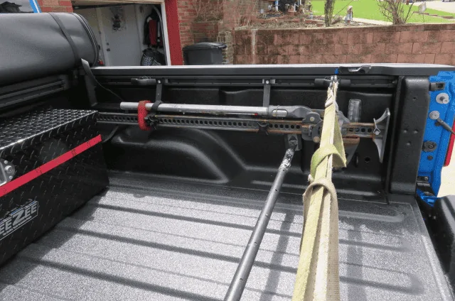

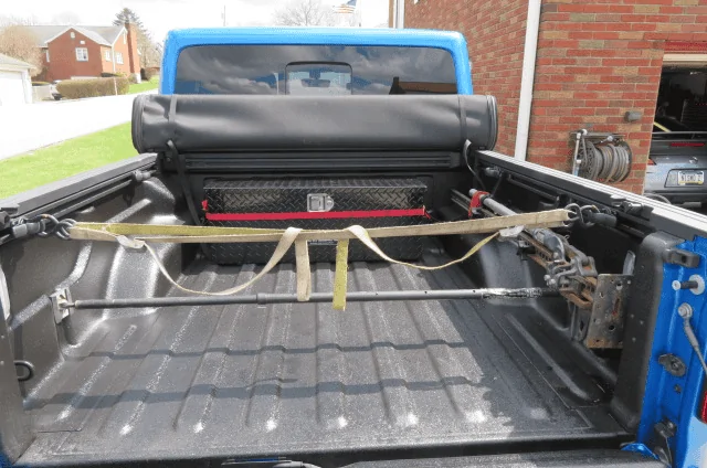

do you have the turn buckles mounted to the front two bed hooks?
I installed a eye hook on each side of the tool box, about half way up. Have the turn bucket going from there to the front bed hooks.

I've read somewhere that its a good idea to only use two attachment points, on opposite corners. This allows the bed to more easily flex which is the way the bed acts without a box.
It probably isn't that critical either way.
