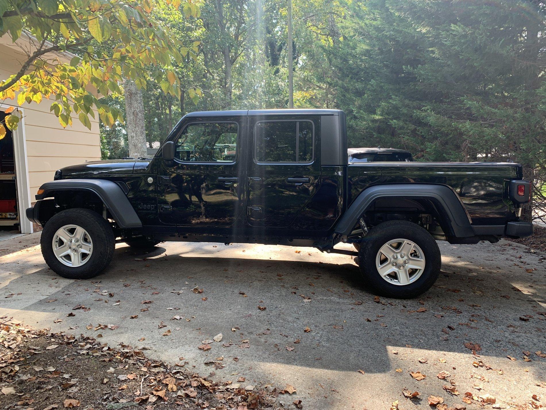

If that’s all you want then I’d stick around the 1.5” range. The 285/70-18 is a perfect size for that while keeping the stock wheel.
Is the 285/70-18 going to fill the wheel well and look nice?
kelkolb
Kelley
Aug 21, 2019
400
300
Greensboro, NC
2020 Gladiator Sport S
Mechanical Engineer
That’s 1.5” in diameter larger than your stock size. So if you do a 1.5” level, you’ll be gaining 0.75” of wheel well overall.
If you want a better size for looks, the 285/75-18 is 2.7” bigger than stock. Approximately a 34.8” tire. That would probably work the best but it’ll also be worse gas mileage.
Deleted member 31576
Gotcha - I just ordered the TeraFlex 1.5” leveling kit. It will be here Monday.
