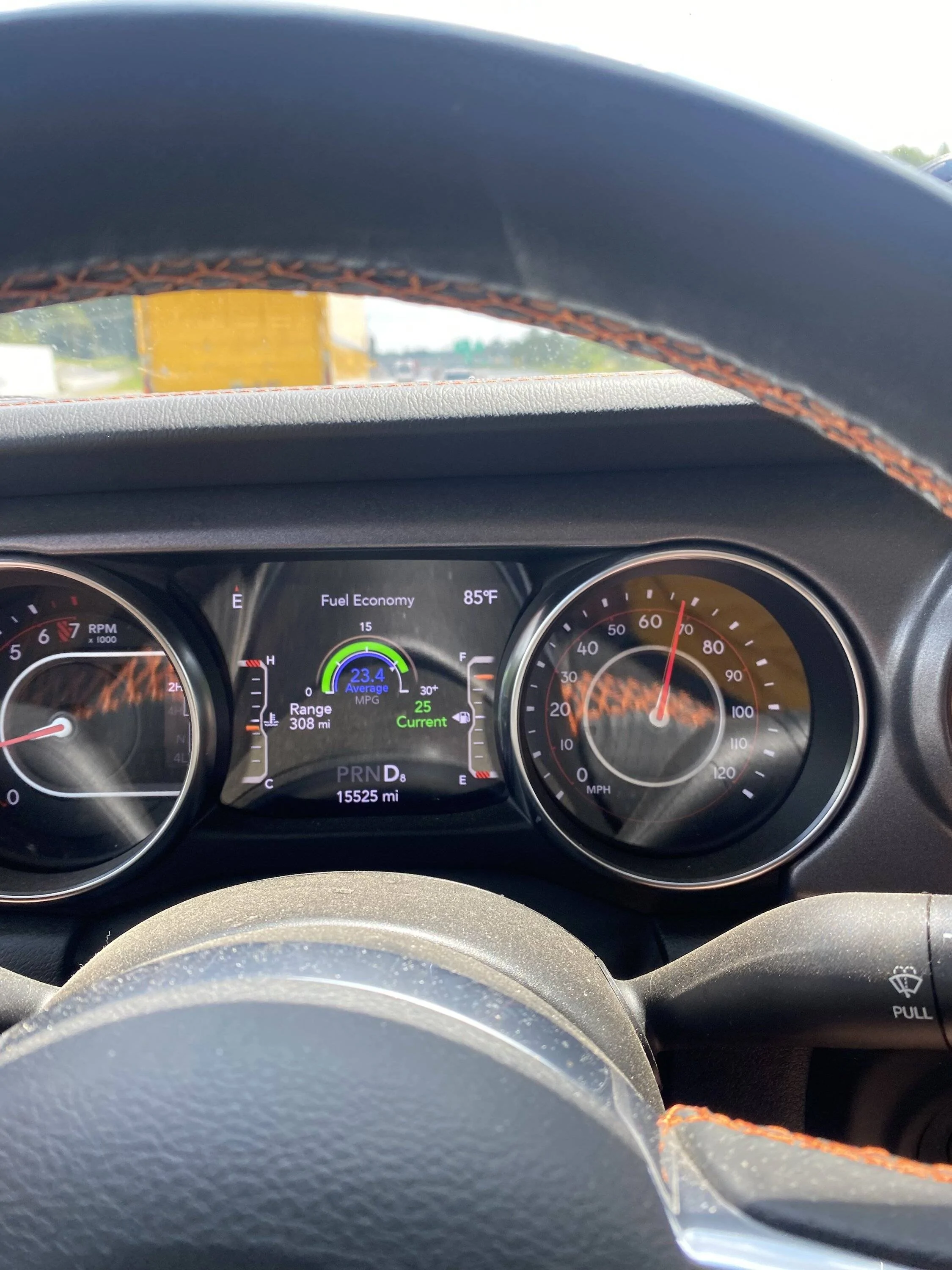

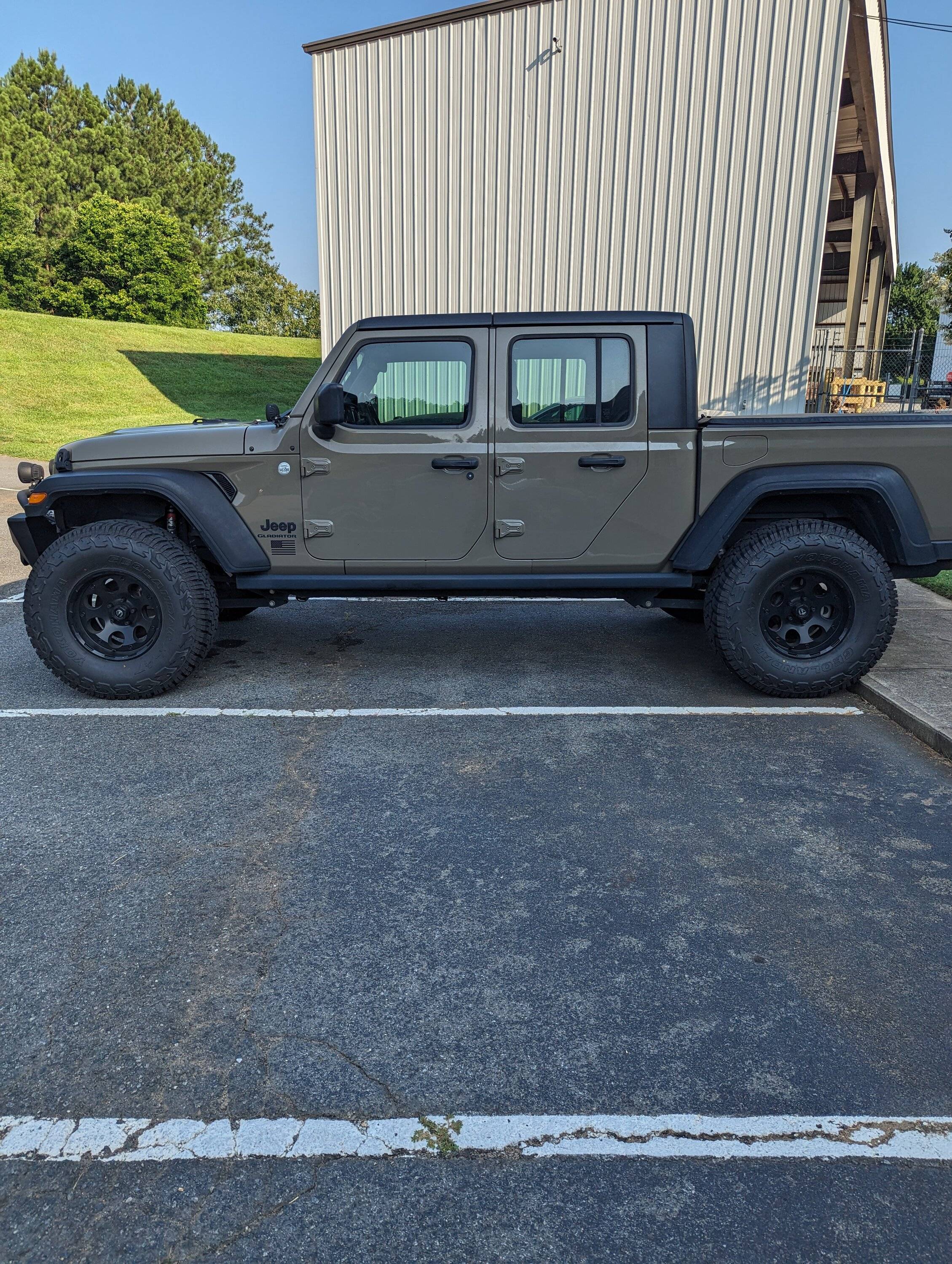

I just added 37” Ridge Grapplers to my JTM, all I’ve done is used the AEV Snap ProCal that came with the spacer lift. My performance is relatively unchanged, my mileage is the same. I love it! I have the right amount of clearance for most anything I would attempt now. Here is pick from yesterday’s trip, I’d accidentally slowed down a bit while taking the pic, but had been running 70.
Jeep Gladiator Thinking about switching to 37s on my daily. Bad idea?? IMG_3755

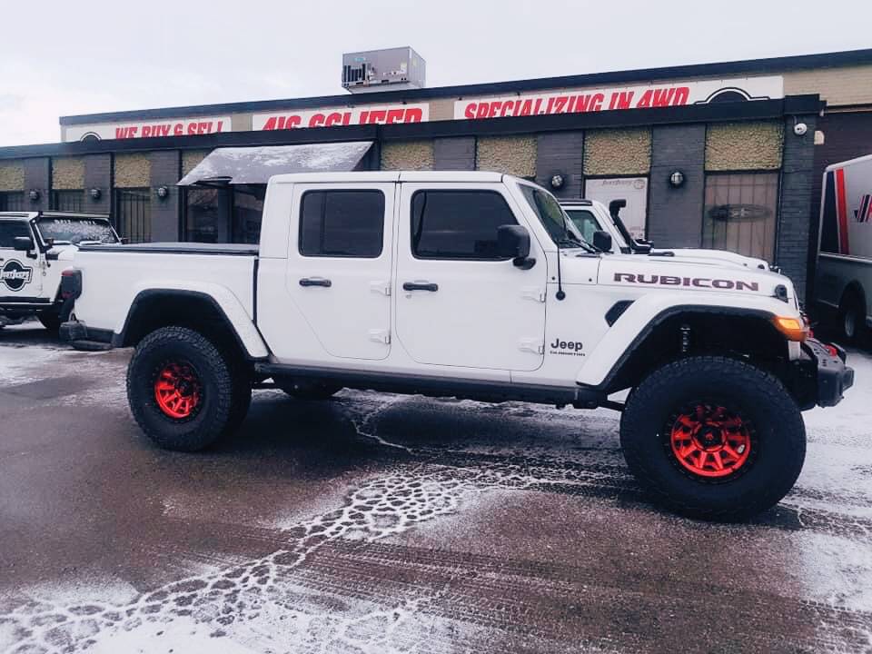

so first up i would recommend you not listen to the majority of the milkshakes on this forum saying you have to re-gear. Is it necessary NO!
I have 37 Falkens AT3W's and ran with no-regear for a while with no issues. if you use your jeep as a daily and getting to work involves tackling mountains, rocks and major elevation changes sure get a re-gear but I'm sure by daily you mean driving on paved roads and going through the local Starbucks so no re-gear. If you have a Tazer that should be enough

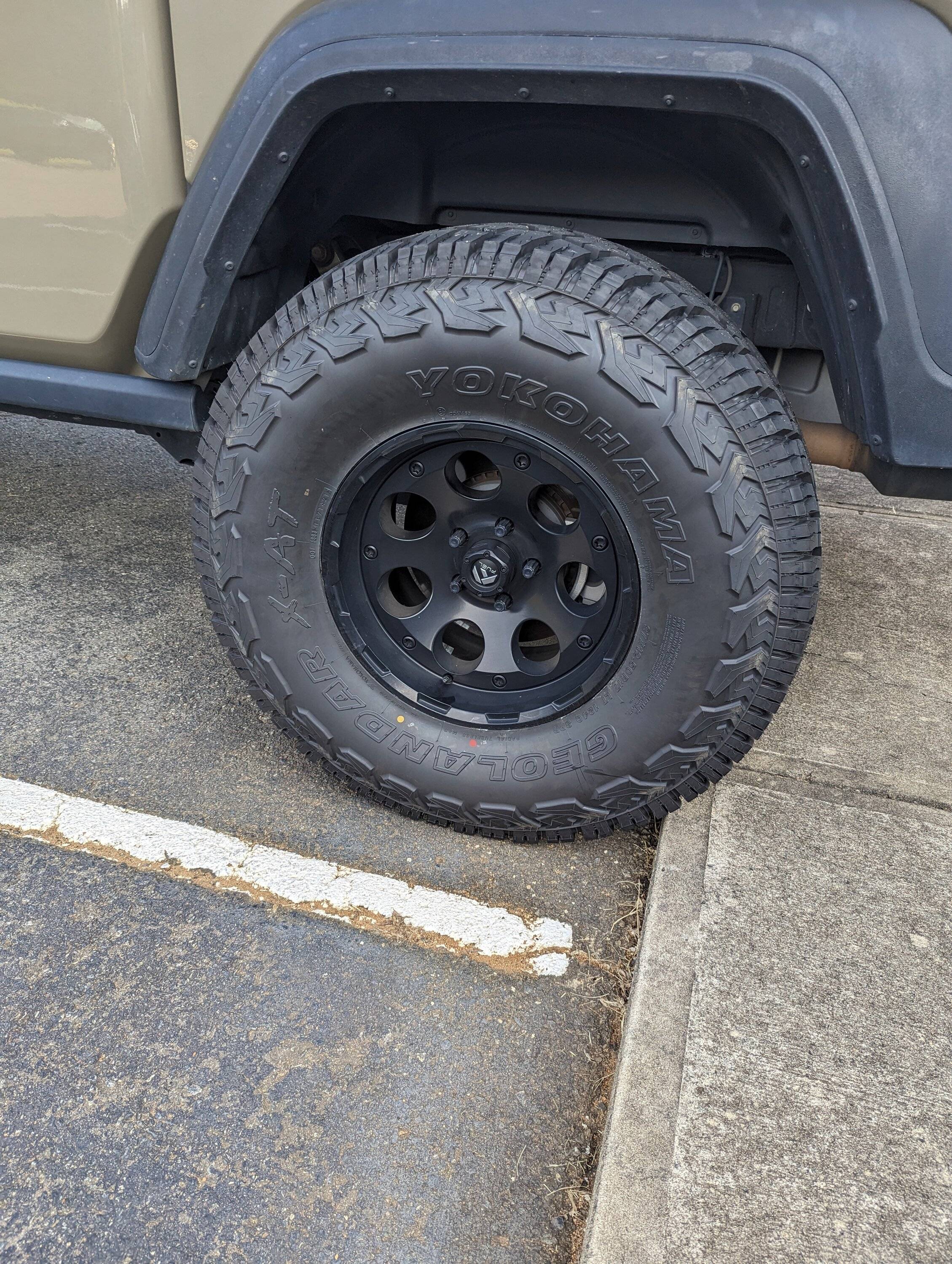

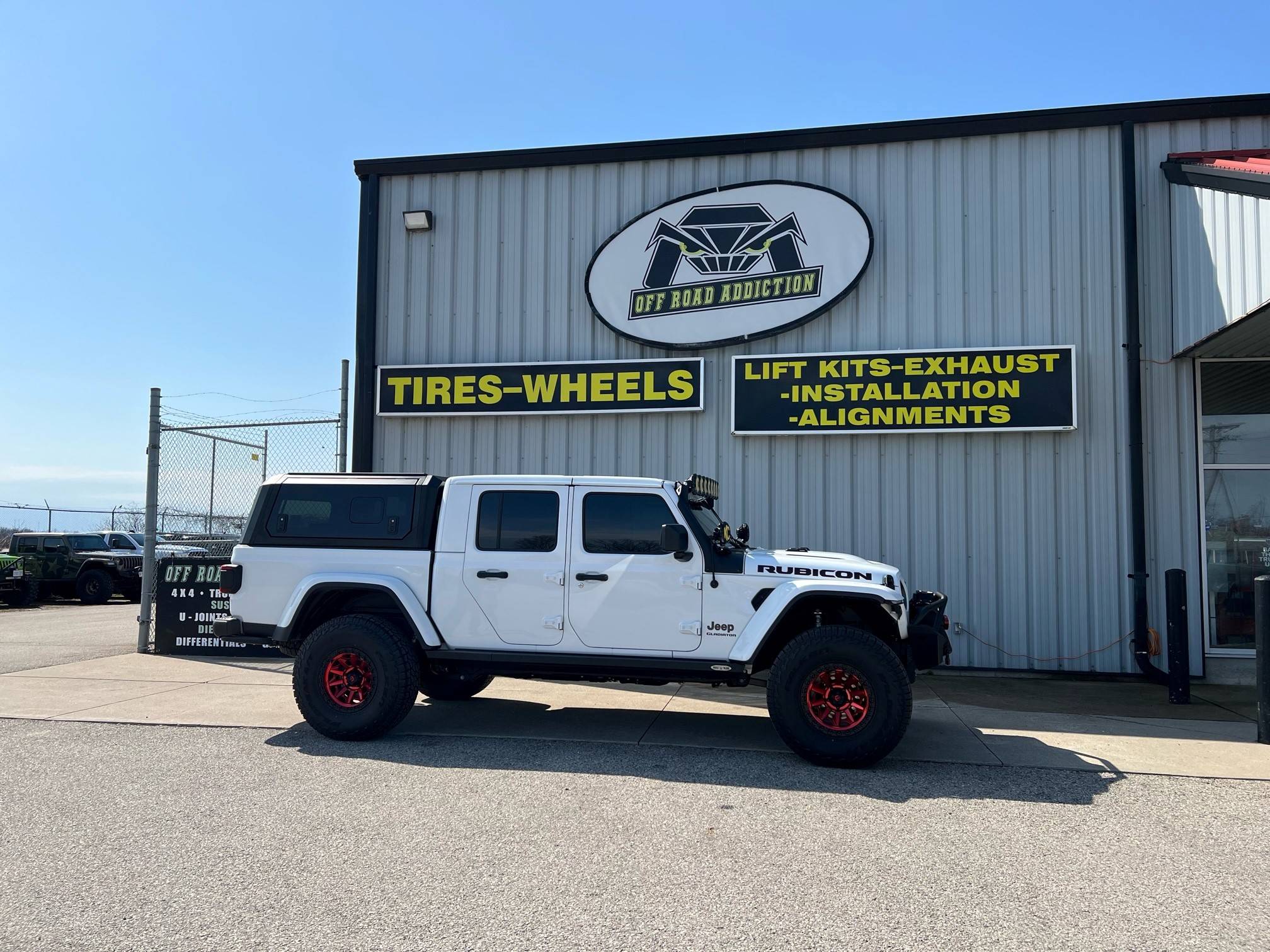

Some pics of mine with the Mopar lift w/h a 3/4 spacer in front and after with the RSI cap
I did re-gear with 4:88's as i am on flat land
Jeep Gladiator Thinking about switching to 37s on my daily. Bad idea?? XVSK8629.JPG
Jeep Gladiator Thinking about switching to 37s on my daily. Bad idea?? JT RSI2

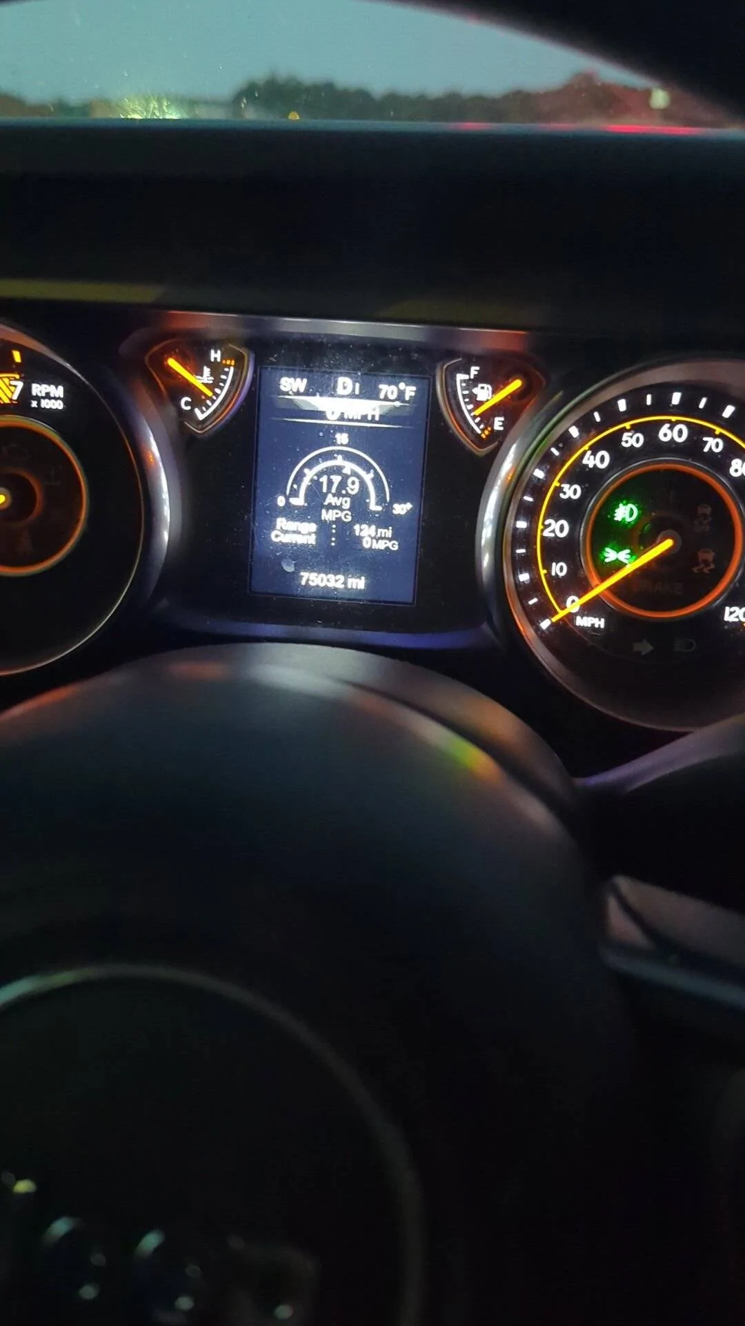

No regear on my 2020 Max Tow and I get around 17.2 to 17.4 average on mine most of the time. Never under 17 for the most part unless I'm idle for a extended period of time. I drive mine sensible and keep it between 68 and 75 for the most part on the interstate and I do about 5 miles over the speed limit in and around town. I don't floor it on take off either. Been running 37's for over 2yrs now. Ran 35's in a BFG KO2 for the first 10 months on ownership then swapped to Goodyear Kevlar 37's. I had Kanati trail hogs on in 37's before I just switched to the 37 12.5 17 Yokohama Geolander X-AT. Never had a problem with any of the tires I've ran so far. The Geolanders seem quieter than any of the other ones I've ran but other than the Goodyear Kevlar, the other tires were quiet as well.
I got a 2.5 inch Readylift SST lift kit in my with Rubicon Takeoffs suspension as well. I spent a lot of time thinking about my setup so I could get the most MPGs out of Jeep once I swapped to 35's and then 37's that's why I went with the full width bumper and found a winch bumper combo under 150lbs. Also went with a lighter 37 ad well and lighter wheels. Mine rides good and feels great on short or long trips, wouldn't say it's better than stock but it's a good ride for having a lift and larger more aggressive tires. Swapped to 35's second day of ownership and lift on the 3rd day.
As far as is it a bad idea, that's for you to decide. It was a good idea for me because I wanted it and I love the look. Performance will take a hit but if you find a lighter 37, 4.10 gears are fine. I still see 8th gear most of the time in mine unless I'm doing over 90 in it. I live in the foothill/ Piedmont section of NC so it's not flat where I'm at and I normally take a monthly trip to the Blue ridge mountains around the Asheville area And we average around 18.2 mpgs when we go up there.

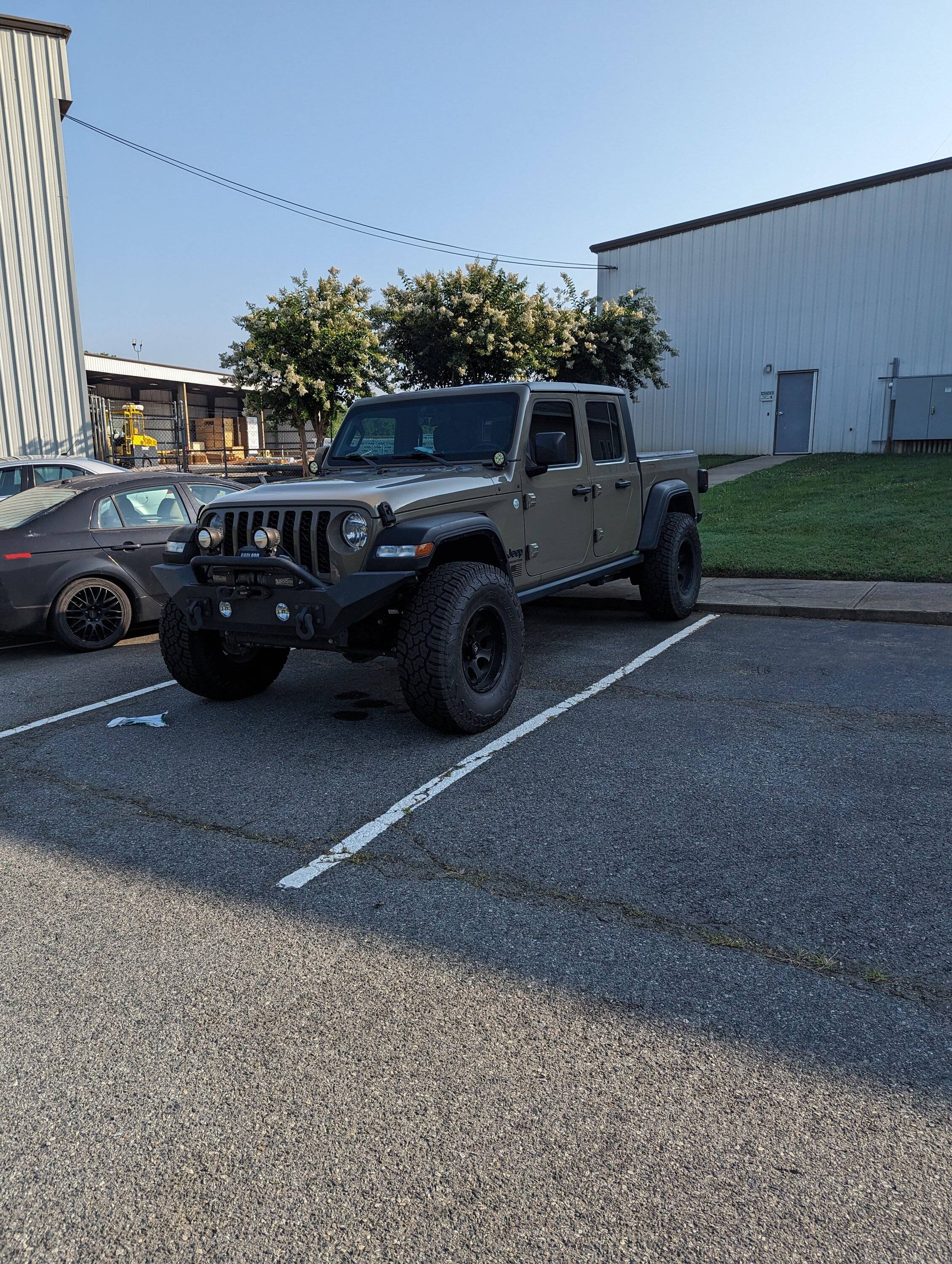

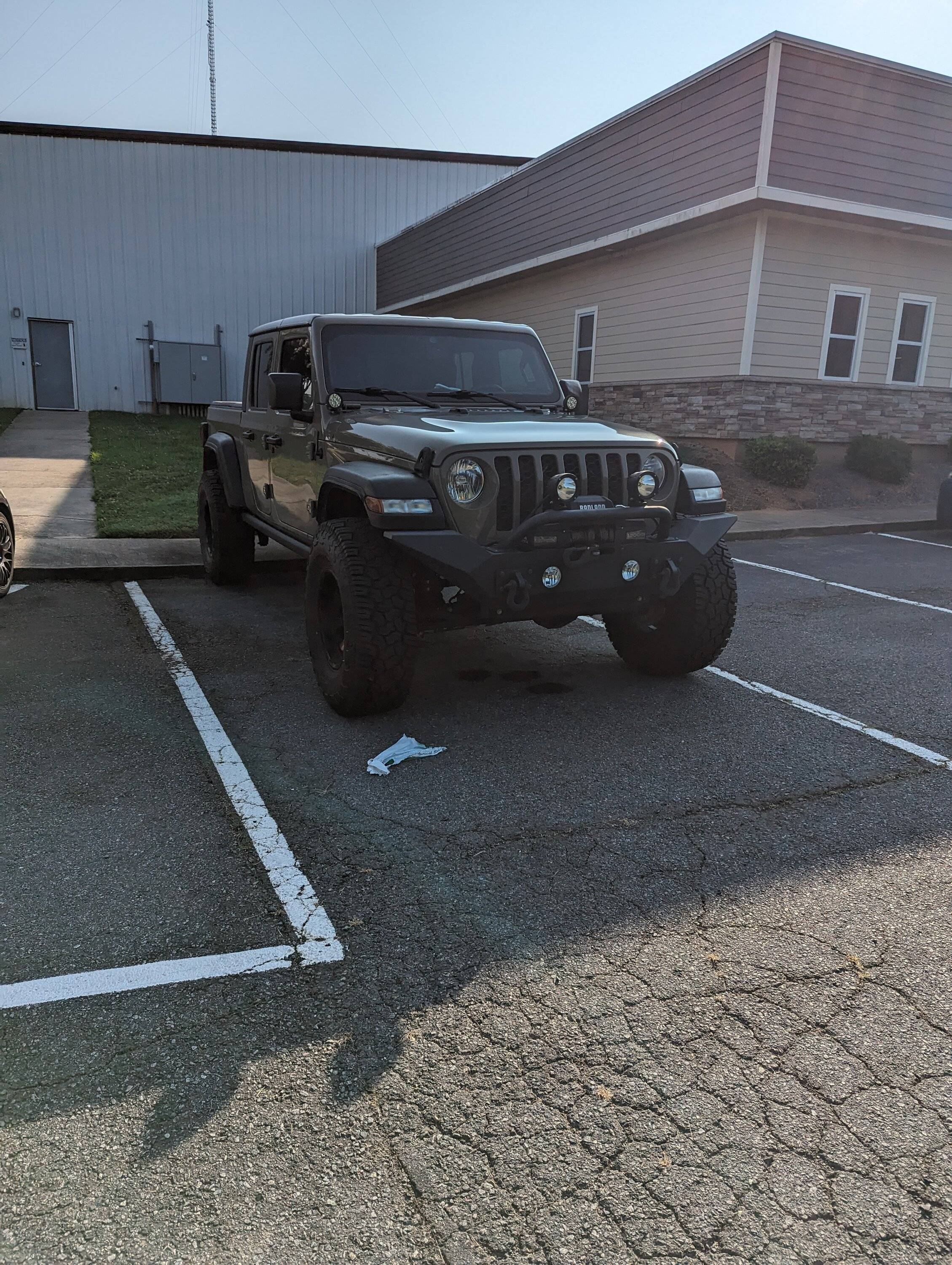

Here is video of mine this morning and a few pictures of it.
Jeep Gladiator Thinking about switching to 37s on my daily. Bad idea?? PXL_20230725_124727774
Jeep Gladiator Thinking about switching to 37s on my daily. Bad idea?? PXL_20230725_124735752
Jeep Gladiator Thinking about switching to 37s on my daily. Bad idea?? PXL_20230725_124747134
Jeep Gladiator Thinking about switching to 37s on my daily. Bad idea?? PXL_20230725_124755496
Jeep Gladiator Thinking about switching to 37s on my daily. Bad idea?? PXL_20230725_100916651
