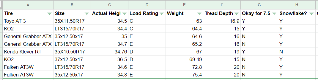

Stock Rubi wheels are ~23 lbs, and the "upgrade" black wheels (which should be the same as JLR stock wheels, but with different paint) are ~21 lbs.
https://www.jeepgladiatorforum.com/forum/threads/stock-rubicon-wheel-weights.17070/#post-315608
https://www.jlwranglerforums.com/forum/threads/rubicon-wheel-weight.3751/#post-388378
Here is my data from 35" AT tire shopping sorted by weight.
Jeep Gladiator Thoughts on Wheel and Tire weights 4.10's only 1611591383750
With the stock black Rubi wheels, and 35" Toyo ATIIIs, that puts my corner weights at 84lbs which I'm pretty happy with.
