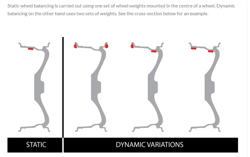

Huh? You wanted the wheels balanced, right?
You take off ALL existing weights - and start with no weights to balance. You don't leave any weights on. That's dynamic balancing - you can't leave them on.
Apparently you aren't familiar with balancing.
Why did you want them balanced to begin with - aren't they the stock new tires for the truck?
Anyway, taking off weights is normal. You start with no weights when balancing. Or did you not want them balanced?
It's contradictory to want wheels balanced but complain about weights being taken off.
