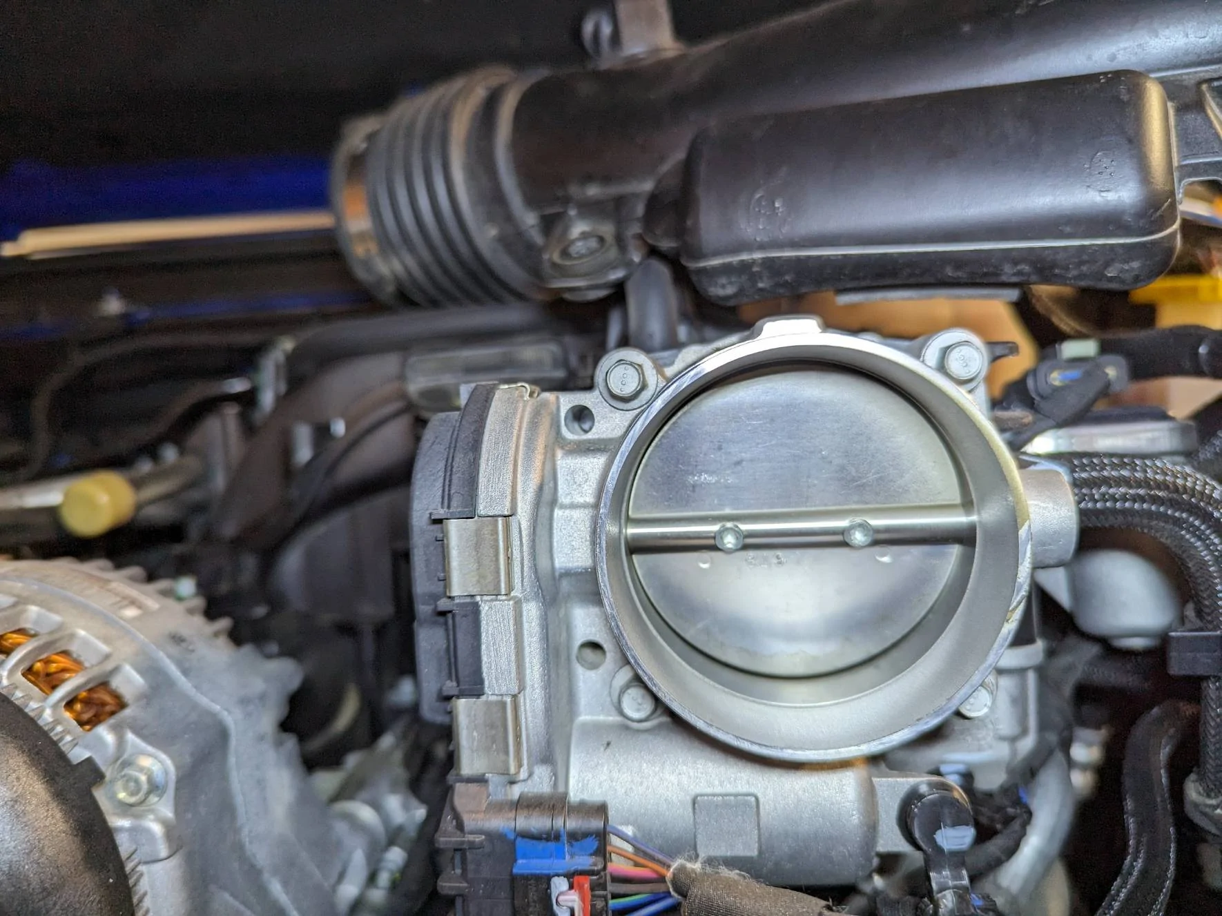

Ok, so a little UPDATE on this…I wanted to test my MUCAR CDE900 Pro, full Special Functions, and resets/relearn, FCA SGW unlock license diagnostic tool (that’s a mouth full) to do a throttle body relearn this morning so I started with unplugging the TB and took it off.
It was mildly dirty but that didn’t stop me from manipulating the butterfly plenty of times, sprayed TB cleaner on both sides and used a small paint brush to rub the cleaner around then put it all back together and plugged in the diagnostic tool to do the “TB relearn”.
After following its instructions and “hearing” the TB doing its thing, it said it was done and I went for a test drive. It definitely responds quicker and I was quite pleased with the performance.
