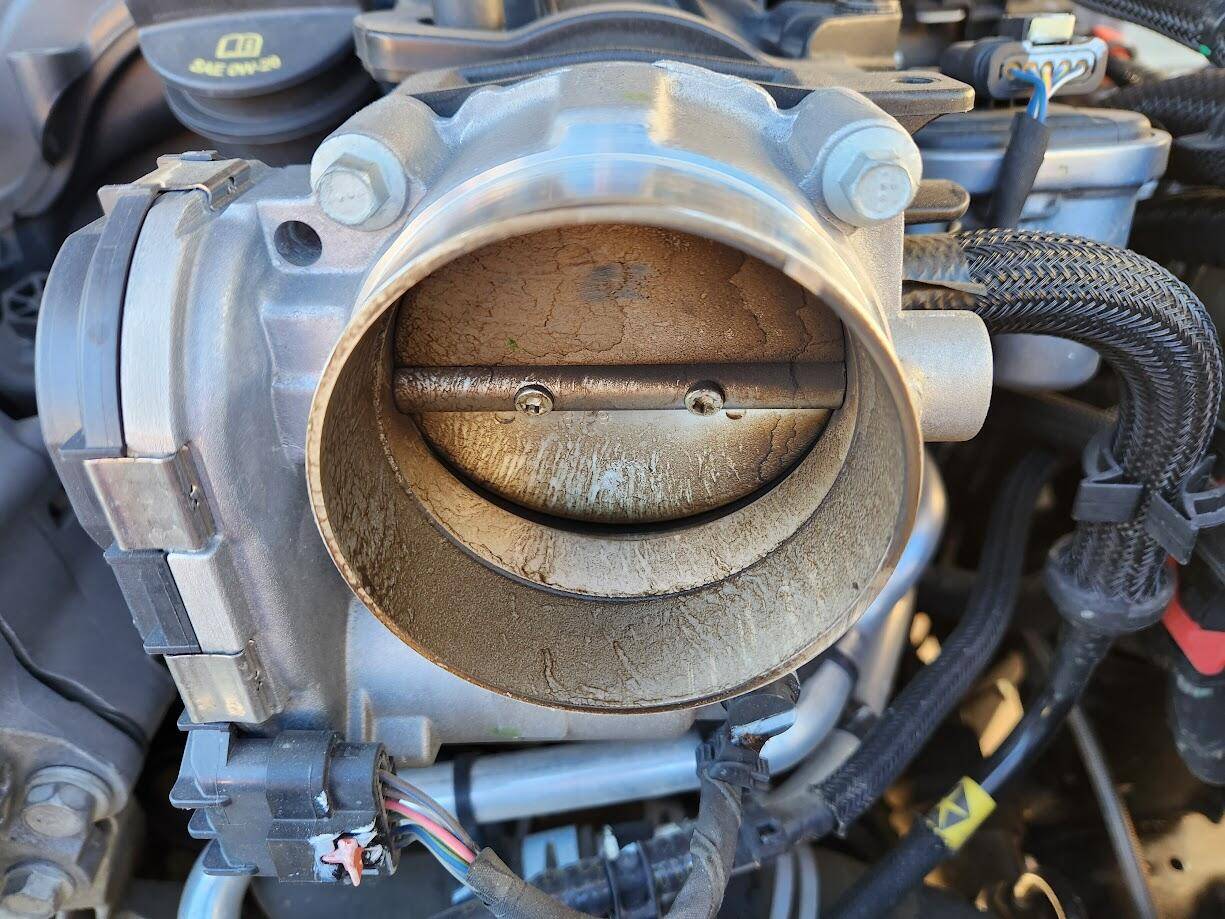

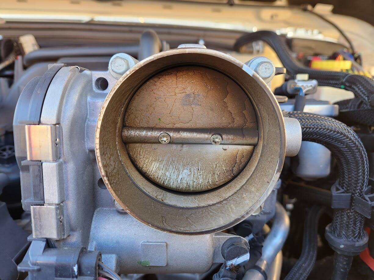

Bumping thread up... Well I decided to take a look at my TB since my truck is at 60K miles. It looks pretty bad IMO. Going to remove it and clean it off. Question, should I move the butterfly by hand to clean the edges? My assumption is NO due to the calibration of the TB itself and not recognizing the butterfly is in the correct position? I see a lot of conflicting YouTube videos on the topic and wanted to ask my Jeep folks here first. I'm leaning towards just a gentle scrub with it off and not moving the butterfly.
I am a data point of one, but I have done the throttle body cleaning twice now and all I did was just disconnect the electrical connector, gently opened the butterfly and did the cleaning I needed and gently closed it. Had no issues doing this or needing to do a throttle body relearn.

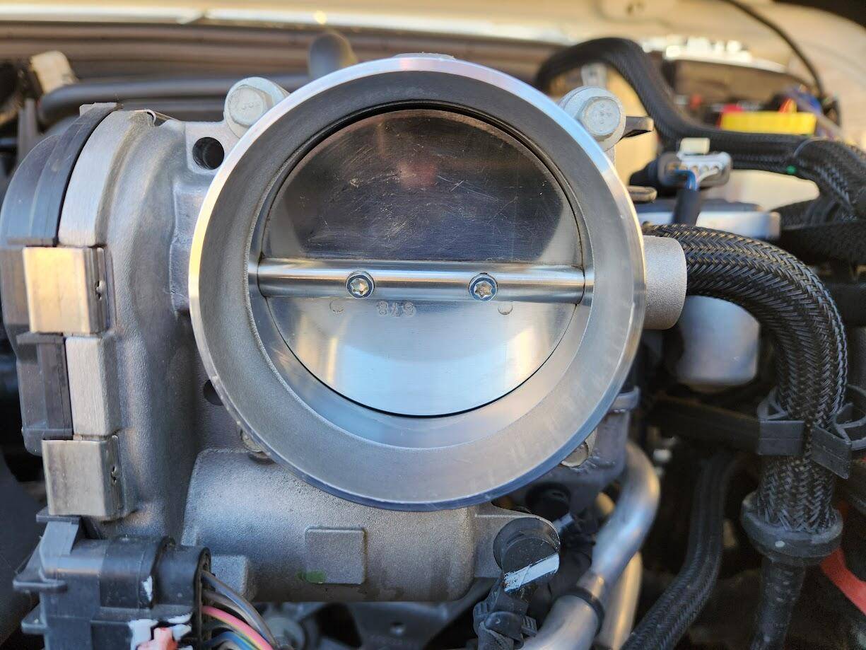

Well, I spent all of 10min cleaning time by taking it off with the (4) bolts, unclipping the connector and removing the push clip from the TB holding the wiring up neat. I personally did NOT move the butterfly and feel pleased with the results (both front and rear cleaned).
I didn't replace the green o-ring (gasket) despite my OCD really wanting to do the job 110%. It did look good to the naked eye and was not torn or too crushed. I might still run to the dealership and get a new one though if anything seems different on start up.
