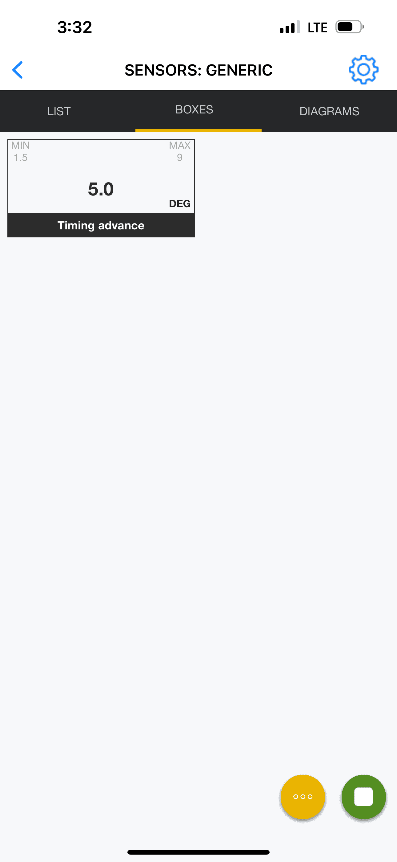

Is timing supposed to fluctuate at idle it’s mainly between 4.0 and 7.0 but my JScan said between 1.0 and 9.0
Jeep Gladiator Timing advance at idle IMG_3322

Short answer - sure, definitely.
I would think that it does fluctuate. Probably in accordance with the RPM... based on the engine temp. At initial startup, the RPM high and then slowly tapers down as the engine warms up, I would think this is accomplished by increasing the timing ???
The idle RPM changes - drops from a cold start but it's not because of timing, the idle speed changes based on the throttle position and fuel injected controlled by PCM - timing changes based on needs to completely burn the varying mixture.
I've seen mine as much as almost 2 degrees ATDC. Slower running engines require "later" or "slower" timing because there's more time to burn the mixture. So it can be ignited later and there's plenty of time to burn it.
More RPM, you need advanced timing to light the mix sooner to get it burned in a reduced amount of time due to the higher RPM.
Ideally, general rule of thumb is you ignite the mixture to ensure the highest combustion pressures between 14 and 16 degrees after TDC for maximum push on the crankshaft.
This will vary with stroke, rod length and so on, but that was the general rule of thumb for decades.

Thanks Papa
Looks like I was on the right track... atleast as far as higher RPM vs advanced timing... seems one is the result of the other, just two different systems controling it separately.
I appreciate the detailed response/information.
