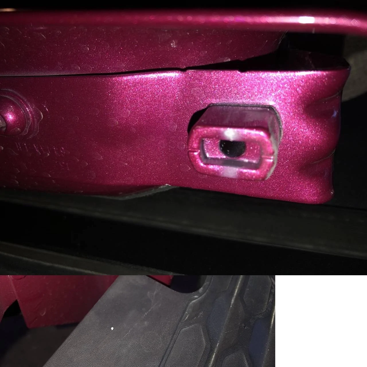

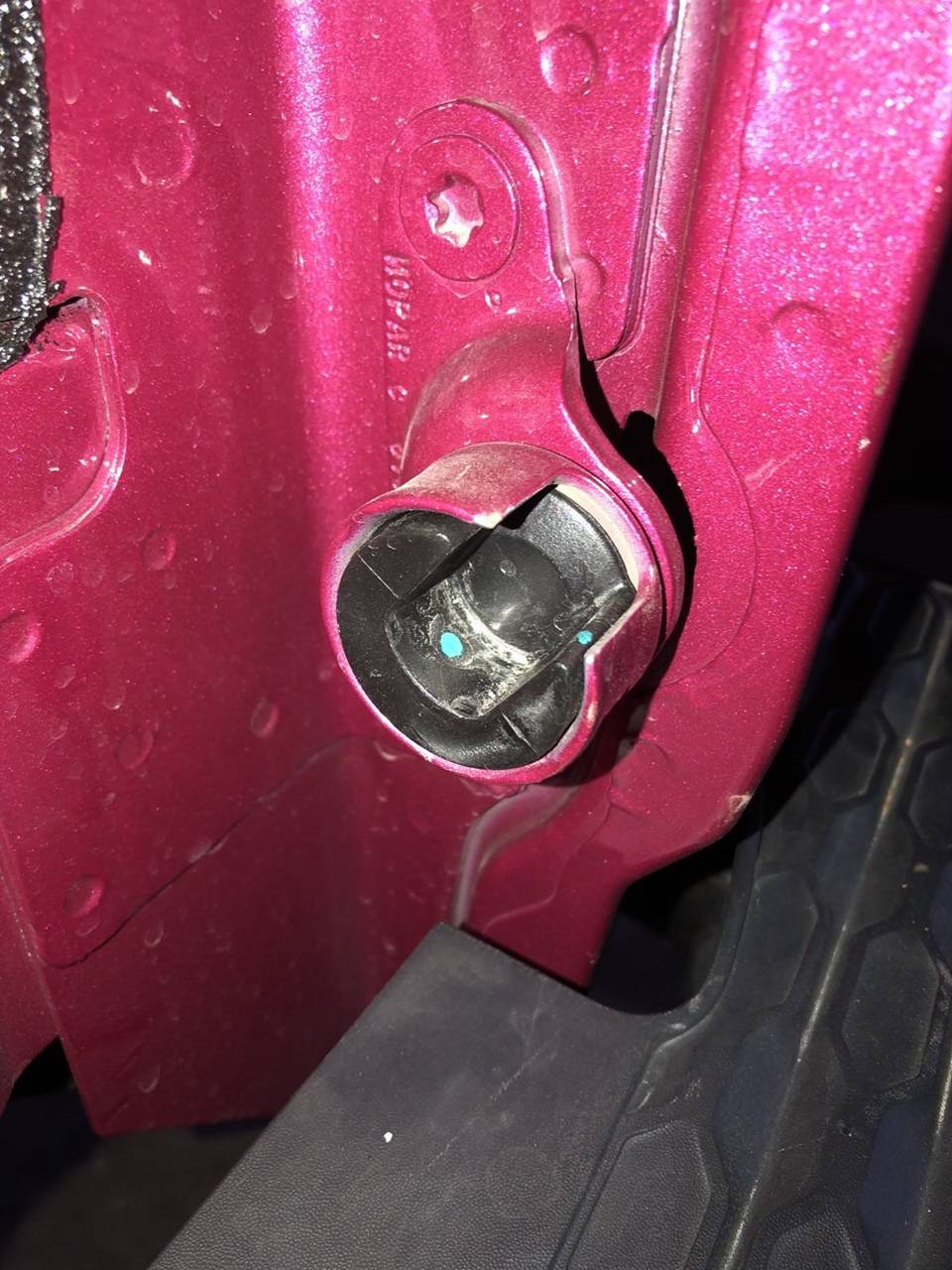

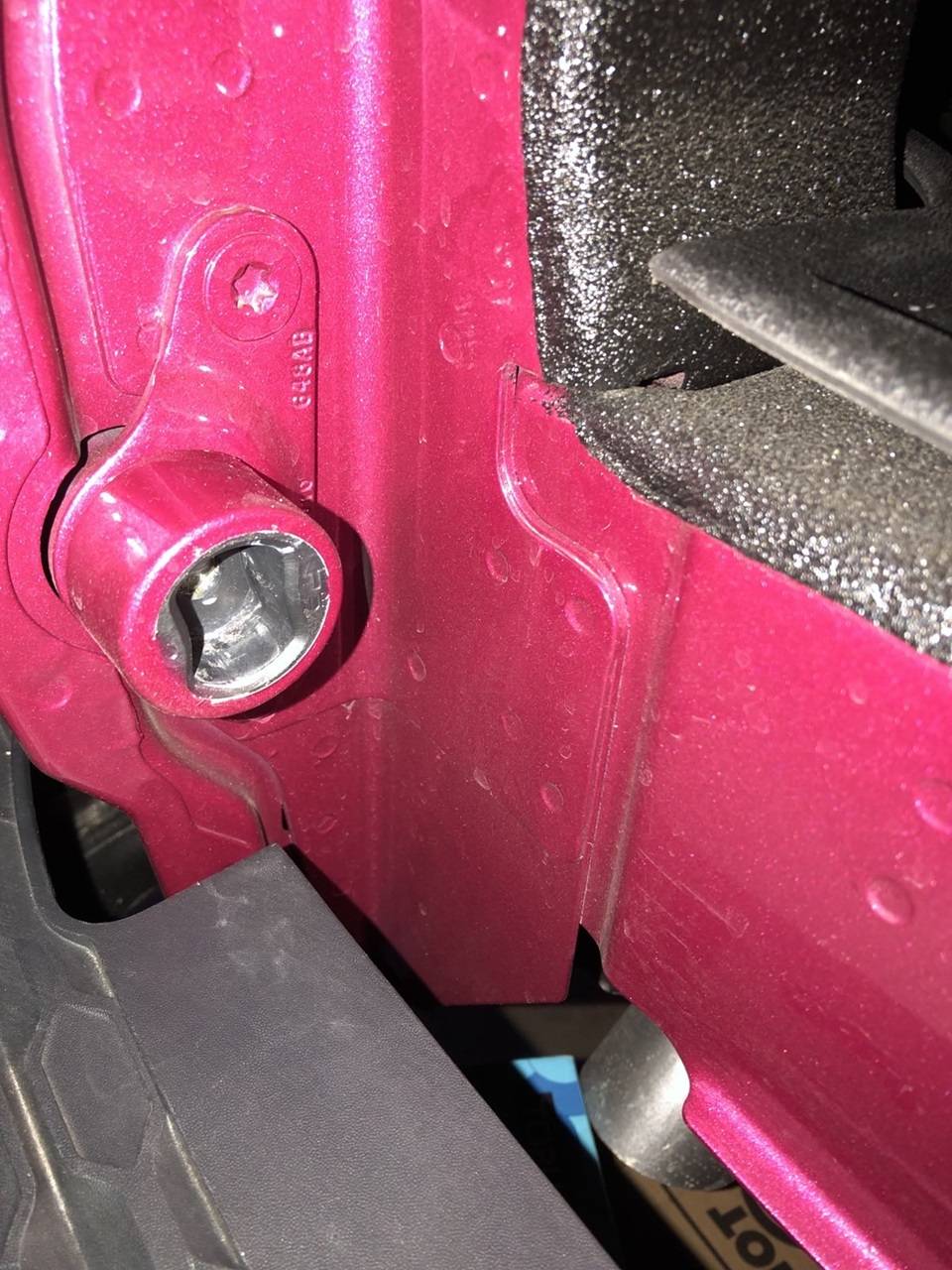

For soft open tailgates, in addition to first disconnecting the tailgate brake light and the camera (if equipped) wire connectors (center bottom), and disconnecting (Torx 45) the two tailgte check cables, you need to tilt the tailgate open ~45 degrees until the flats of passenger side post are aligned with right side post socket slot and then pull it up/out. Note - the driver's side post is also has flats like the passenger side, HOWEVER if your JT has the soft open feature, you need to return the tailgate to straight up position, to then pull the post out of the driver's side soft close socket --- trying to pull it out of the driver's side post at either the mid open or full open position will not work, because the soft open mechanism is creating a huge amount of torsional friction on the post, so even if you hit the tailgate with a big dead blow hammer to dislodge the post - the tailgate needs to be vertical to release the tortional forces on the driver's side flat post.

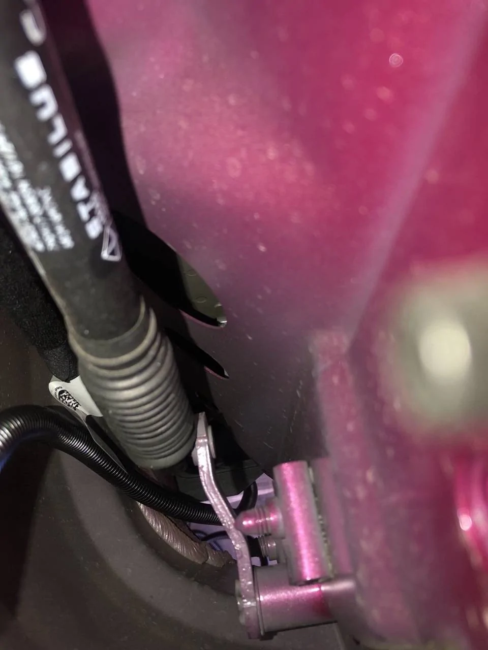

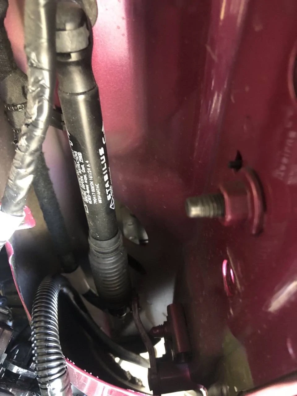

While installing a towed vehicle (the '24 JTRX) wiring kit and removing the taillight modules to connect wiring, took these photos of the soft-open gas strut, and lower linkage connected to the backside of the driver's side tailgate pivot socket, located in the driver's side taillight well.
👉 Am wondering if these soft-open mechanisms are on/in all JT models/years, or only certain packages/years. Located no other posts on the forum about these mechanisms, which is why I posted the above tip on removing/re-installing a soft-open tailgate.
