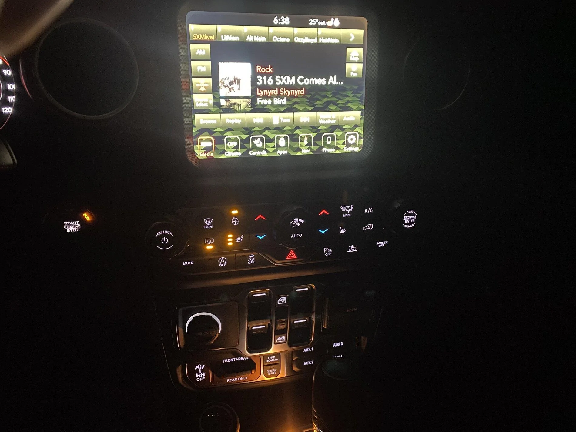

Remote starting my JT in the cold doesn't illuminate the front defroster button, but it's definitely blowing air out of the front defroster. I think it's an auto setting that, while it's in remote start mode (i.e. the start button hasn't been pressed), it's blowing out of the front defroster, but when the start button is pressed, it reverts back to your previous HVAC settings.

Mine isn’t blowing hardly any air on the windshield. It’s nearly all coming out the side vents. Maybe it’s the way FCA designed it to work, but if they did, it was a poor choice. My windshield isn’t getting thawed out like it did in the Wrangler I traded in on my Gladiator.
