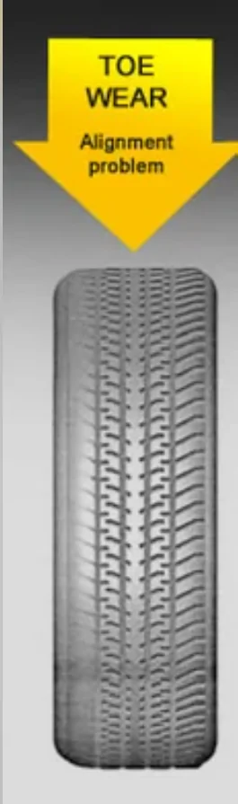

Toe wear -
Running your hand across the face of the tire, it will feel smooth going one way, and you'll feel a feathered or saw tooth effect going the other way - not smooth feeling. Like petting the fur on your dog's back easy one way, ruffled the other way.
Jeep Gladiator Tire imbalance or death wobble? 1757266475911-ni
Also typically the outer ring of tread will be more worn than the rest. (that below looks like a pretty severe case to me)
