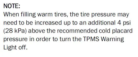

'21 Mojave here as well.
1. 37 on the stock Falkens is stupid. Not you stupid. Jeep stupid. Try 33-35
2. On the gen 2 TPMS, which you likely have, you will need to EXCEED the placard inflation number by 4 PSI or more to clear the warning light.
3. You can adjust the warning PSI to whatever you want it to be using any one of a number ODB tools.
I used ECRI, which doesn't do as many things as the Tazer, but it also only costs about $100.
