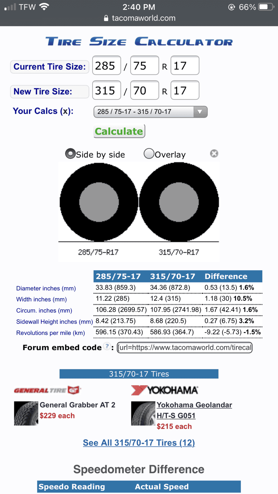

Here’s two other tire sizes that are pretty popular on here and may do a little better on fuel economy.
