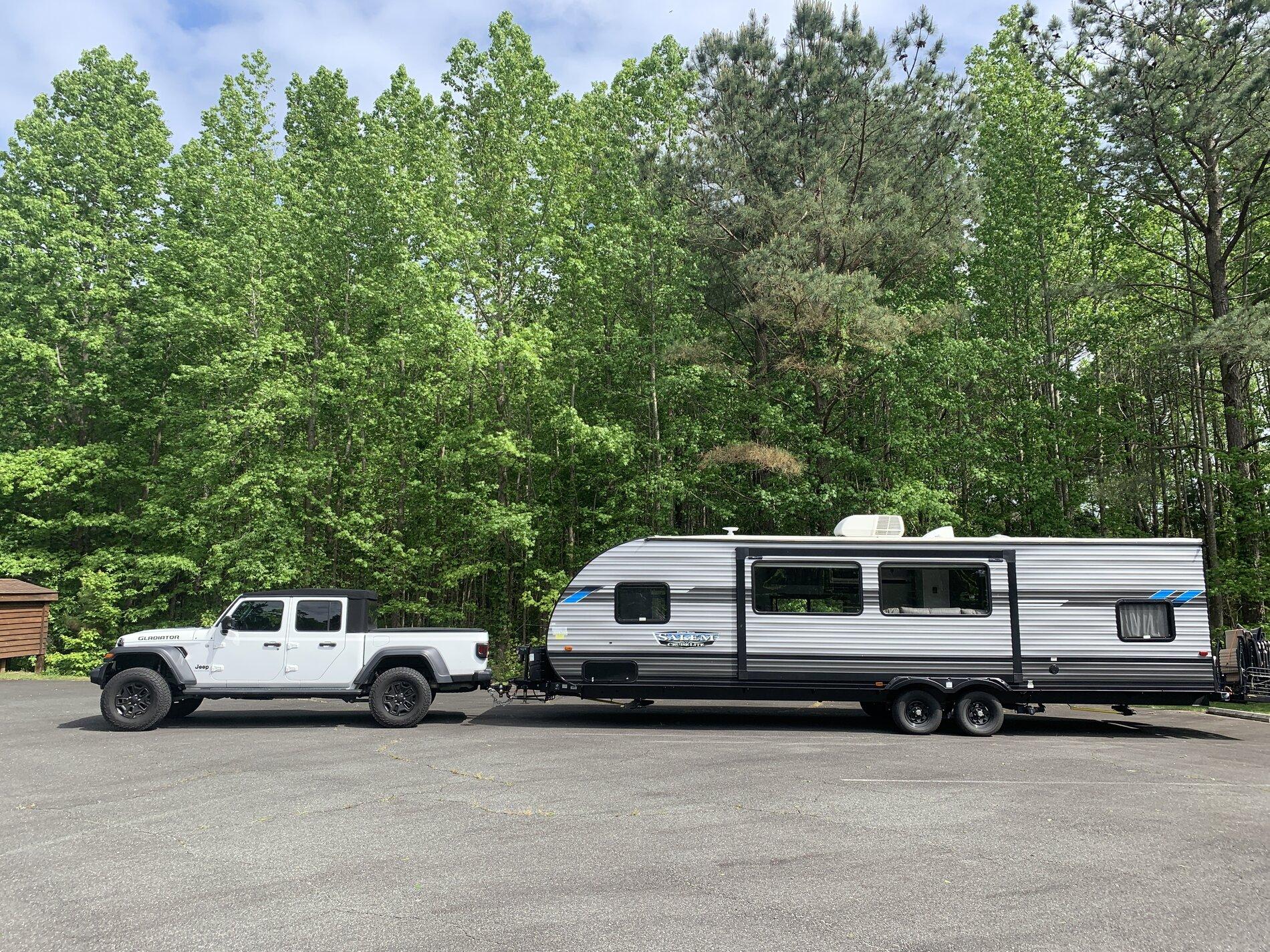

You’ll be perfectly fine as long as your WDH and brake controller are set up correctly. Your diesel will pull far better that my gaser, and this is what I pull (6800 lbs loaded):
Jeep Gladiator Towing with Mopar 2" lift or wait? 3BB1EB63-A155-4822-8C25-65A9ECF4CBA6
I have a max tow w 285/75r17s and a 2” spacer lift with rubicon shocks and front springs. I don’t drive over 60, usually stay at 55 (tire rating) and have mirror extensions and rear view camera (a must).
edit: is yours a dual axel? If only single I heard they can get sketchy close to 4k, whereas the dual axel trailers tend to be more stable and track straighter. Many say to go with the 4.5-5k lb trailer because you get the dual axels...
