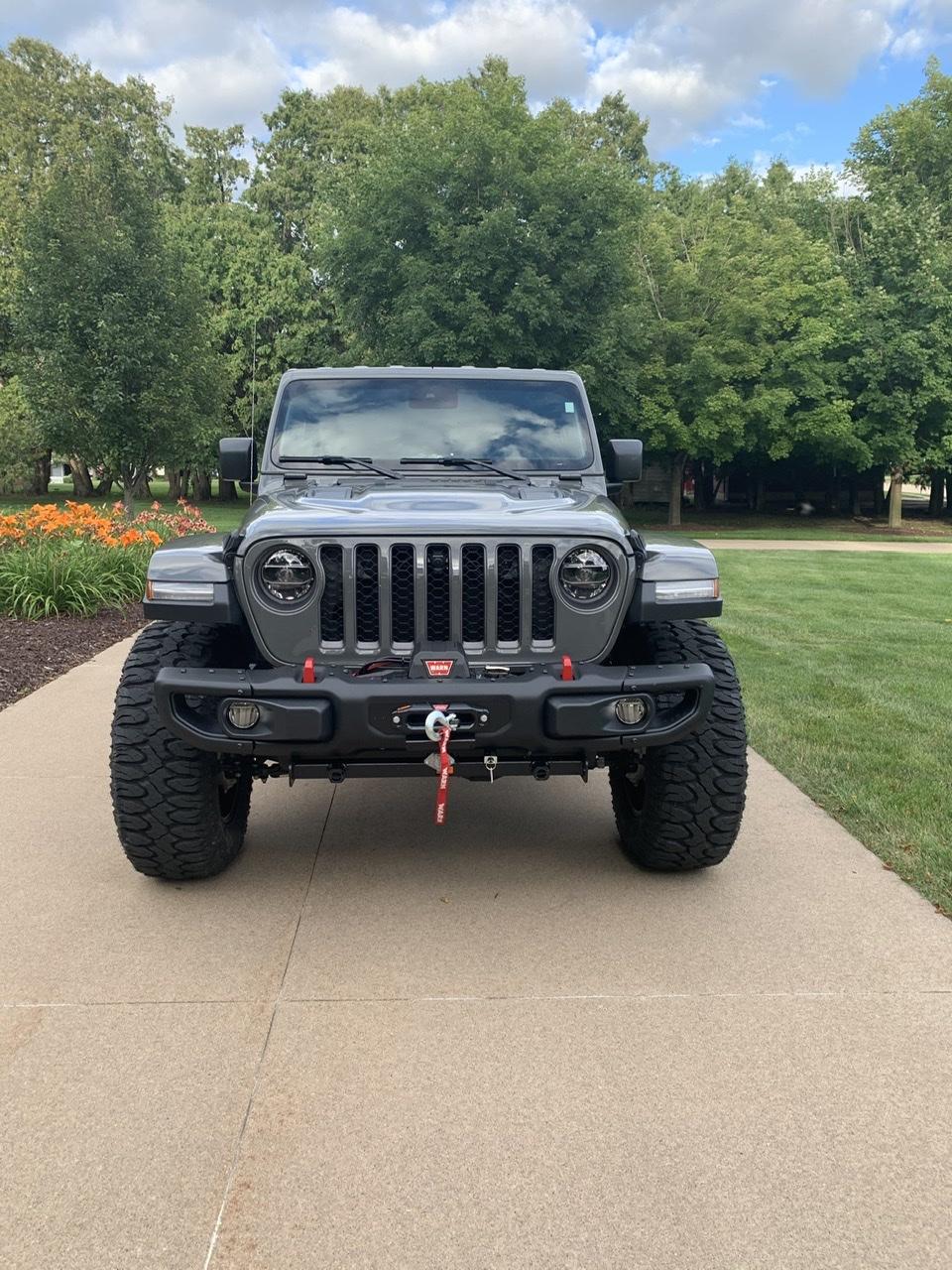

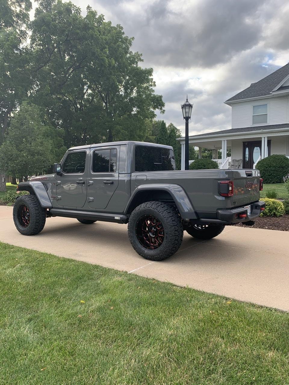

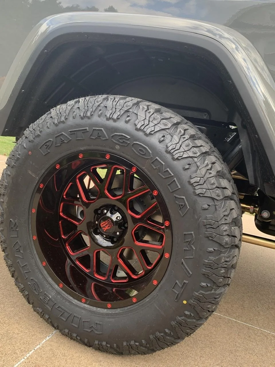

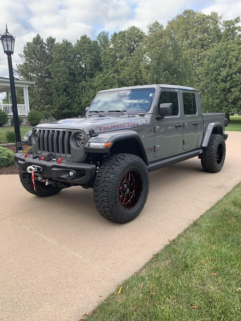

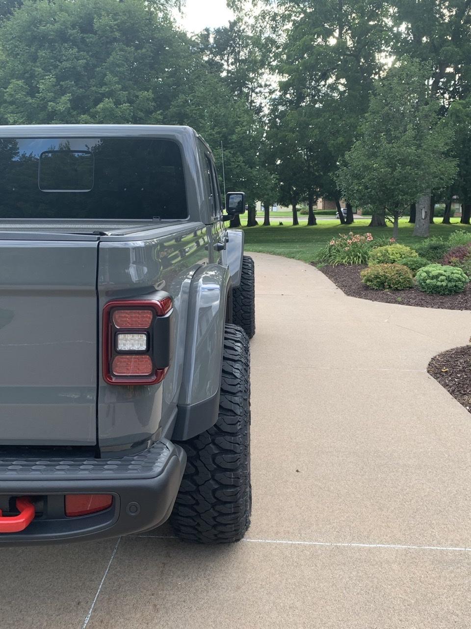

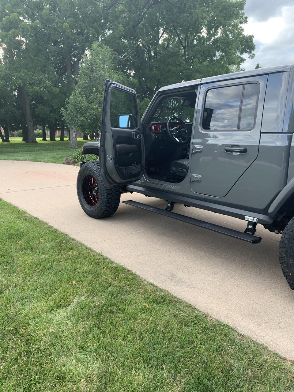

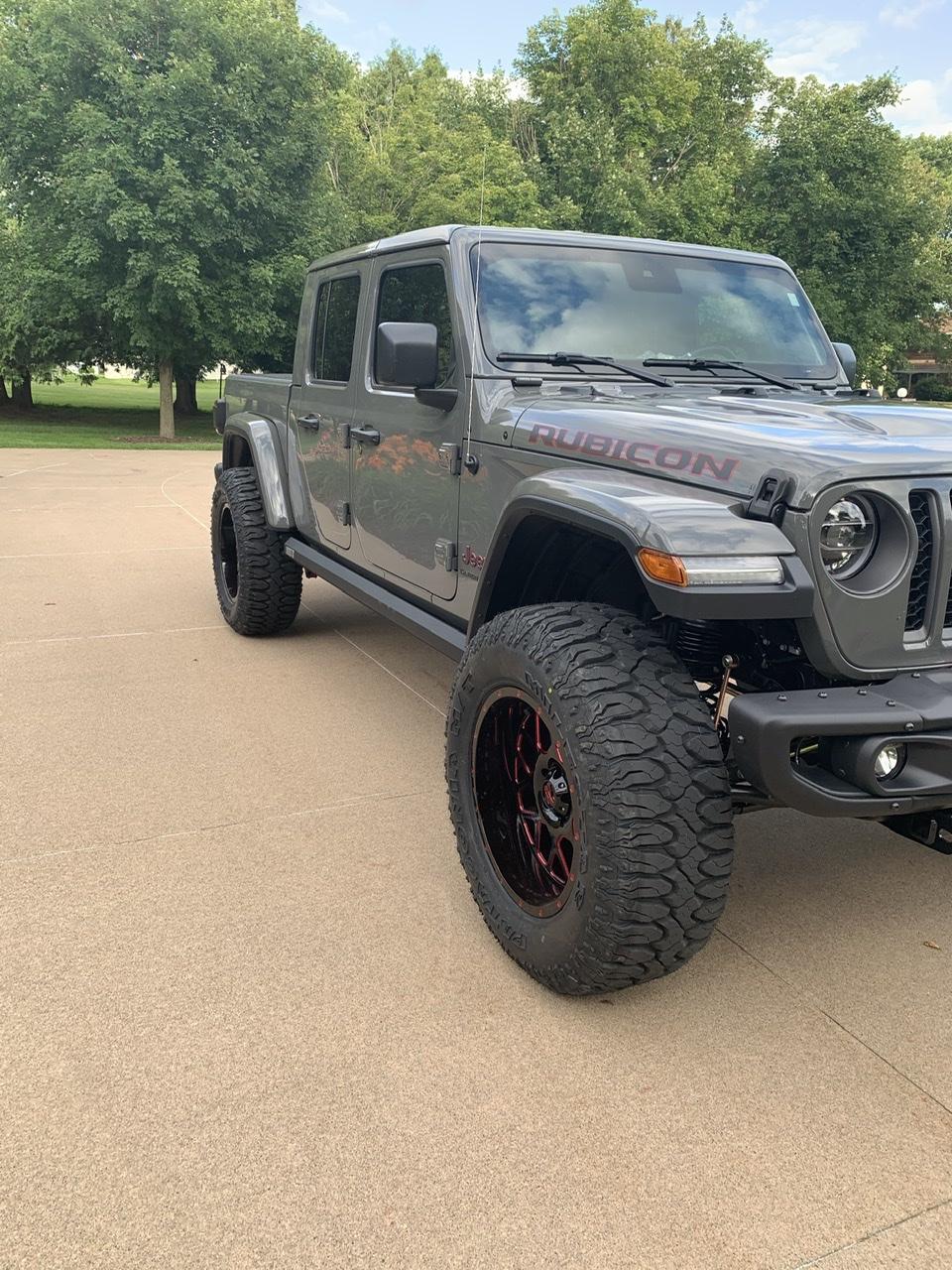

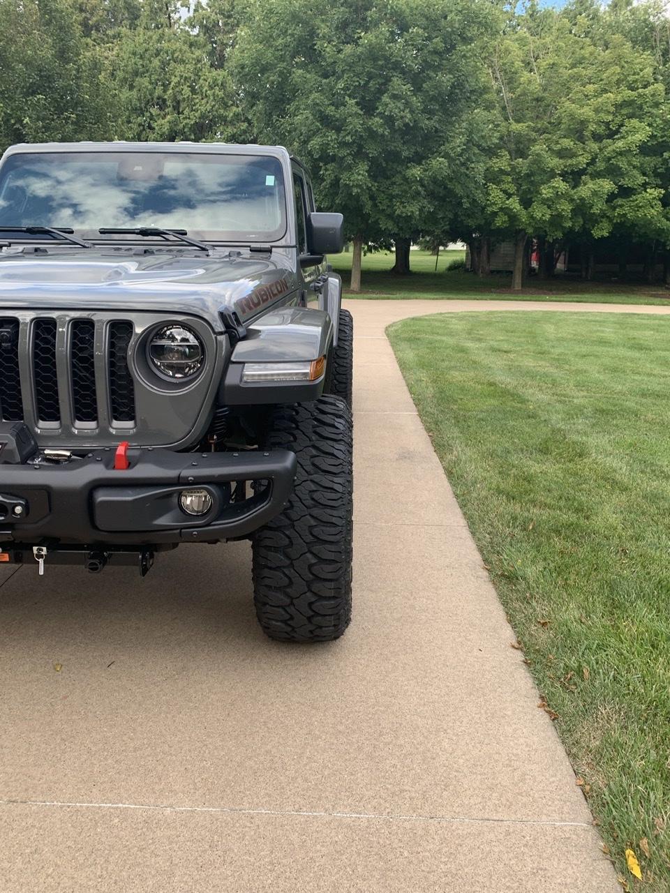

Finally got most of the work done, including :
- MetalCloak 3.5" Game Changer lift with
Rock Sport shocks
- 20x10 XD Grenade Wheels with -24 offset
- 37/13.50R20 Milestar Patagonia MT Tires
- Amp Research XL Power Steps
- Warn VR12-S Winch
- Quake Rock Lights (8) with Bluetooth
control
Also had to purchase Superchips Traildash2 Programer to adjust speedometer for new tires.

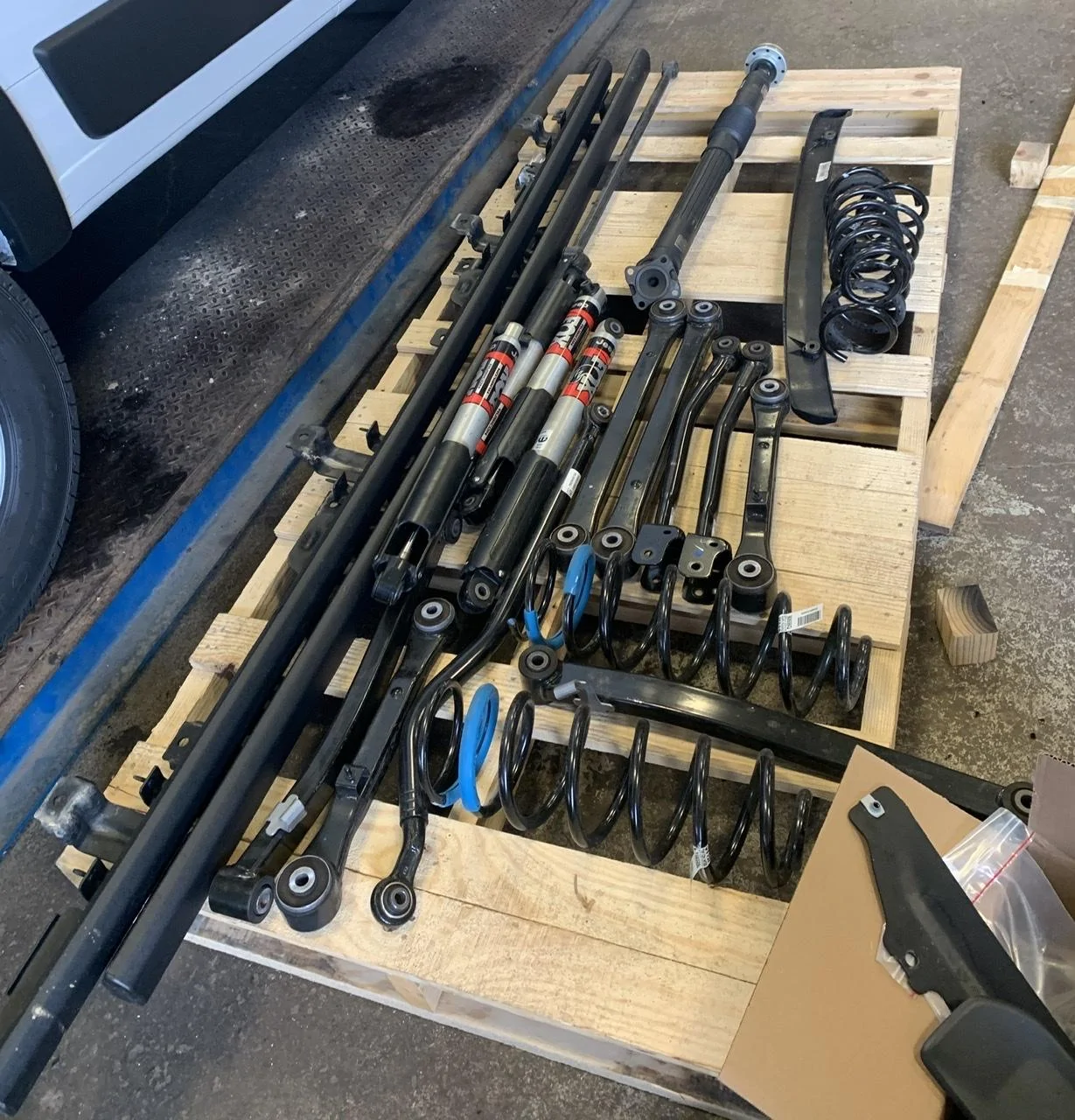

Provided a few pics of the setup below. Also one of all the extra parts (plus tires and rims. not shown) that I need to get rid of!
Next up is probably the KC light bar. It’s going to be pretty close getting into the garage ... one more measurement before giving the go ahead!

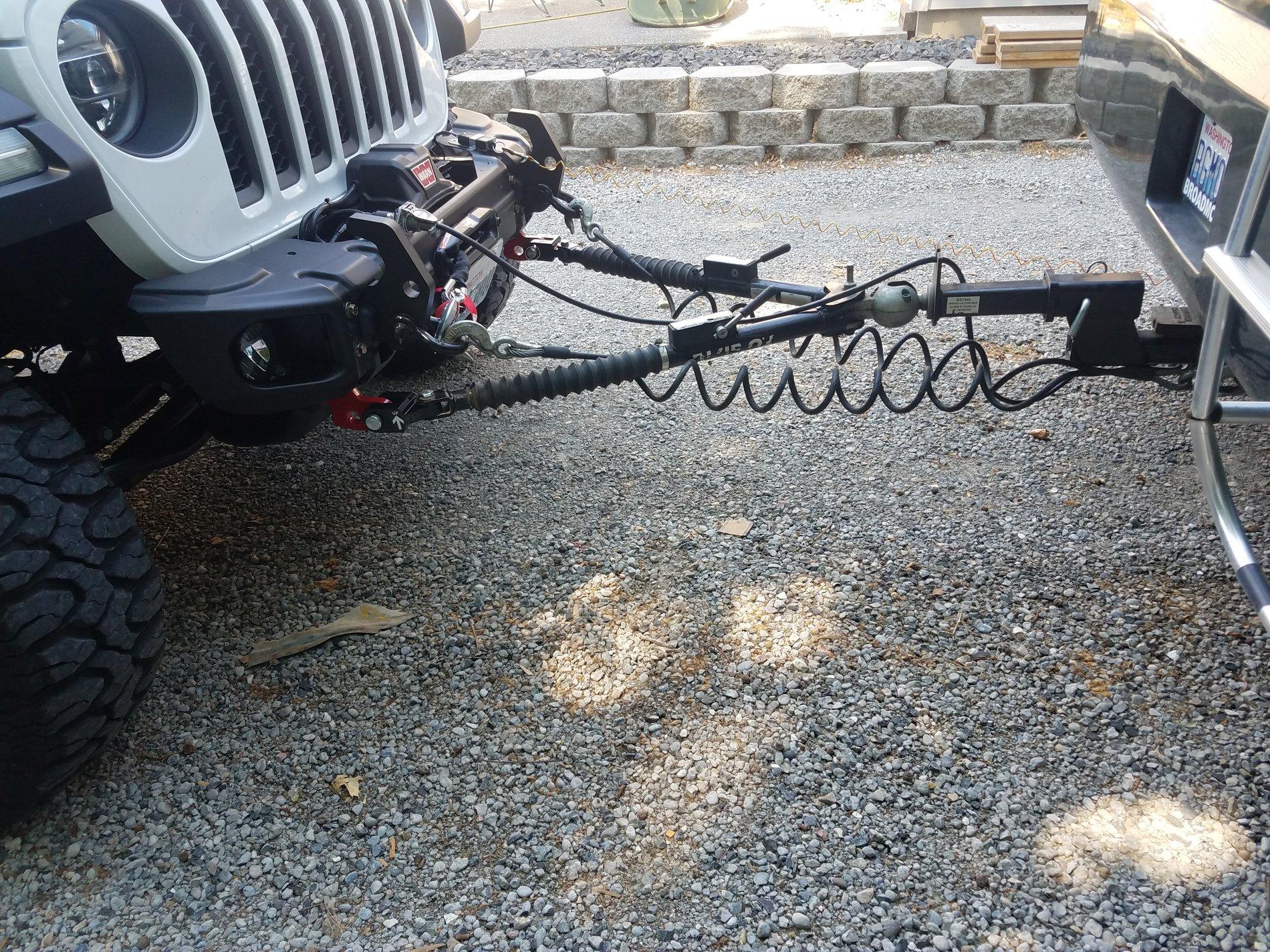

First flat tow went perfectly. Only a 1.5" lift and 35's. Seemed to tow better/straighter than the 2 door JK. Maybe the extra length helps?
I did notice a little slop in the "ball" thingy on my old Aventa LX tow bar. Blue Ox discontinued this design years ago, and I don't want to be another reason why. New Avail tow bar ordered. The new one has a little longer arms.
