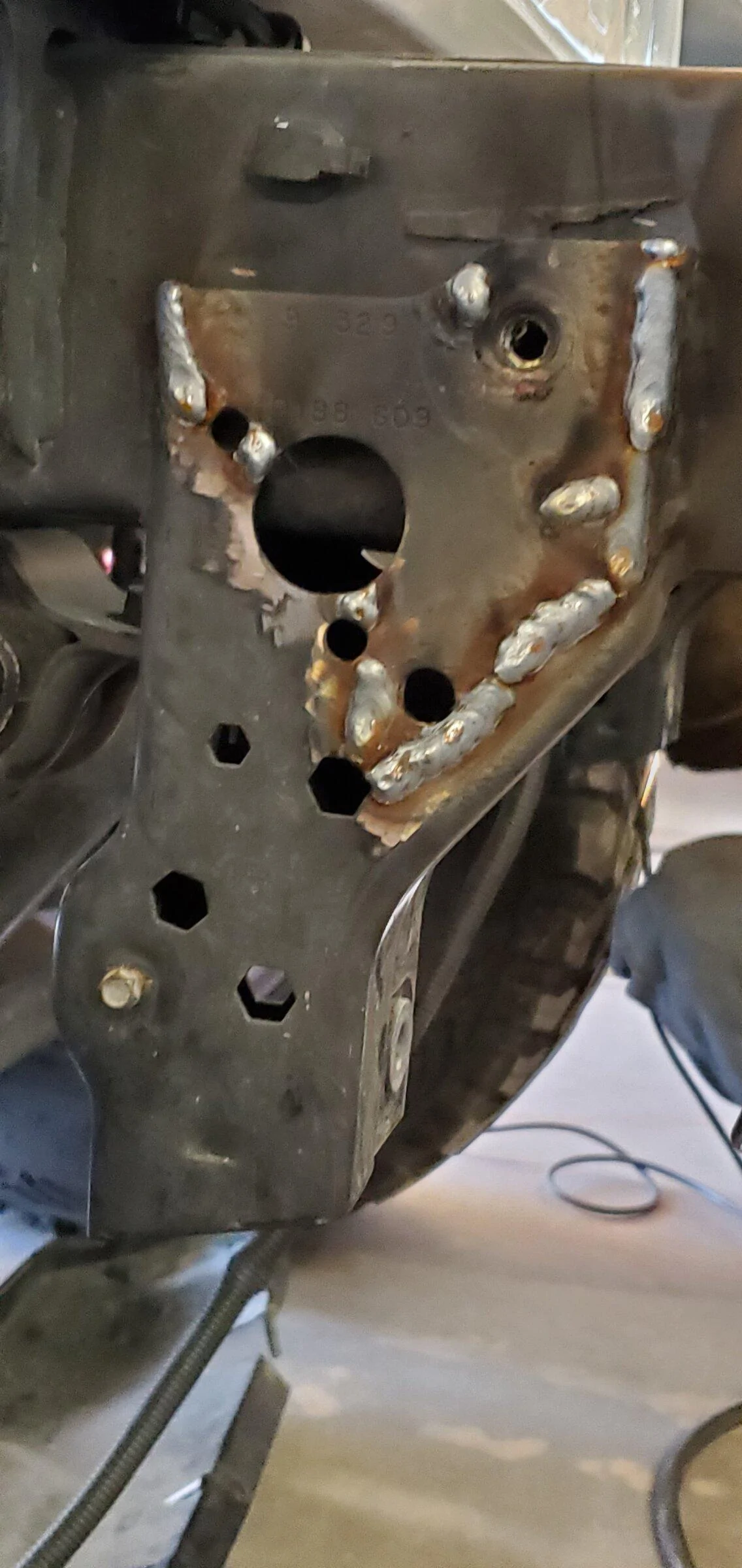

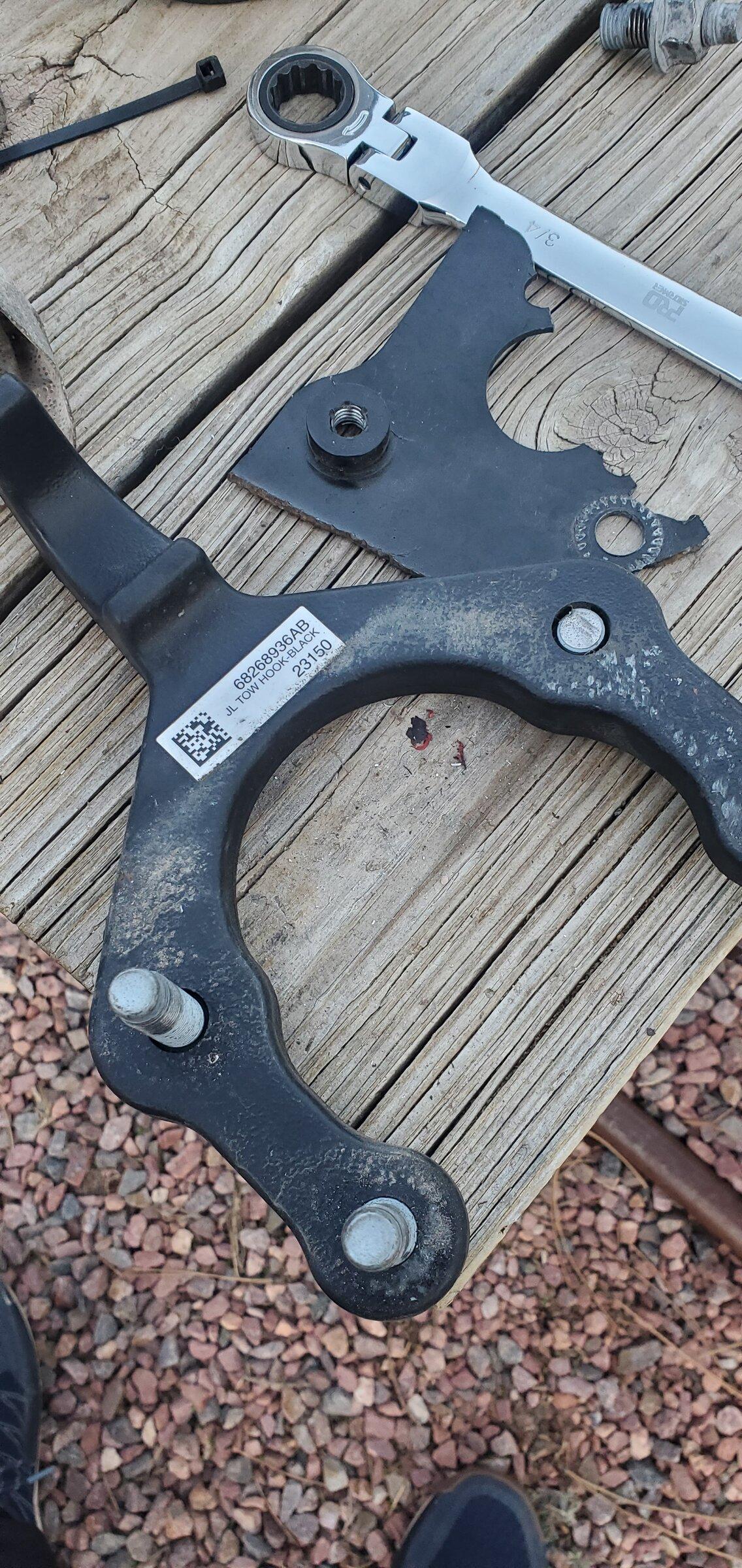

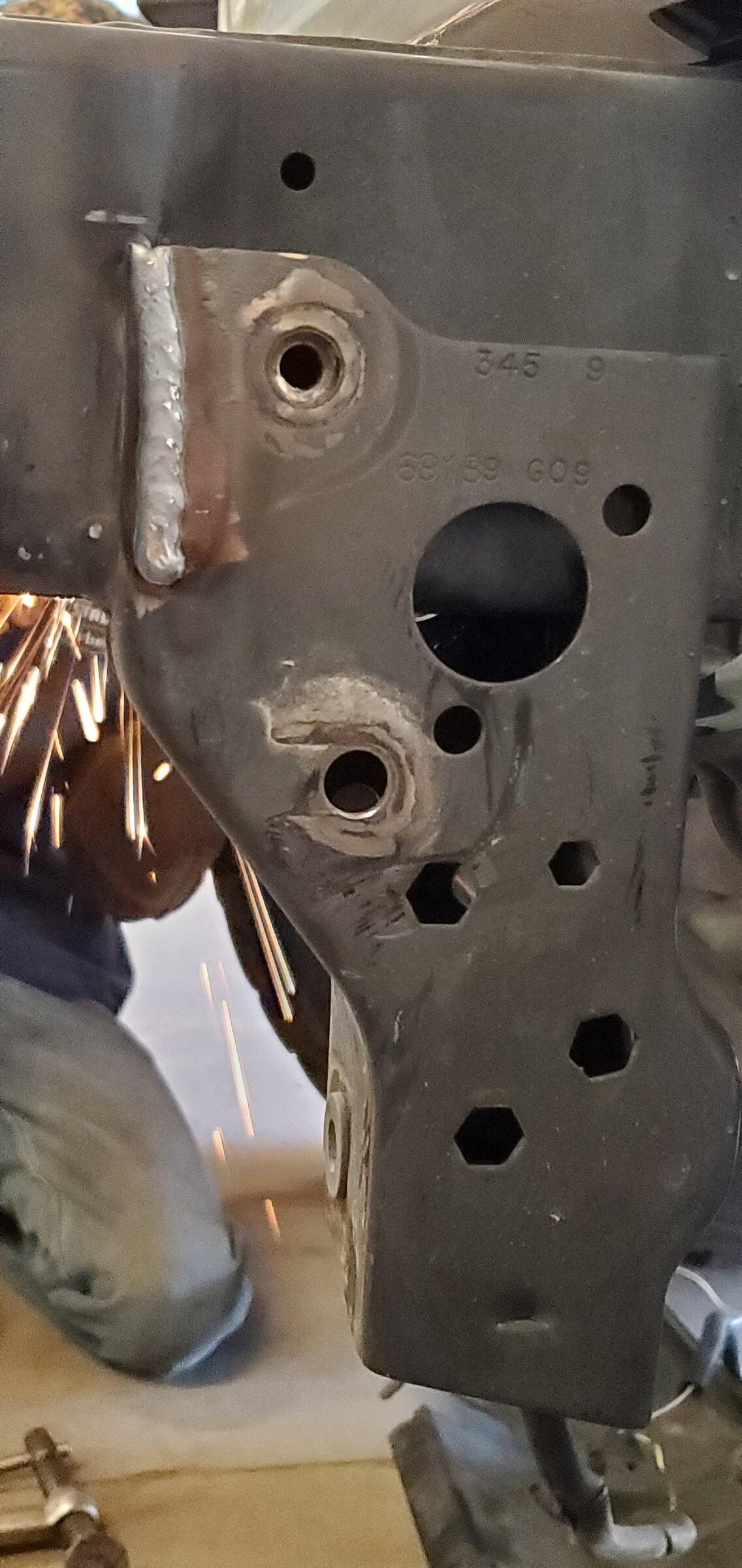

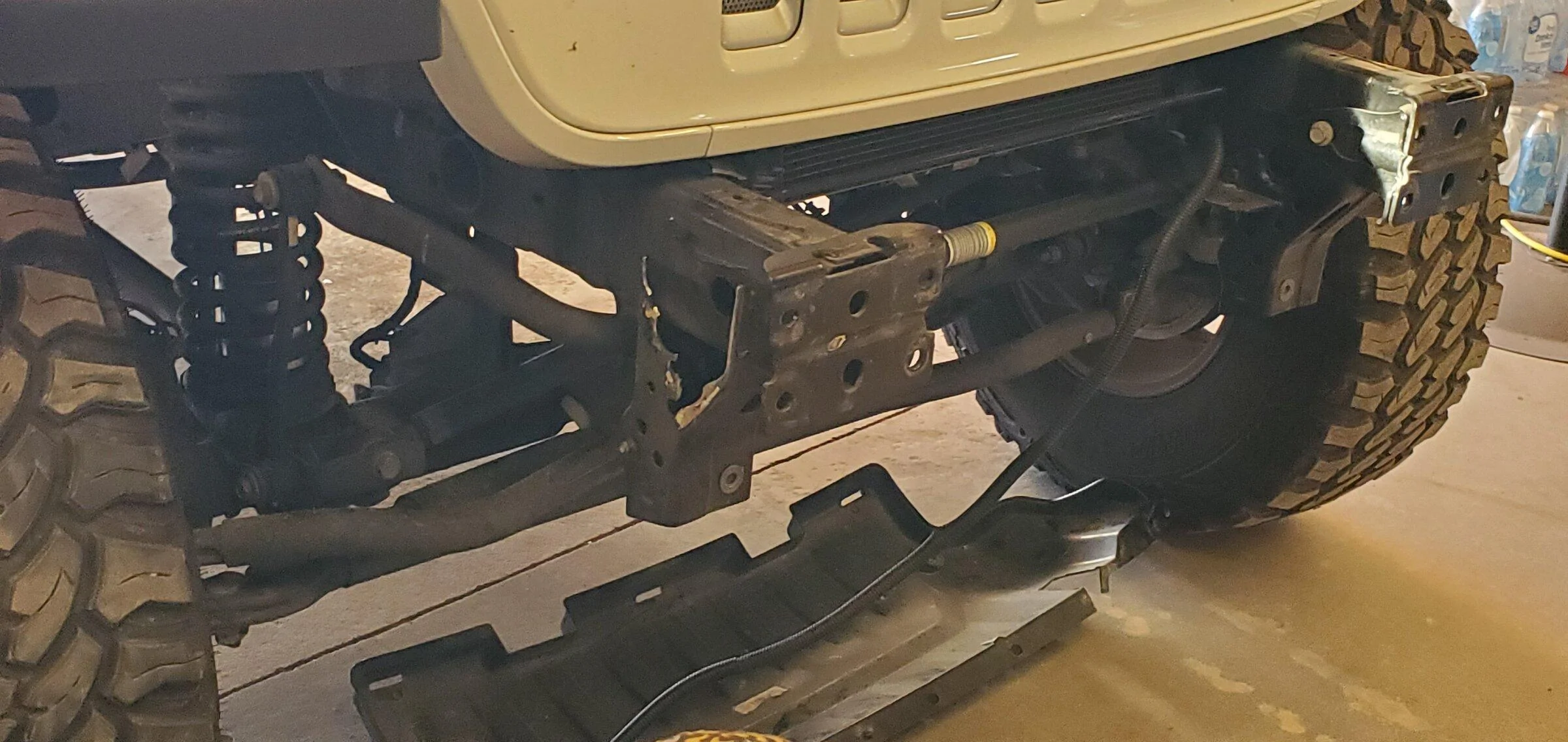

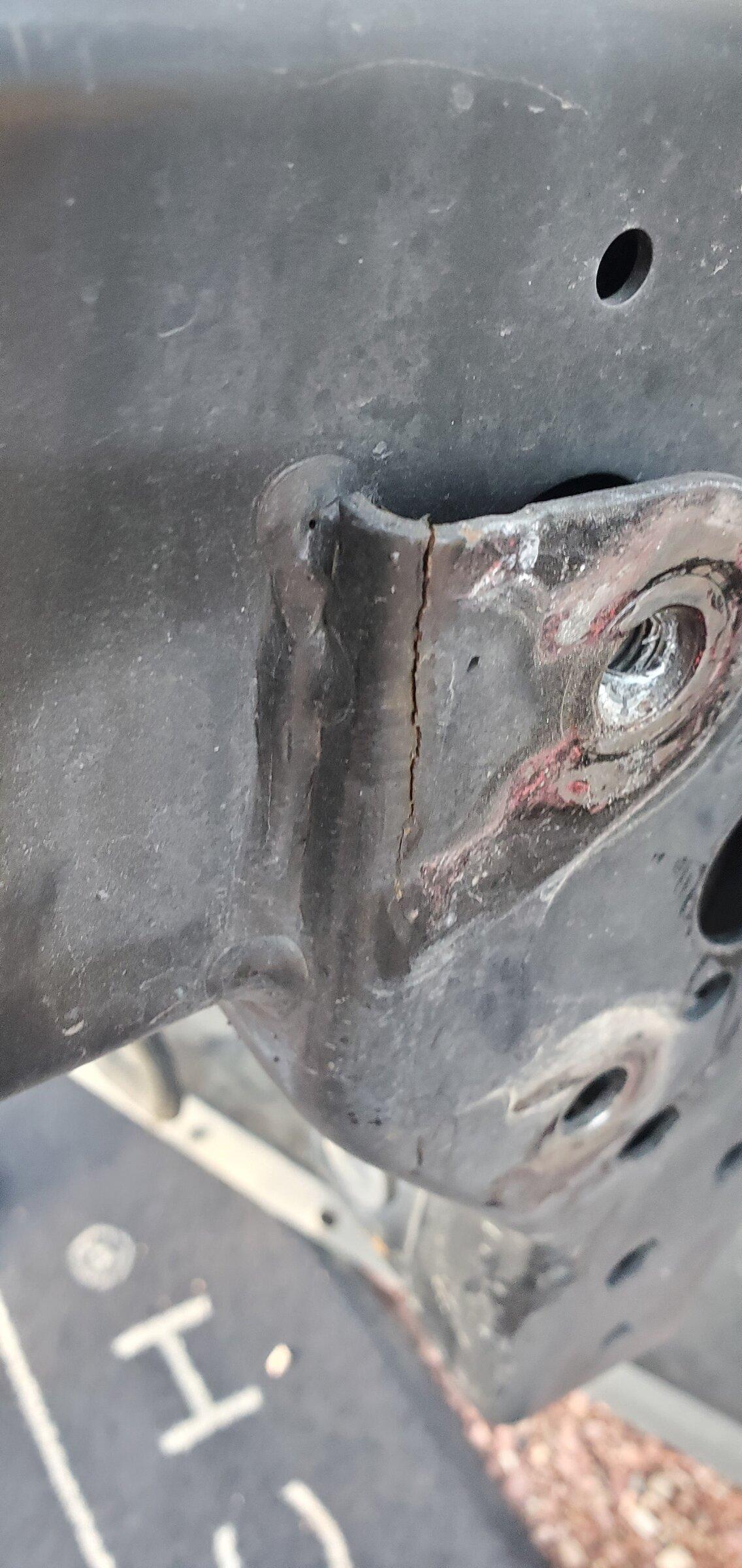

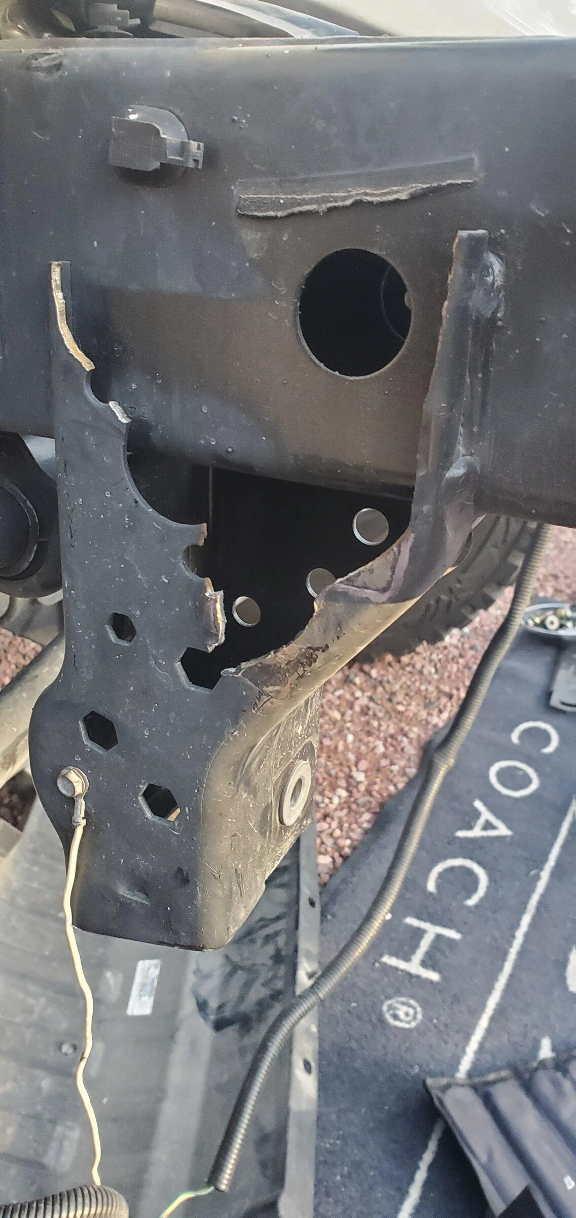

I am gonna ditch the tow loops and go to a DEMCO base plate. We full time and can't be worried about this happening again. The TOW loops are $$$ to have this issue.
Your pictures above are frightening. I am now going to be staring at my camera and mirrors as much as my windshield. I am not very happy. The reason I went with the loops was due to my winch and the lower tow bar mounts for my lifted Jeep.
Time to look for an alternative. ☹

That what I would do constantly looking back , and every few hours would check the stability of the loops , for a while the bolts kept coming loose , I would locktite and still would come loose some how ..
i had to add lock washers. . .I just think to much force is added when you break pushing outward causing the issue..the lenght between the tow loops is 35 inches vs all the base plates roughly between 19 to 24 inches. I always felt that maybe the tow loops needed to be installed on the inside of frame not outside to minimize the distance. It was always an issue hitching up if I was off a bit due to the wide gap between the loops
