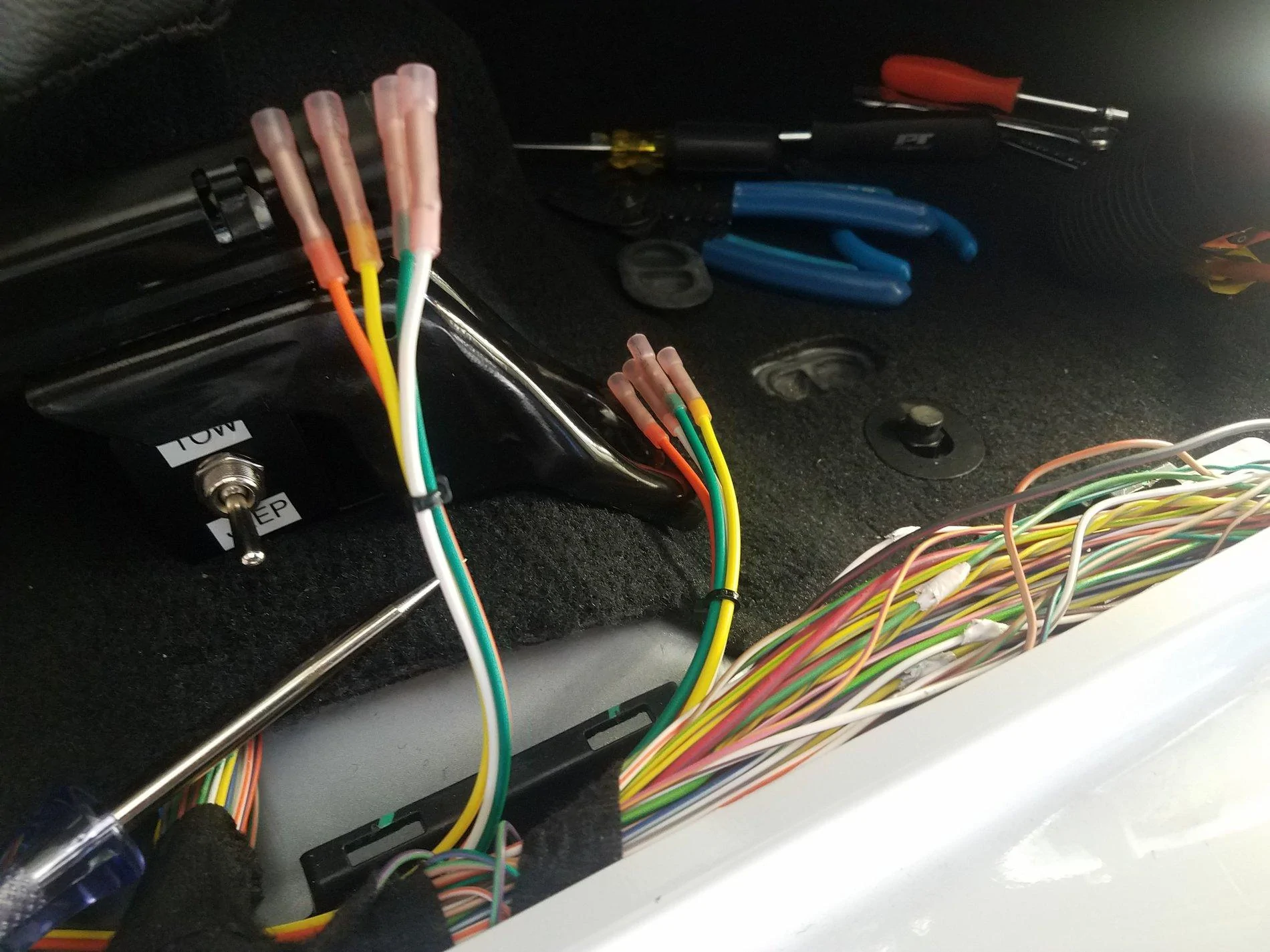

Make sure you follow the supplied directions EXACTLY. Remove the two fuses, if you have the trailer tow package. Do your tests after cutting each wire, before connecting to the harness. I found and cut the correct 4 wires the first time when I did mine. A couple friends had the wrong wire. Cooltech gives you extra butt connectors just in case this happens. It is a bit nerve wracking cutting wires in that bundle in a brand new $50K Jeep.
It's a big bundle of wires, and some of them look the same, especially for my old eyeballs. Very slight differences in colors and stripes.
Jeep Gladiator Flat towing JTR with 37" tires cooltech 1

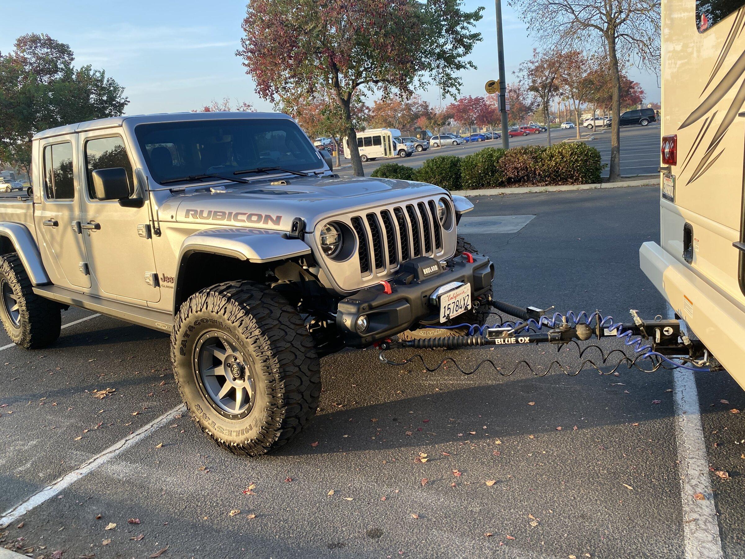

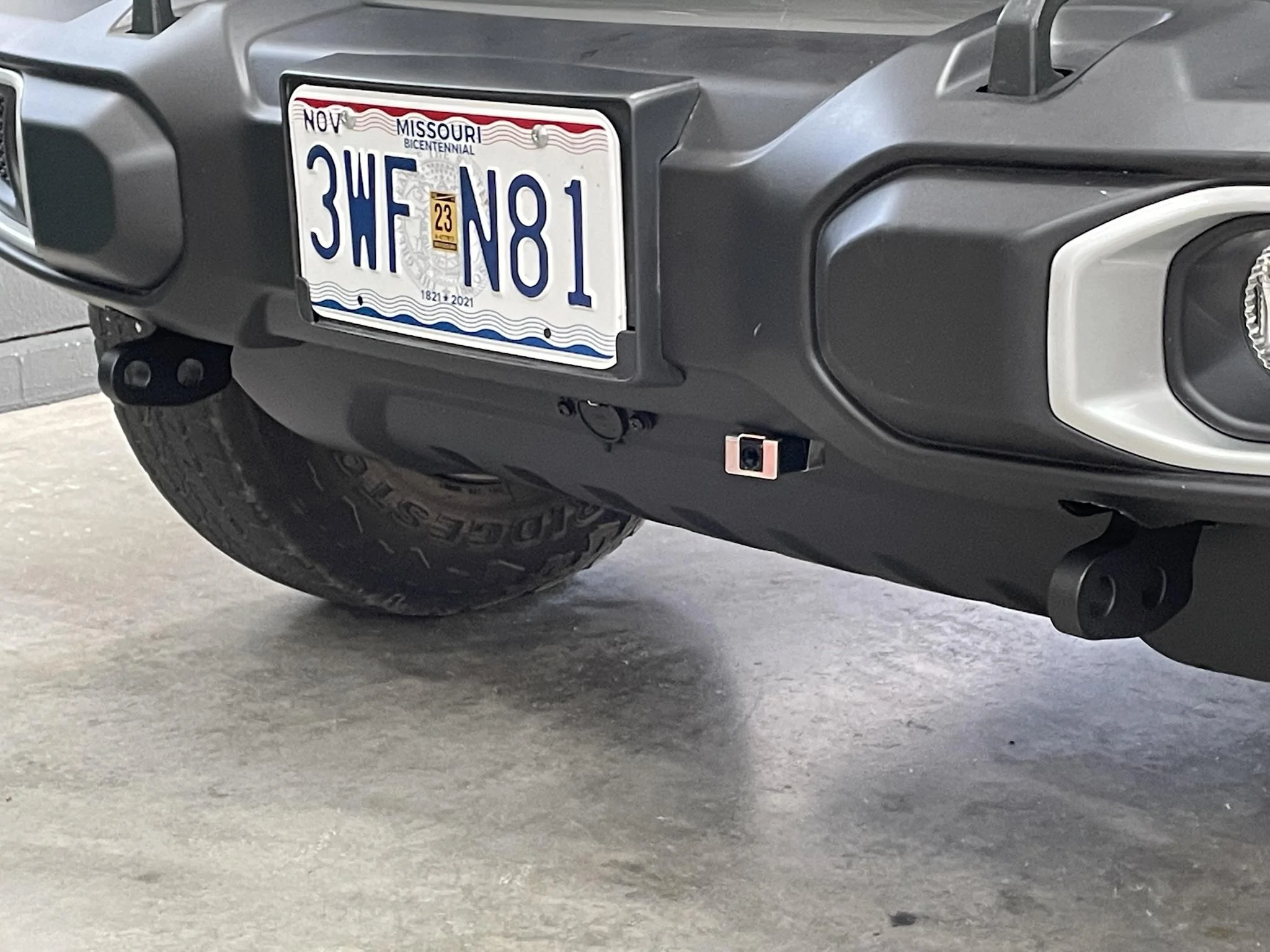

Thanks to you all for your input I have finally installed the Maximus 3 loop and Curt 58946 plug n play connector. Things all went together great and easily.
Jeep Gladiator Flat towing JTR with 37" tires 75DB7081-23EE-4F1B-B5D7-1E4FC9A00DDD
Jeep Gladiator Flat towing JTR with 37" tires 18683618-DAB7-448C-87C1-FEA0C4001EE0

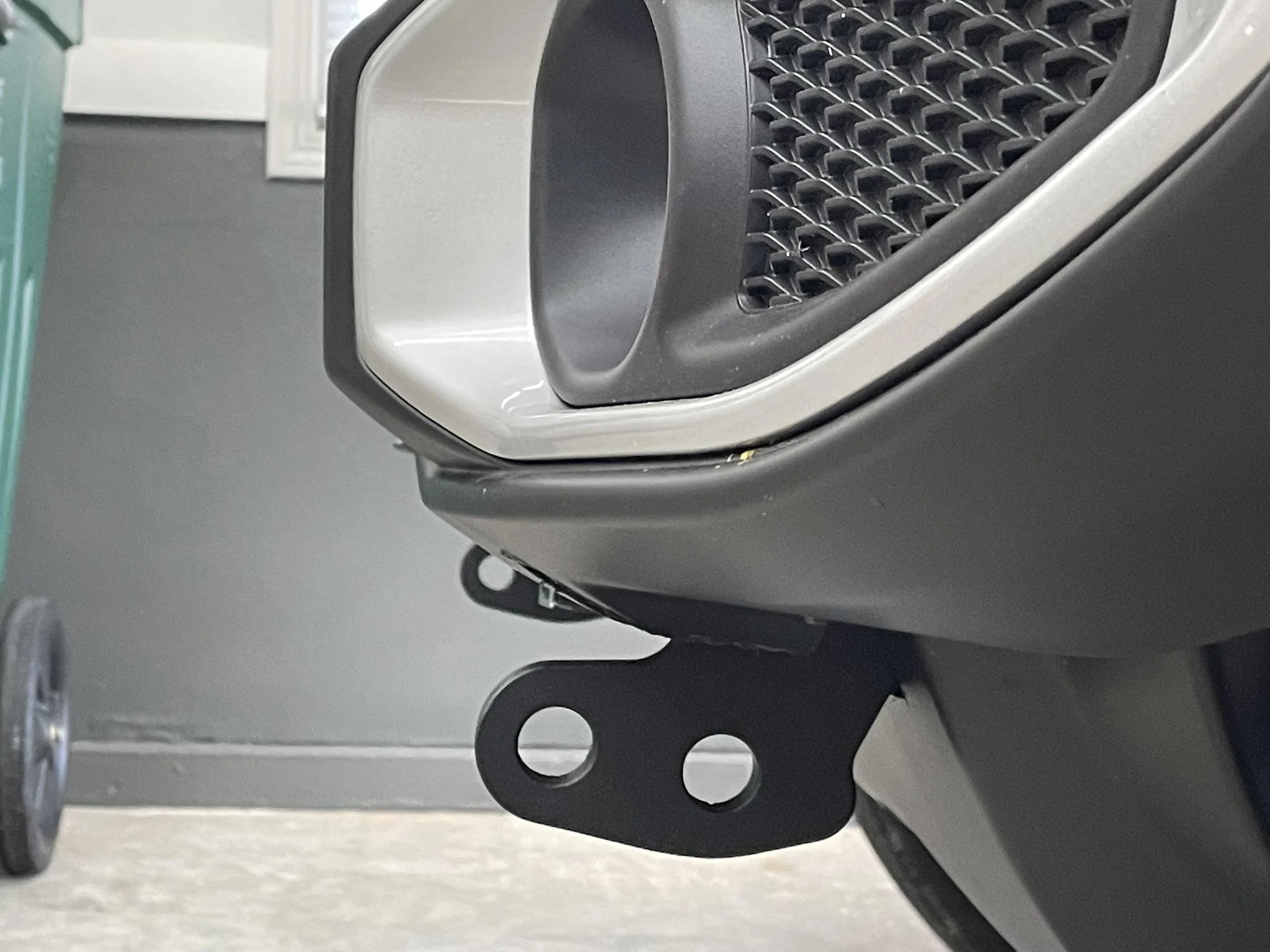

Good morning Dave
have you seen any issue with your tow loops. I saw where someone complained that they bent or cracked there frame. Someone else spoke of maximus now requiring a tow tie rod. i reached out to Maximus and received the documen that I attached. I’m not sure what my next step is.
just an FYI

Good morning Dave
just an FYI
EARL
Well, nuts.
While I haven’t had a problem, I’ve only towed about 1,000 miles.
Just more money, I guess.
