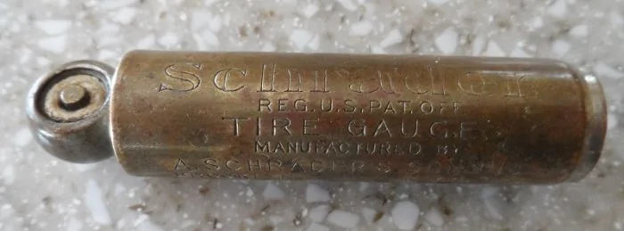

Yeah, old is good............. 1916.............
Jeep Gladiator TPMS reads wrong pressure. tire-gauge-1
But seriously, I have some older tools that still are measuring just fine. My dial type gauge was high-end in it's day (about 1982 - given to me by my then father-in-law). It's made to handle fluid filled tractor tires, etc. - and made in USA. It matches my vehicle readings perfectly. I have always kept it in the padded case when not in use, away from fumes, moisture, etc.
The above is kept in the same cabinet. I have never tried it as I value it more as a family antique than anything.
