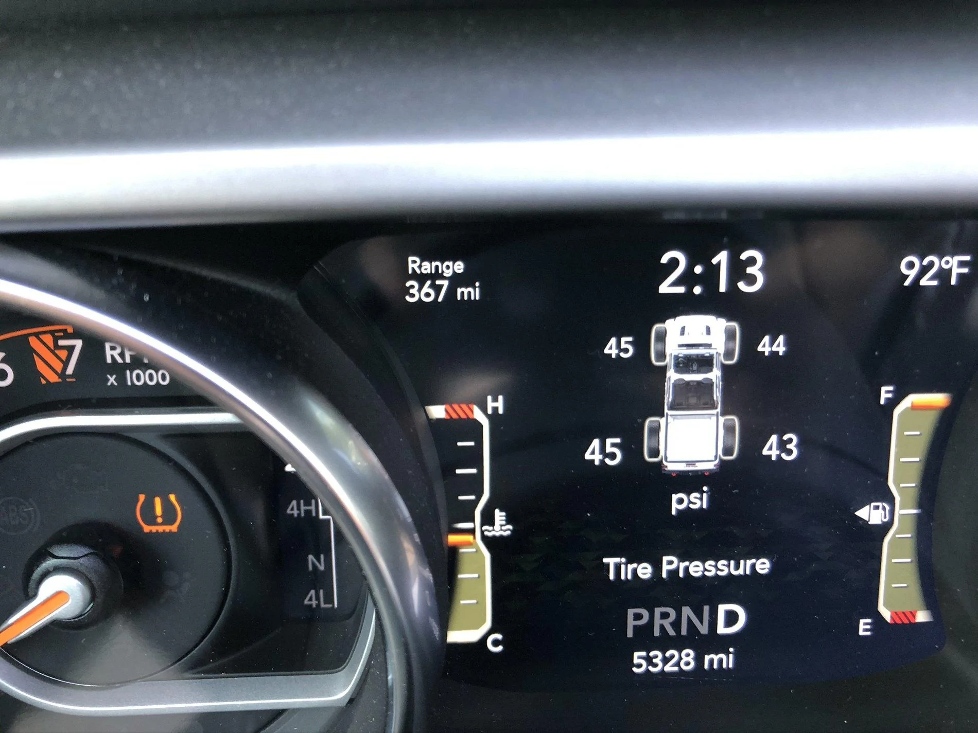

Since I replaced my stock sport s with rubicon wheels, my tpms goes on and off for the two wheels on the left side sporadically . Today this happened . Other than swapping out the tpms from the original wheels, any suggestions?
Had anyone experienced this.

Is it possible that we also get a tpms warning for too much air? That's pretty high.
I try to set mine so they dont exceed 40psi when they get warm and hot days. I find keeping them around 35-36, when cool is good.

I think it may be telling you it's too high. My rubicon door jamb says 37psi cold on stock tires (which seems high to me) and I read usually 41-42 on hot days at temperature. I say drop your pressure and see what happens

So I should add that they worked fine for the first few months ( tpms ) with the occasional double red dash on the left wheel, but wouldn't stick around for long. This hiccup is new. But for some time Now, the two on the left have the double red dash. I lowered the psi to 35 and they worked for about ten minutes. Now the top left shows the dash. Thinking I might have to pluck the original tpms out of the wheels it came with and install them in the Rubi wheels.

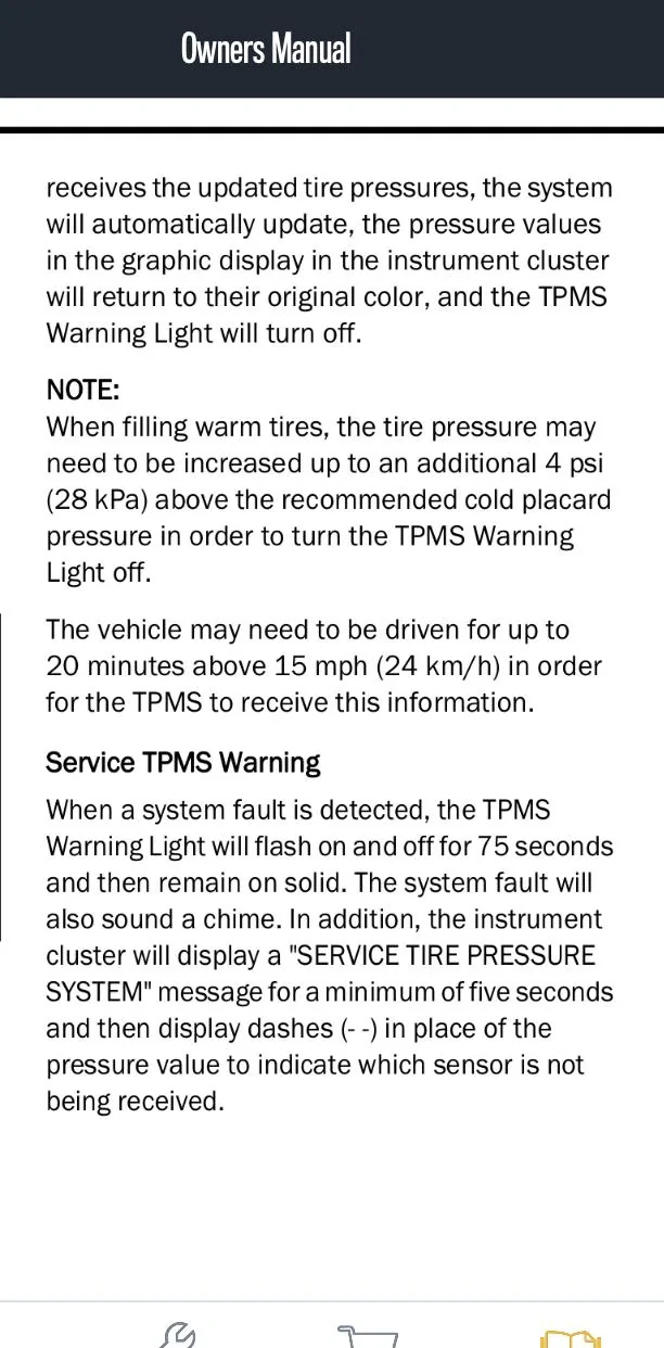

This might be my hiccup
