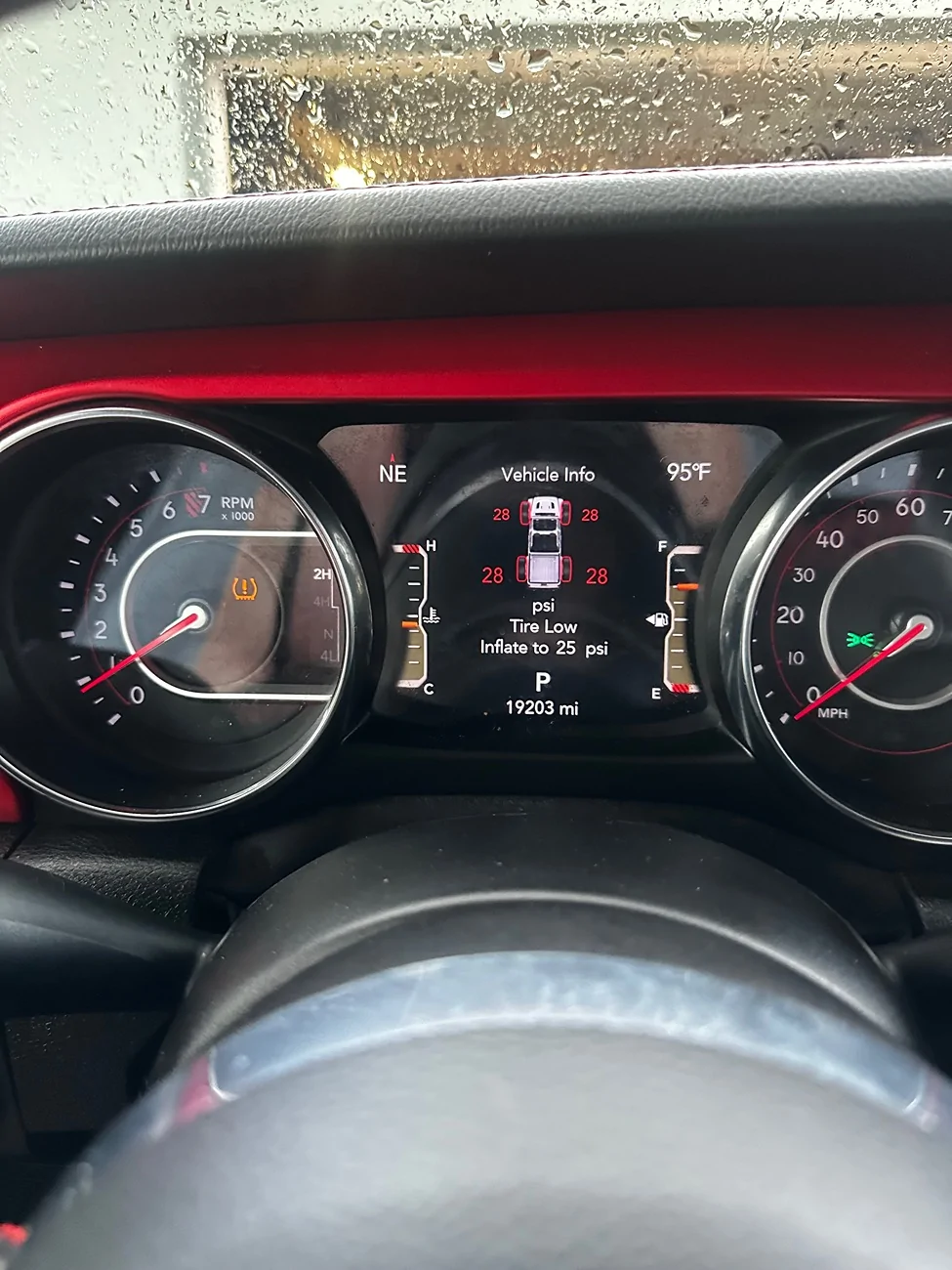

So I installed the tazer JL mini because I run my tires between 25-32 and was sick of swing the light on all the time. After installing it’s still on. The light was when I changed the setting could that be it? Also I know my spare is under inflated but didn’t think that would set it off.

Did you do the reboots as described in the manual after changing the setting? Also go back and make sure you actually turned it off.

It seems to have solved itself. I did all the reboots correctly and then drove it around the block a few times but it was still on. After dinner I jumped back in the truck to run to the gas station and the TPMS light is off now!
