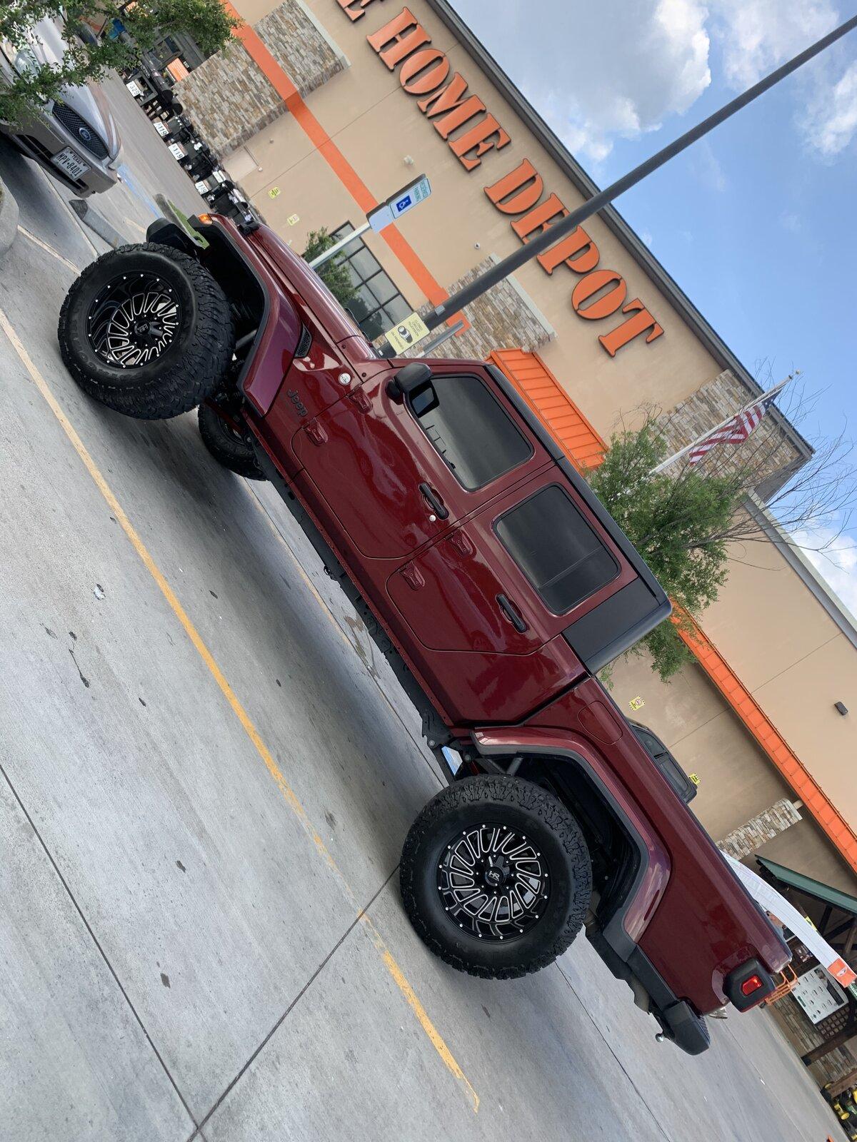

Hey guys do I need to install the track bar bracket on a 4.5 lift ? My springs look alittle bowed and when I turn I can hear some cling noise. Thanks

A track bar bracket will center your axle laterally...it should not affect your springs unless your axle is shifted so far to one side that your springs are bowed left-right. I have the 3.5" skyjacker and got rid of most of the spring bow by installing adjustable lower FCA's.

I got rid of my spring bow with daystar bow correction pads and jks lower adjustable control arms. Already had an adjustable jks track bar. Lift I have is skyjacker 2.5 suspension with teraflex 1" front spacer and daystar 3/4" rear spacer.
