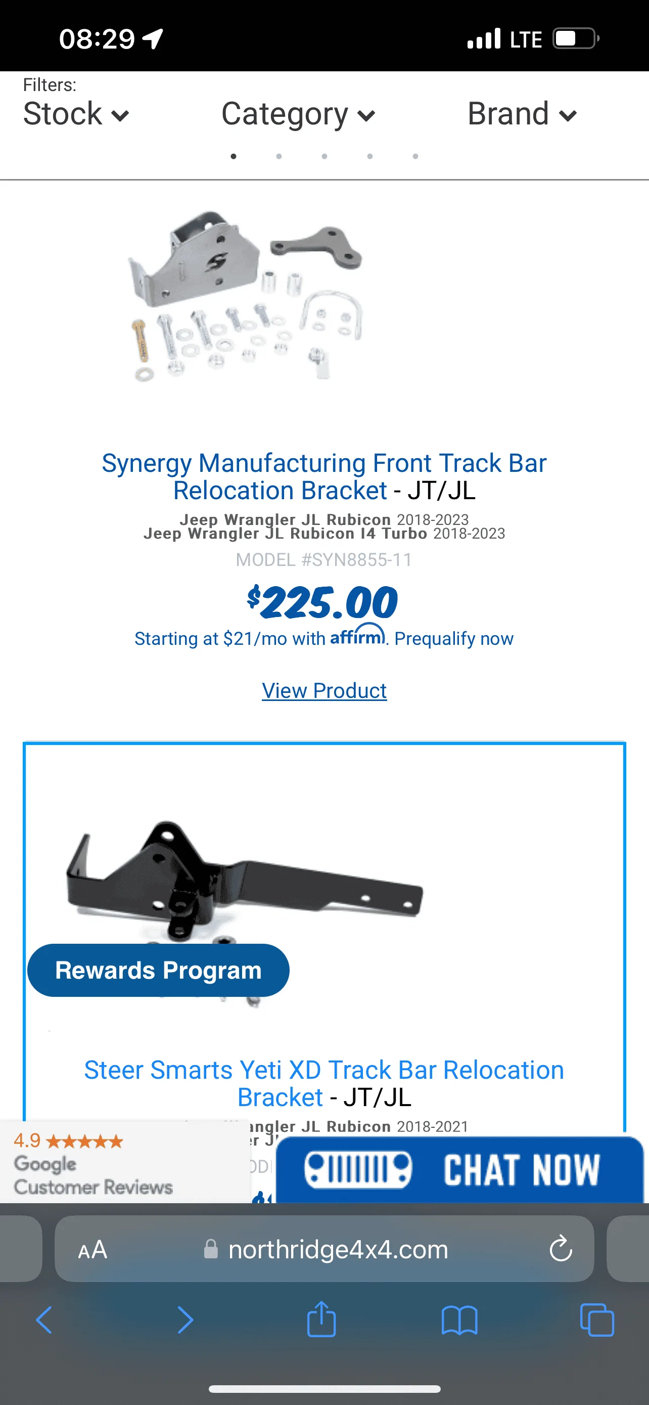

But I was hoping to find a similar solution for the front track bar - so far most brackets there seem to require flipping the drag link.

I don’t think a bracket on the front track bar is a good idea either. Cause of having to mess with the drag link angle once you alter the track bar angle. Not worth it on a small lift in my opinion.

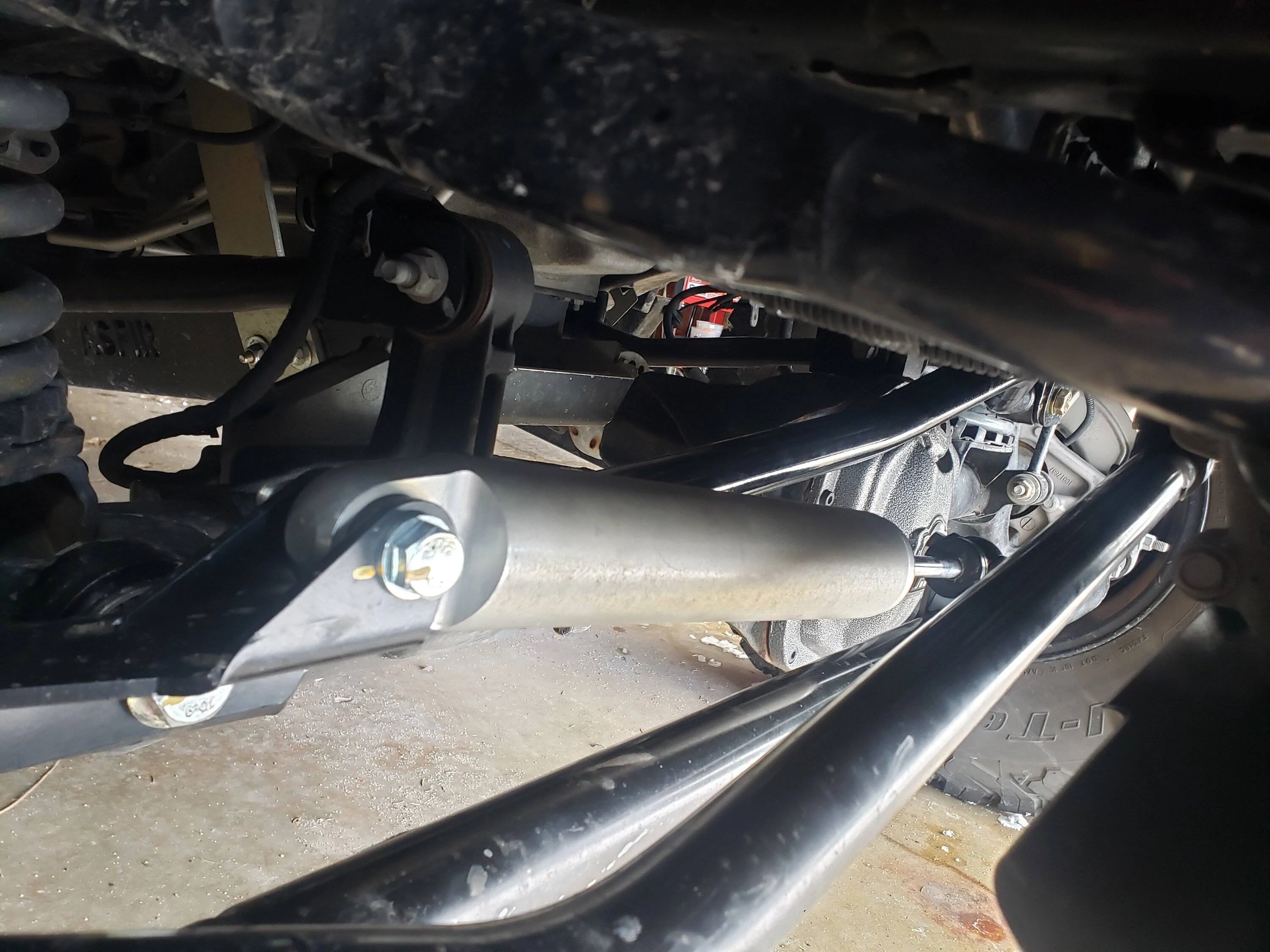

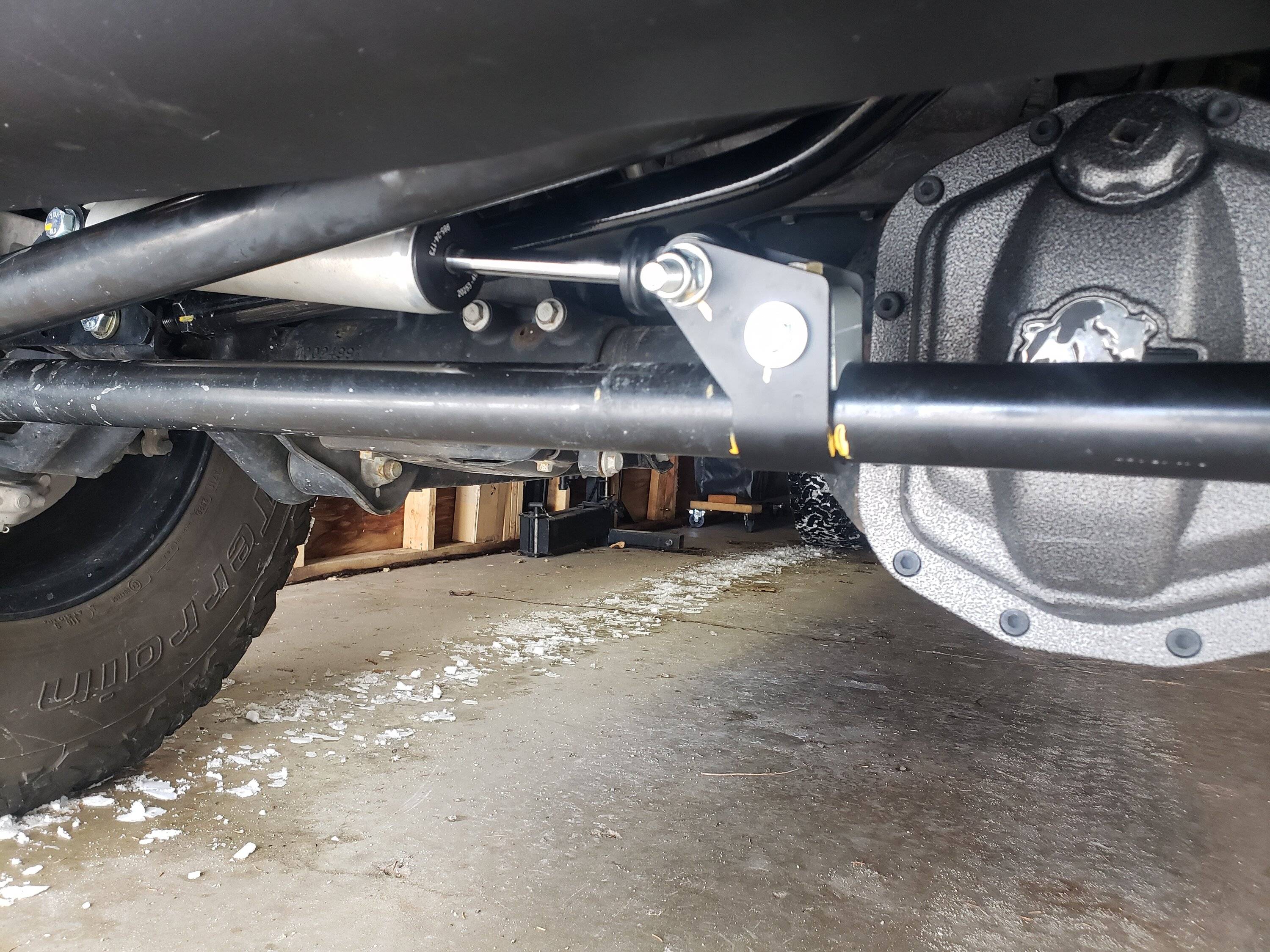

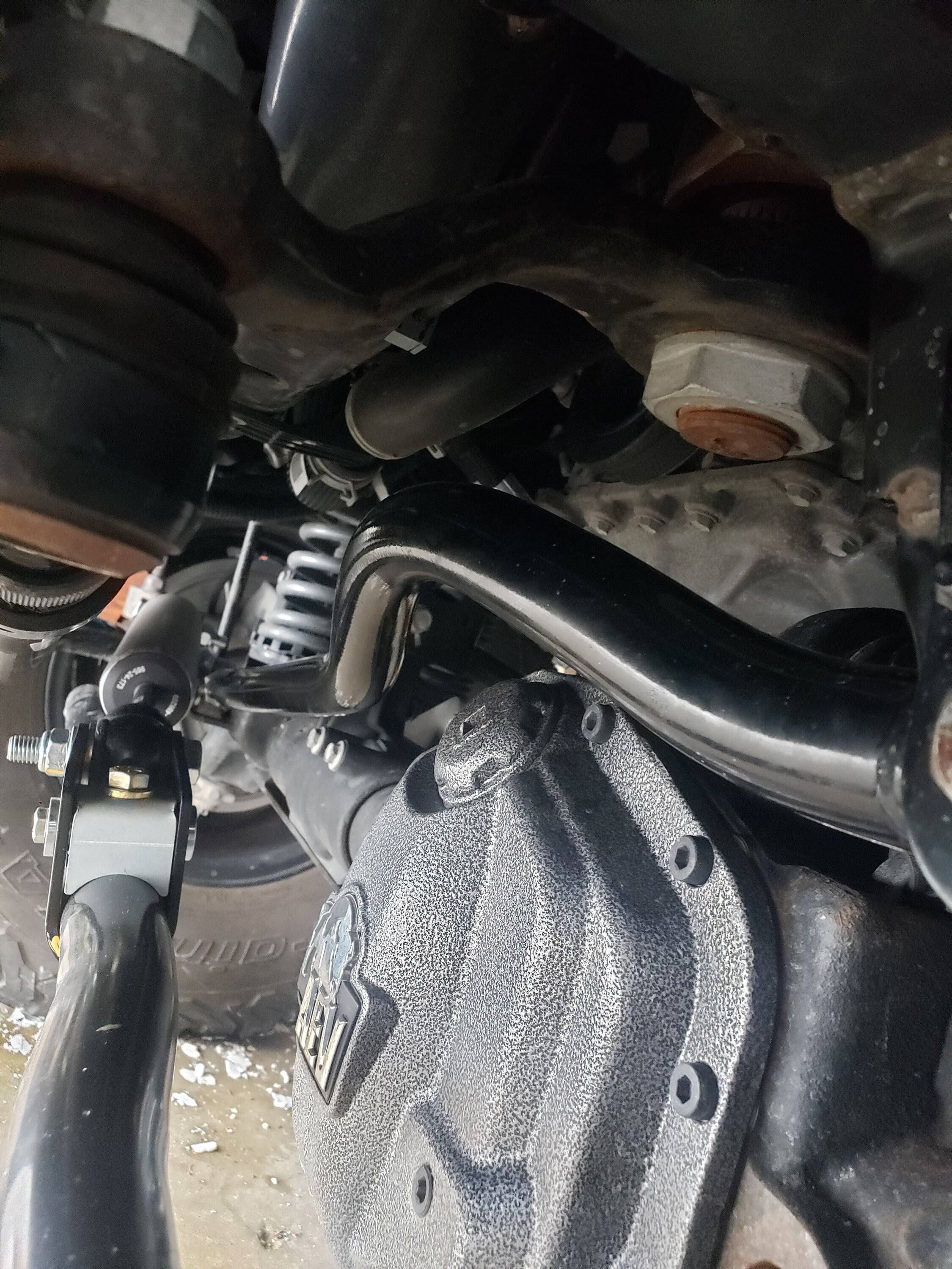

I have a AEV JT370. Obviously, that means AEV lift and 37s. I have noticed the axle is shifted 1.25" to the driver. To fine tune centering the axle an adjustable track bar is going to get you more centered than a bracket could. I, like you, did not want johnny joints. I wanted an adjustable front track bar with bushings that did not require greasing and though may be slightly more limited on the rocks was smooth on road. I initially was going with synergy but found their bar required shaving the factory bracket down which was a no go. I ultimately decided on Rancho. It's affordable, no maintenance, and they advertise NVH reducing joints.
I conjunction, I am relocating the steering stabilizer. I find currie rock jock relocation mount with the corresponding tie rod mount to be the most secure and straight forward way to do it.

I got them all installed friday and for the most part they went on without a hitch. I much prefer the design of the rockjock steering stabilizer over the synergy. Having a dedicated bracket and bolt feels much more sturdy than a button head and stud. The Rancho trackbar looks pretty similar to stock but a bit heavier and obviously adjustable. Here's what rancho says about their D2 bushings: https://www.gorancho.com/products/a.../rancho-control-arm-bushing-kit-rs881015.html
The synergy track bar was going to be my track bar of choice because they don't use a jam nut, but I found multiple reviews of people having a chirp develop because of a portion of the bar rubbing on the axle side bracket. Their instructions even include trimming the track bar bracket on the axle side. That ruled synergy out for me.
I'll post up a picture when it is done snowing.

Pics as promised
Jeep Gladiator Track bar bar geo bracket - FRONT 20230313_123106
Jeep Gladiator Track bar bar geo bracket - FRONT 20230313_123025
Jeep Gladiator Track bar bar geo bracket - FRONT 20230313_123009
