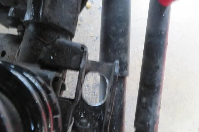

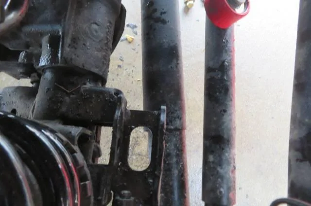

The track bar bracket on the axle.
I went from this.
To this to get the Core track bar to fit. Was worth it if you want Johnny Joint's.
Yea that seems to be the case with MC. Which is fine if I had the energy to do that, but after two days of wrenching…i am beat. Who knows, maybe I’ll hold off on returning the MC track bar and wait a month or two when I have the energy to get back under the truck lol

I enlarged that hole in about 2 minutes with a 1/4" die grinder and a burr bit.
