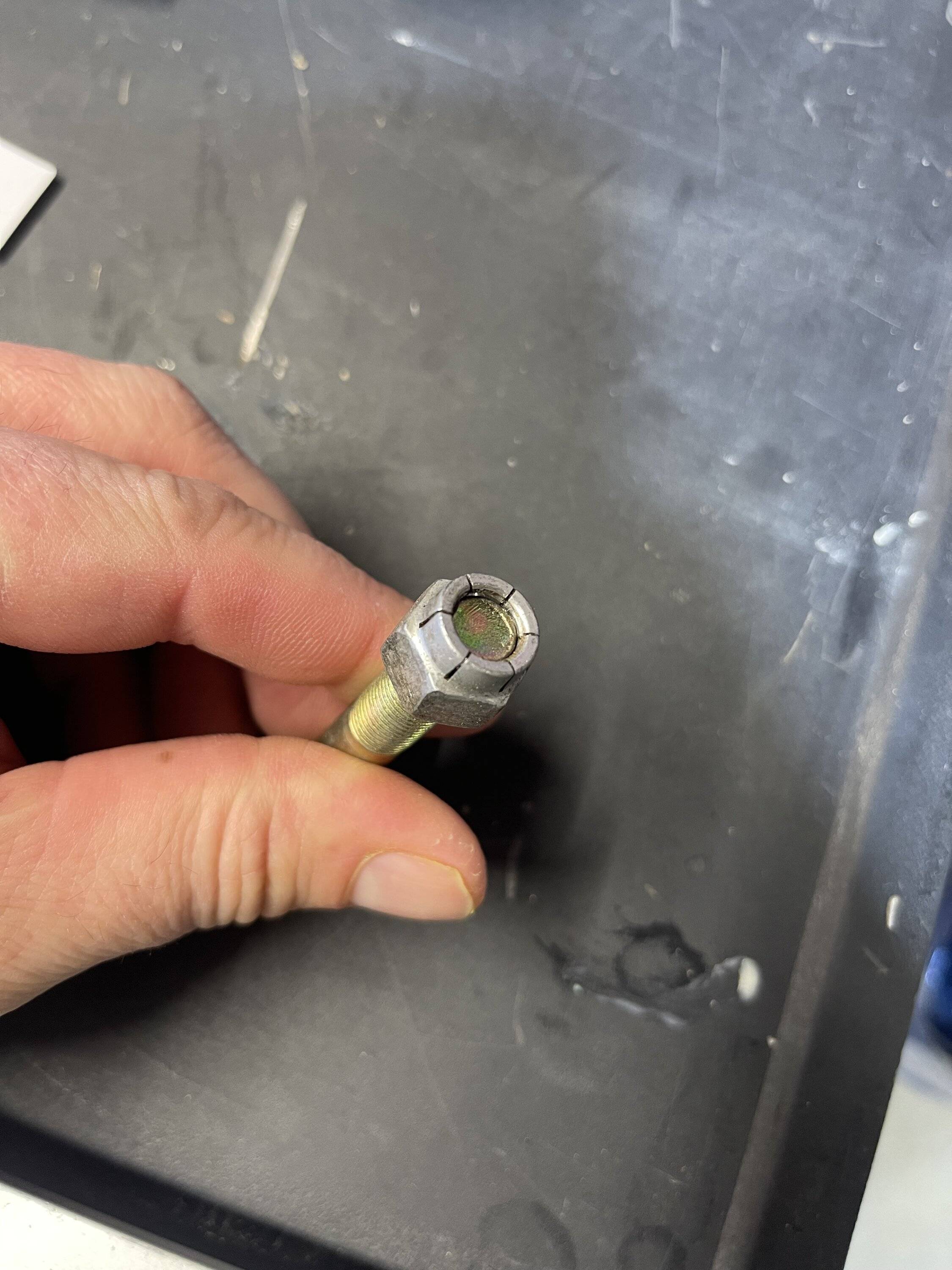

Have you had any issues with yours? Im running one on the front as well with only a 2.5 lift and when i put my bumper and winch on now the lock nut is hitting the frame causing it to pop and to come lose....
Just curious- is it a nylock or pinch nut?
if you over torque either they come loose with pretty minimal vibration.
Nylocks have a max torque and remove of 5 times. Pinch nuts are 7.
I would like to say this is just a fun fact…. But racing in the desert has forced me to learn this…..
If you have a kimbal Midwest or other specialty hardware near by- these aren’t cheap but best nut design ever…. 50x on and off and rated to silly temperature ratings too…
Its my Jam nut on my johnny joint thats hitting actually its hitting where it slips betweens the frame to be bolted it its so strange
