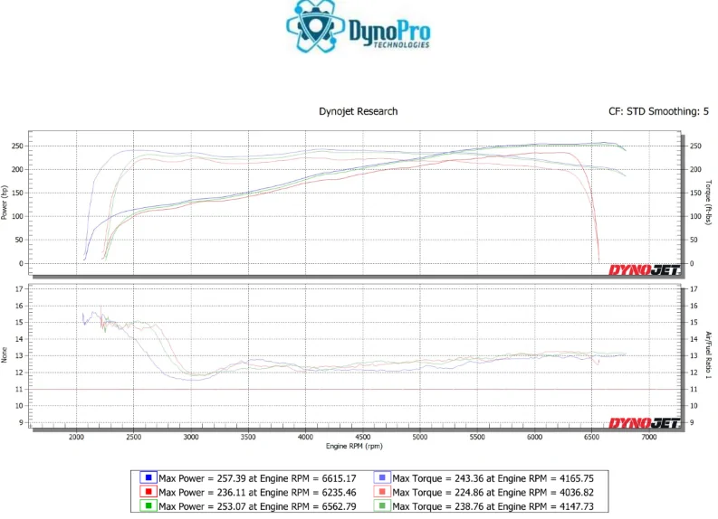

Today was the long awaited trip to the dyno. This was with my JL, but JT will be the same, exact same tuning between the two.
Overall goals were:
-10 HP/10 TQ on 87 Octane
-30 HP/30 TQ on 93 Octane
-Smoothing the torque curve and getting a more flat powerband under 3500 RPM
-Optimizing WOT fueling and finding the power limits for fuel and spark
-Backing everything down from the limits for a safe file that will keep your Jeep reliable and safe
Big thanks to EcoTech Imports in Affton, MO for letting me hog the dyno for 3 hours this morning. Highly recommend his services if you own a Subaru! Big thanks to @kefurr for tagging along and watching. He got to truly see how big of a nerd/dork I am.

Specs and info on today's run:
-93 Octane Top Tier fuel already in the tank, so my stock numbers are actually really good, these pull timing with 87 in the tank.
-Fresh oil change, 5W30 PUP, it's 3rd oil change since it's purchase (put some Pennzoil up in there.....synthetic....IYKYK
-7400 miles on the jeep
-Bone stock Sport S, no mods, stock exhaust, stock intake, air filter is actually a bit dirty, oops.
-3.45 gears, 31.5 tires
-95-100 degree ambient temperatures
-All runs done in manual mode 4th gear with torque converter locked and with traction control off.
-Intake air temperatures ranging from 110 to 140 degrees (HOT)
-All knock sensor settings and safeties left in place.
-Two wideband sensors installed to verify fuel trims, both mine and the dyno operators.
Some things I have learned while developing this tuning platform and further confirmed today-
-More air and more fuel does not mean more torque under 3500 RPM, too much causes disruption and a dip in torque, this is how the factory is set up.
-Maxing out the intake cam advance at WOT actually causes the engine to bog down a bit even though it's sucking more air.
-This engine likes intake and exhaust valve overlap underneath 3000 RPM and actually benefits from it (this was hard for me to wrap my head around).
-High lift is never used during WOT (I proved this months ago, but the dyno proved it even more).
-This engine likes an AFR of 12.0 to 12.3 at wide open throttle, any leaner does not add any power and induces spark knock.
-87 Octane can only handle about 2 degrees of extra timing below 3000 RPM, otherwise timing must be pulled lower than stock to prevent knock retard when hot.
-91 Octane or higher is pretty much a must use during the summer time if you don't want timing being pulled.
-93 Octane freaking rocks in this engine, it can handle 8-10 degrees more timing under 3000 RPM, this amounts to an extra 50-80 pound feet of actual useable torque in part throttle driving so long as the engine is tuned to command it, which mine are.
-Neural Network (basically an advanced VE system) is fairly accurate stock, but start tweaking stuff too much and it needs minor adjustments.
-These engines run naturally lean at all times, especially at WOT, up to 7 percent lean in certain instances.
-Messing with MBT timing tables throws off a lot of stuff deep within the tune, if your tuner does this, he should stop. LOL
End results-
Red - Stock Run, 236 HP 224 TQ
Green - 93 Octane Original File, 253 HP 238 TQ
Blue - 93 Octane after revision, 257 HP 243 TQ
87 Octane Tune (sorry, forgot to add to dyno graph, see Youtube video for clip of it) - 245 HP 229 TQ
So frankly, I was a little bit disappointed, as Livernois claimed some higher numbers using the same dyno. I could have achieved those numbers with added spark timing and decreasing knock sensor response further, but I don't tune that way and I never will. I would rather not push the limits. I actually only even had ping on one occasion today. I did not want to push the envelope too hard as this is my wife's daily. I know how my customers use their Jeeps, and again, my focus is on part throttle and daily driving and not just WOT. My customers on here will vouch for me. I have nothing to prove.
These were less than ideal conditions. For most people, as I have been saying all along, plan on 10 HP / 10 TQ peak increases with 87 octane, and 20-30 HP and 20-30 TQ with 91 to 93 octane. Plan on having an extra 20-30 TQ available under the curve at part throttle with 87 octane, and an extra 40-50 TQ available under the curve at part throttle with 93 octane. Unfortunately, there is no way to dyno this.
I hope you all enjoy this data. Again, I strive for integrity, transparency in my process, and giving you the best end result.
