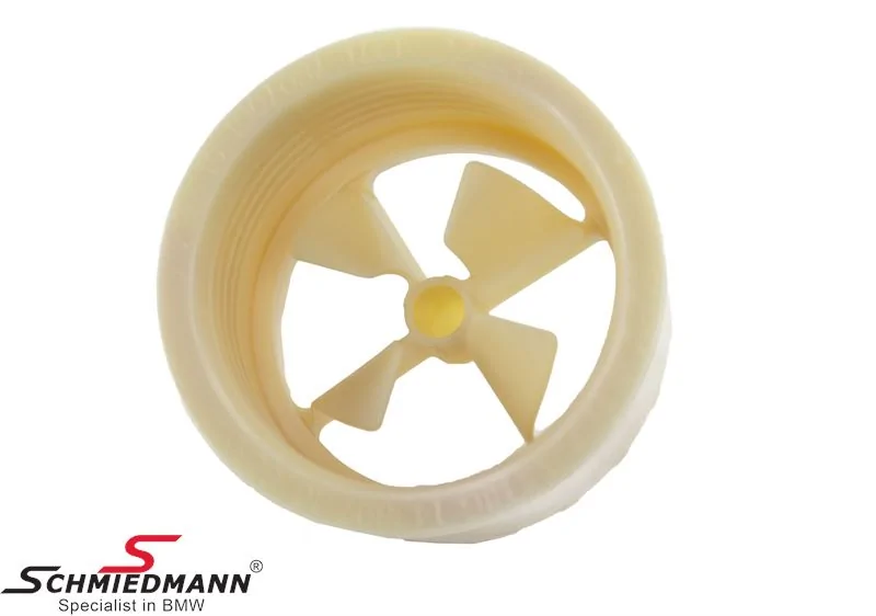

All ya need to make HP
Jeep Gladiator S&B cold air intake test and dyno image_364333_big
