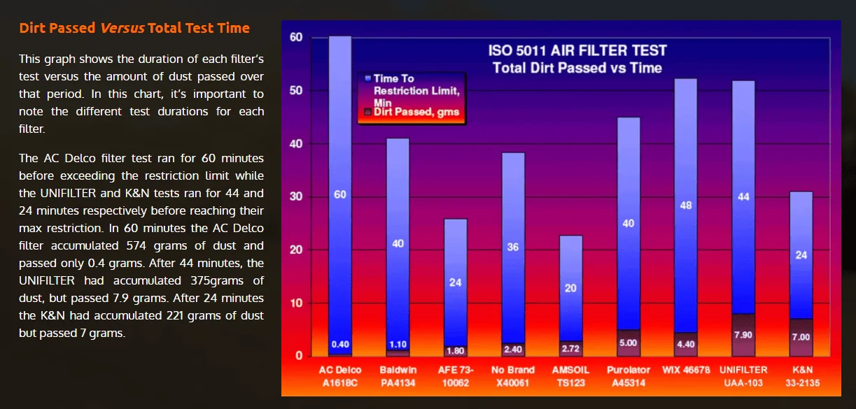

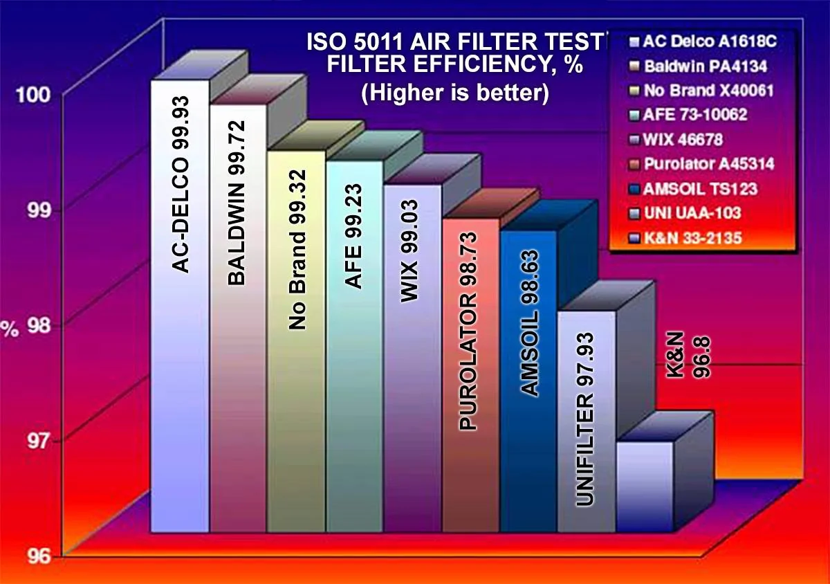

As noted in dyno testing, and the link I posted earlier, the K&N filters do NOT make any difference until above around 3,000 RPM (will vary with engine, etc.) plus - the K&N gains drop off very fast - so you really only have any gain above 3,000 and then for the first miles. Dyno and other testing proves that those filters are more marketing hype than anything and the improvement, as high in the RPM band that it is, is very short-lived. In other words - an average vehicle will gain nothing, especially on the highway.
Racing, yeah, if you keep cleaning it constantly. They lose efficiency - they lose air flow advantage exponentially, the curve is very straight up while the loss of other filter types is more of a straight line ramp, gradual over time.
So if you race your Gladiator, and/or constantly run it above 3,000 RPM and want to clean it every 4 or 5 thousand miles - go for it. But also note that they aren't as good at trapping the dust and dirt people claim they are - again, proven in scientific dyno testing.
I'm sticking with a quality paper filter. The filtering is far better, and they maintain efficiency for thousands of miles longer. I don't race my truck. (except when trying to get through Des Moines on I235 at 7am)
Based on these, since I prefer engine life long-term to short term gains of miniscule HP at 3,000 RPM and higher - it won't be K&N for me - It's one of the worst filters out there for letting real dust and dirt pass through. (and this is a scientific test, not some youtube DIYer looking to monetize their amateur tests)
Jeep Gladiator Cold Air Intake Benefits? total-dirt-passed
Jeep Gladiator Cold Air Intake Benefits? ISO5011-efficiency

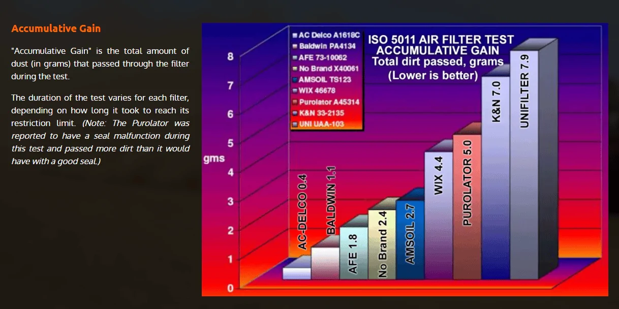

Here is total dirt allowed through vs. time it took for them to reach maximum capacity - pretty sad for a certain popular filter. It lasted half the time of the better filters and passed 7 grams of dirt compared to .4 (4 TENTHS) of a gram.
Jeep Gladiator Cold Air Intake Benefits? total-dirt-passed-2
IF I did a CAI, I'd use one of the better filters as based on scientific tests.

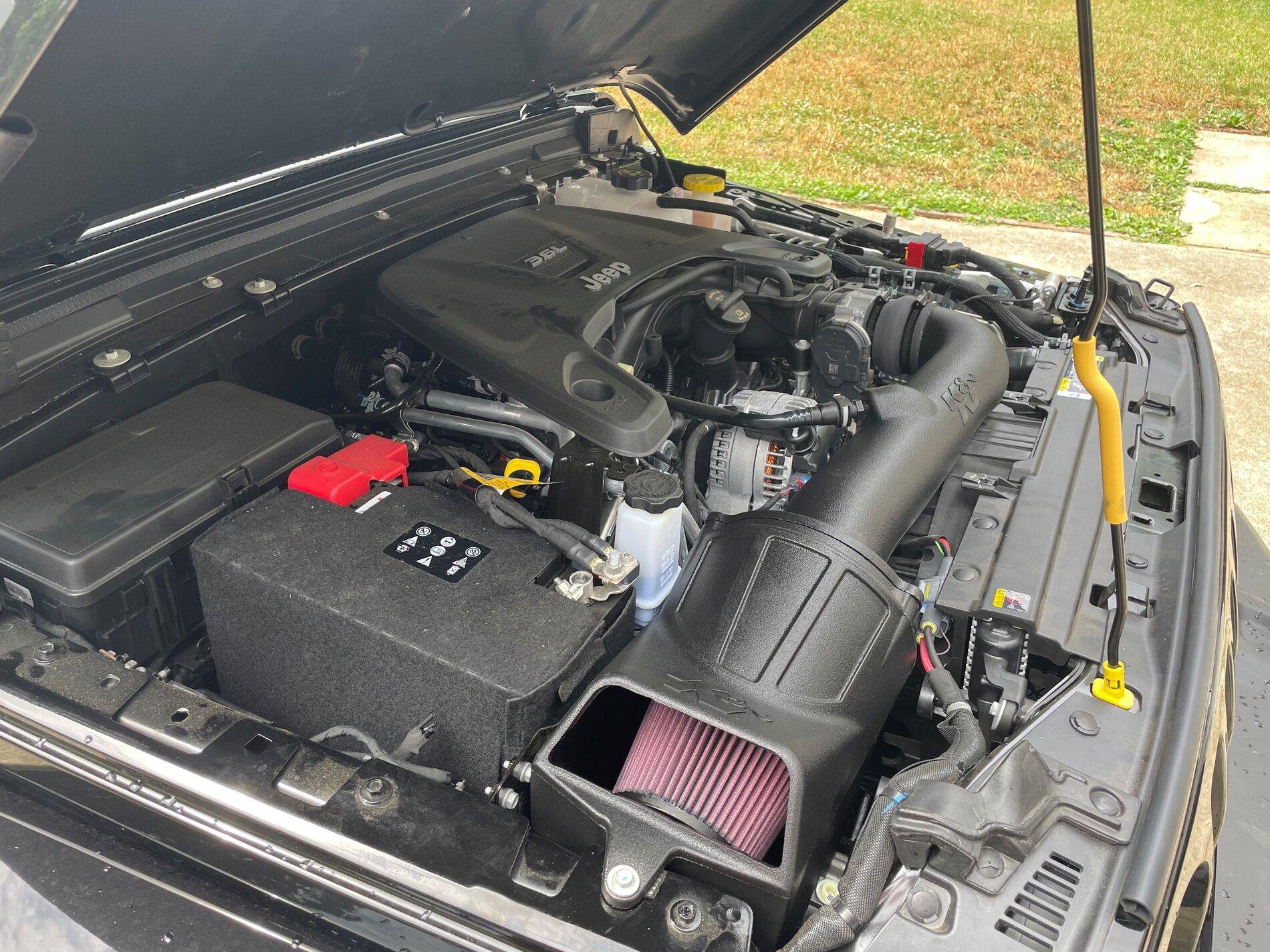

Y'all can flap all you want about blablablalbalbal...... :headbang:
I just simply love the glorious sound they give us back ha, particularly with a manual.... not to mention the cleaner looking engine bay, but, for me it's the sound!!! :LOL: ?
Ya like to hear those moles LOL
