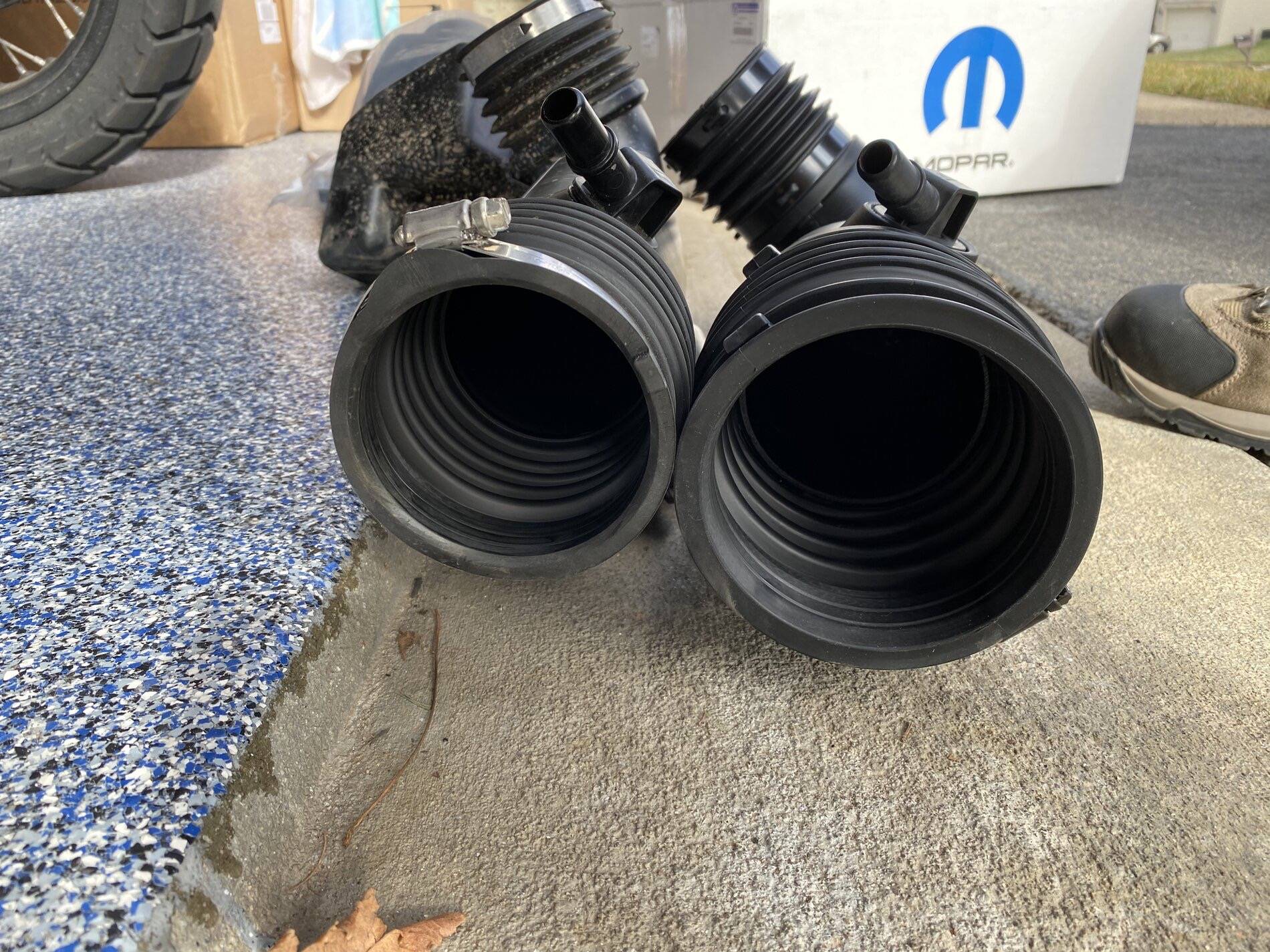

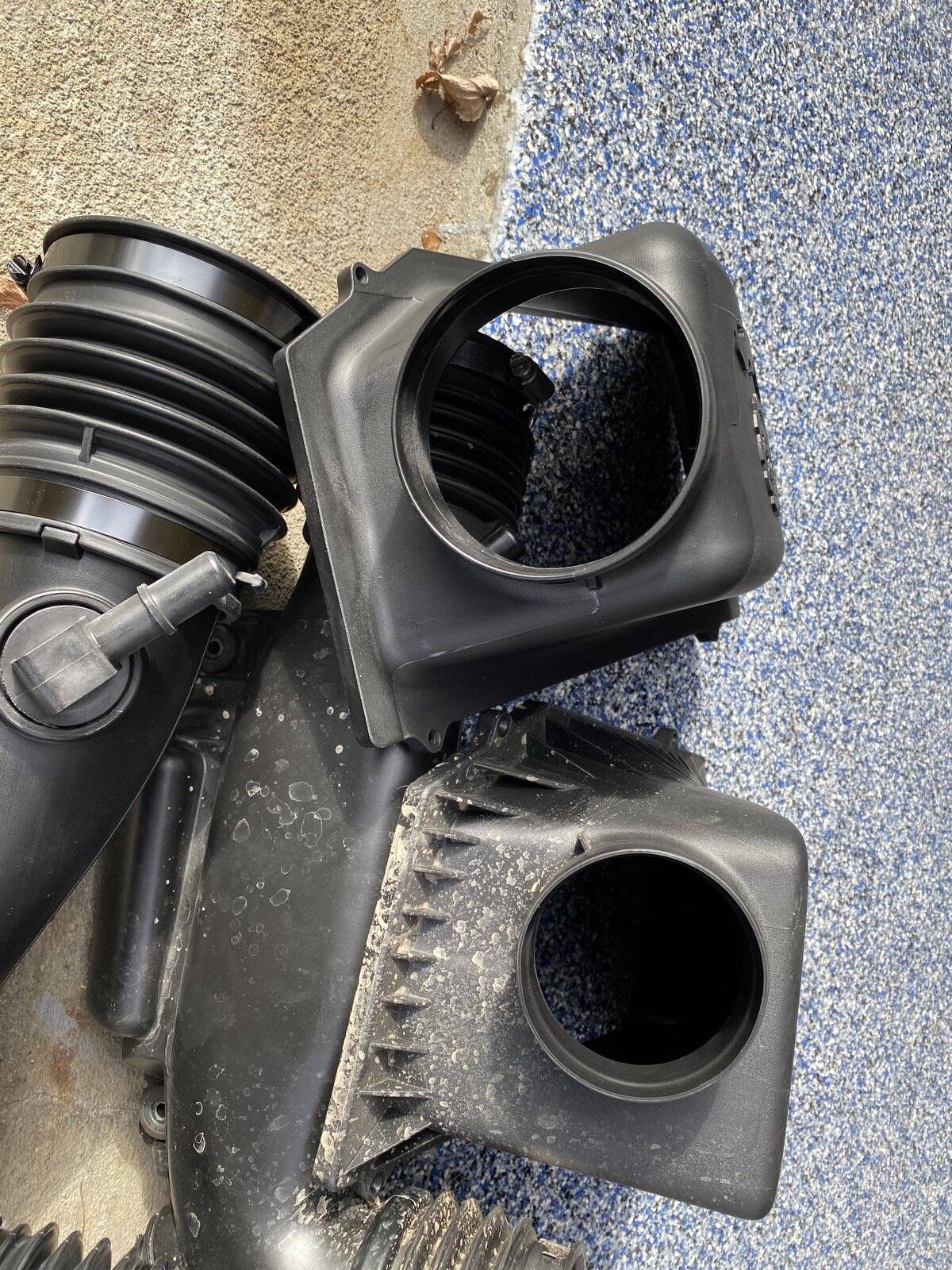

I have a Mopar CAI and like it, reason’s are intake tube is huge compared to factory comes out of the replacement cover at about four inches, eliminates every resonator, opens up the area around engine you can see everything so much better, uses a factory dry filter or over size factory dry filter, does not suck air from under the hood like many others. My gas mileage with Mojave is good at 18.5 around town and 22 tops highway , many many people report that mileage with 37 inch tires, my driving is hilly terrain and either long runs on highway to beach or ten minute trips up and down hills, so probably no increase I can prove , and everyone says they flat out suck and give no more power or less but my seat of the pants feeling at high end felt a difference.
My feelings are any intake open to the engine bay is a bad idea, as is oiling a filter, and don’t cut your hood with the Mopar.
I get that I’m old and cars have changed so much but looking at the Mopar parts next to OEM is a huge unrestricted path, including the baffles in the filter box lid and every time I drink a thick milkshake through a small straw and change to a larger one , I can’t help but think The motor is not working as hard to such in the air!
The Mopars are expensive I bought a used one here cheap, but liked it enough got one for my wife’s JL.
The engine looks better with the Mopar CAI and removing the engine cover, and if it makes me feel great it is all good ,if you need 37” tires to feel great it is also all good…..Jack
Edited to show difference between the OEM Mopar and the Performance Mopar air intake. It is huge.

In reality, this is a much smaller engine compared to others that have the same intake area.
CFM - it's about flow. Doesn't matter how large that intake is. There's other pieces of the puzzle restricting air flow closer to the engine. You do want to keep the air velocity up - and larger decreases velocity.
Too large is actually detrimental. You want the air to have momentum going in, a column of air with some velocity, and mass, that wants to keep flowing even as the piston passes BDC. Too large and you can't get that effect.
Your throttle body is much more of a "restriction" than that air intake is. The manifold itself is another part of the puzzle.
What no one has done is worked with actually testing flow - and vacuum - in the intake system.
Your sensors actually take care of things, MAF, for one.
I'd love to see someone swap air intakes and give the comparison between readings before and after.
It's like guys insisting they should put a 4bbl carb on their 258 - but have a stock cam, stock exhaust and so on.
Placebo effect.

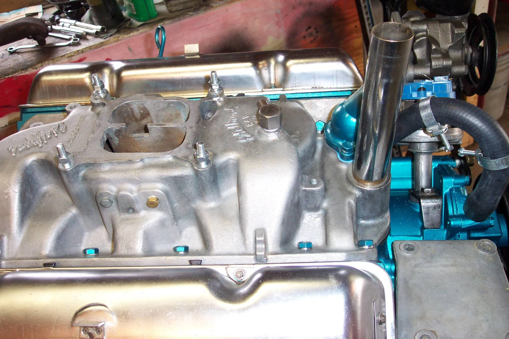

This is a 6.5 liter engine (at least after I got done with it) and look at the carburetor mounting pad of the intake - compare to the air that can flow through that tube of the much smaller 3.6.
Can a 3.6 flow as much as this could? And the carburetor air horn is an even smaller volume than the intake plenum area.

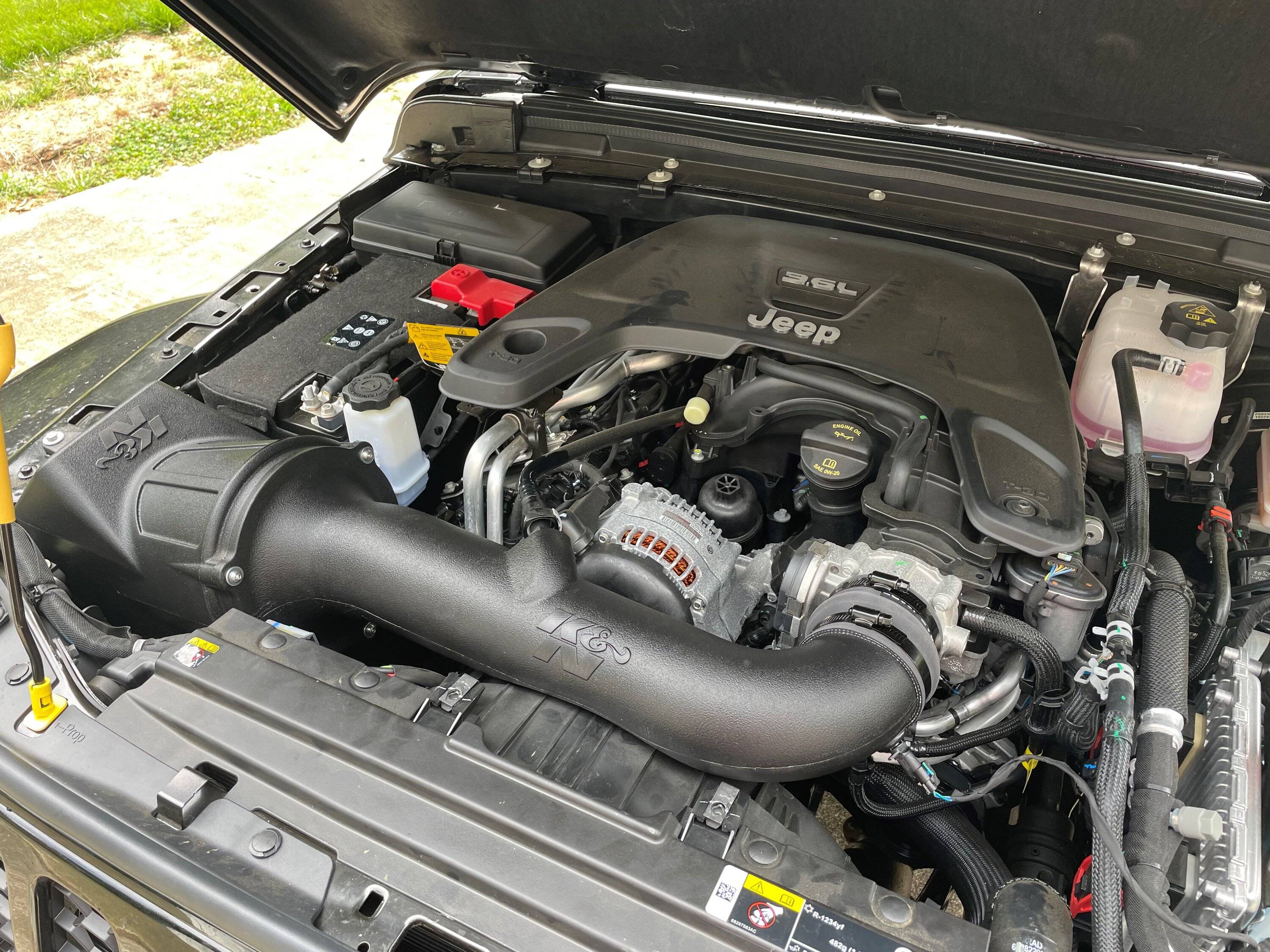

Just as another option/engine pic, I've really enjoyed the K&N option for the last two years. For me it's all about the sound, and I love it every time I drive it. Just don't expect anything other than sound for this mod, regardless of what brand you go with. The K&N sound is a bit more aggressive than the Mopar option, which is what I wanted. Quiet when highway, but sounds great when jamming gears.
