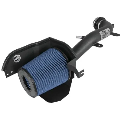

So I don't know if this question has been asked or answered i guess.
Whats the difference between the Open Filter intakes and the ones in the closed enclosures with the small open slot. Do they both give the same amount of air flow?
For example these two:
Jeep Gladiator Cold Air Intake... 54-13002-b_1_3.1595517812
Jeep Gladiator Cold Air Intake... 54-76217_1_2.1595517742
I'd imagine you get more flow with it open, but not sure. The one with the greatest flow, however, is Banks. But it actually may have more to do with the area of the filter's pleats, rather than a box. Flow does not equal hp. There is an optimum for which the 3.6 is tuned, and the factory box nails it.
If you examine where and how the air comes into the grille on the stock setup, it may get cooler air than any CAI that removes it, or than the more open unit.
You will also likely lose some measure of water ingestion protection without a box, off you go off-road.
Manufacturer can provide flow rate. I suspect either of them provide more flow rate than the engine can consume at w.o.t. which is the measure of adequacy. Additionally restriction can and does in many cases increase charge air velocity, so provided flow rate is adequate, the box that is "restricted" may very well be more efficient by all measures than the less restricted model.
Beyond that on a vehicle ostensibly purposed for off road use and potentially subject to some degree of immersion protecting the filter from splash becomes a thing.
So, what you're saying is the Banks CAI is the way to go?
