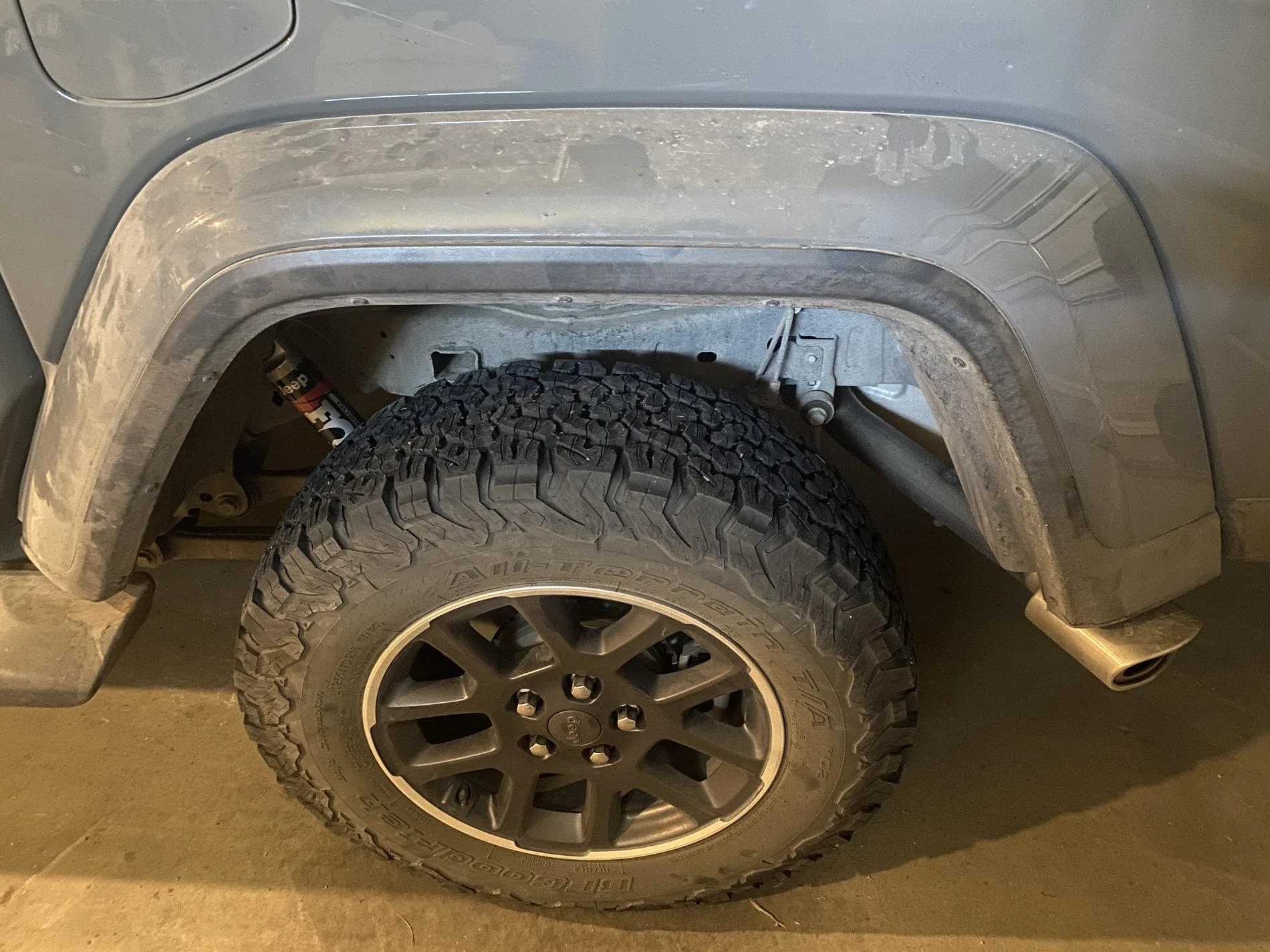

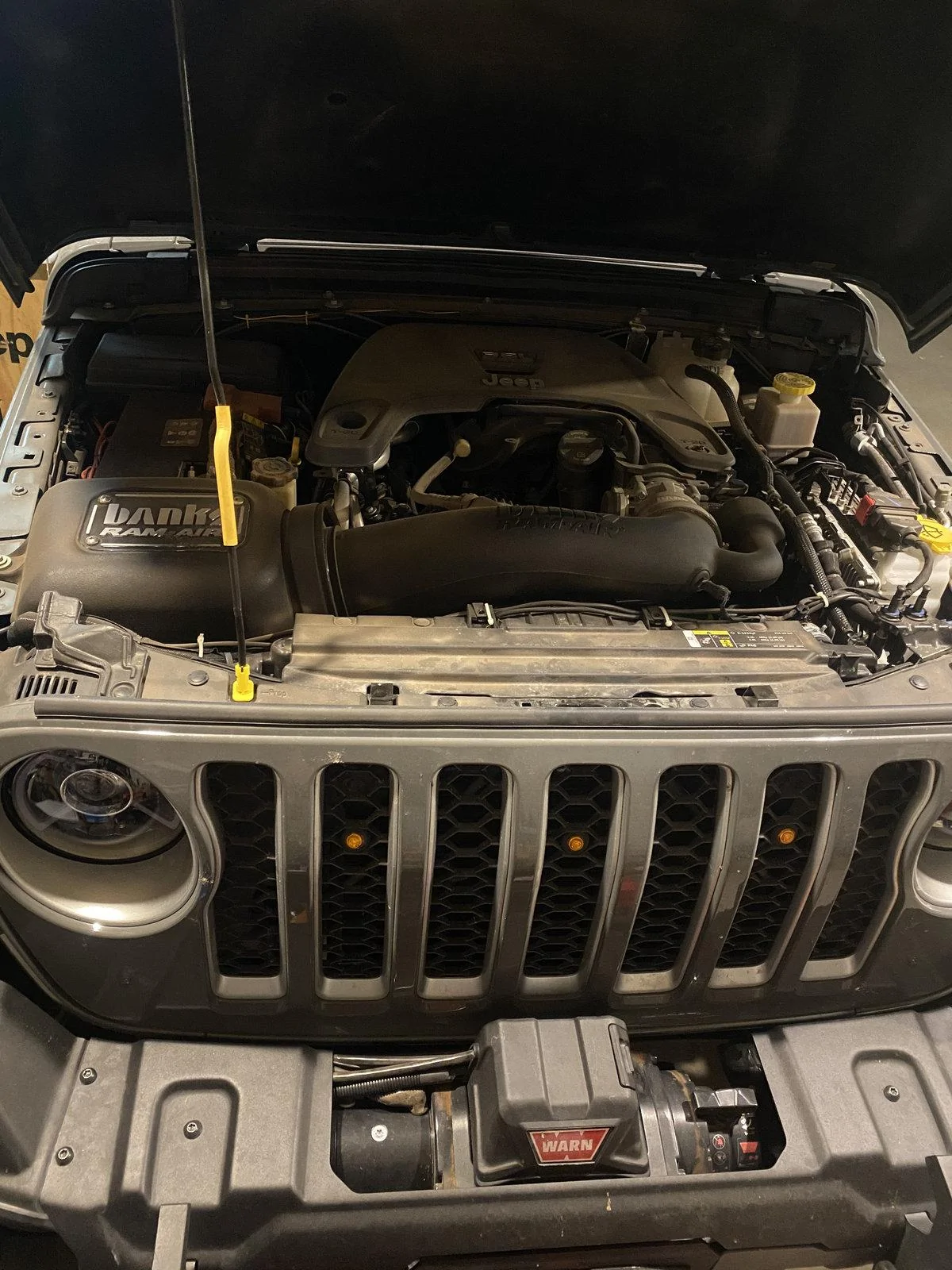

I have the Banks Ram Air. It adds some nice engine notes paired with the Hooker dual exhaust. On that note the Hooker dual exhaust looks great in my opinion. The two paired are too loud for my taste; my wife likes it and she is picky. It makes some small gargle exhaust noise that reminds me of a AMG GLA 45 I used to drive. Definitely not as cool of exhaust notes compared to the GLA 45. I'm going to switch the intake to the Mishimoto when it comes out.
Jeep Gladiator Cold Air Intake... Hooker EX
Jeep Gladiator Cold Air Intake... Banks

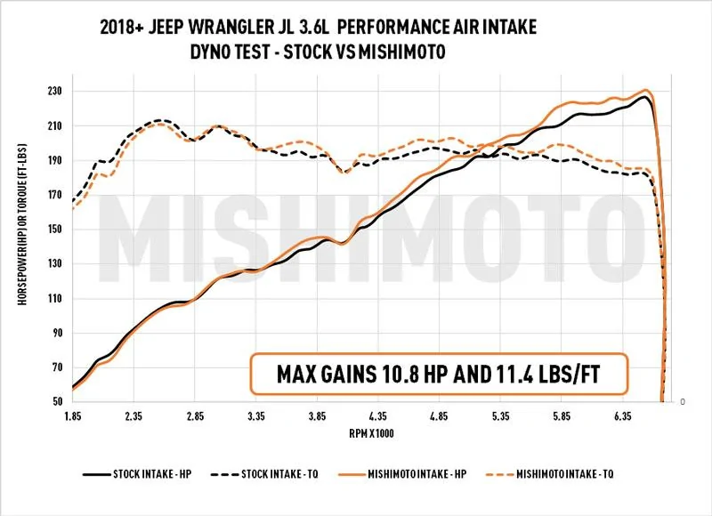

Personally, from hours and hours of dyno time, any intake without supporting mods, like a larger throttle body, don't do jack squat. You can't force more air through a throttle body by making the tube leading to it larger. You can't force more air through the intake plenums. The 90 degree bend leading in to the throttle body negates any velocity stacking effects a larger, smoother intake tube would provide.

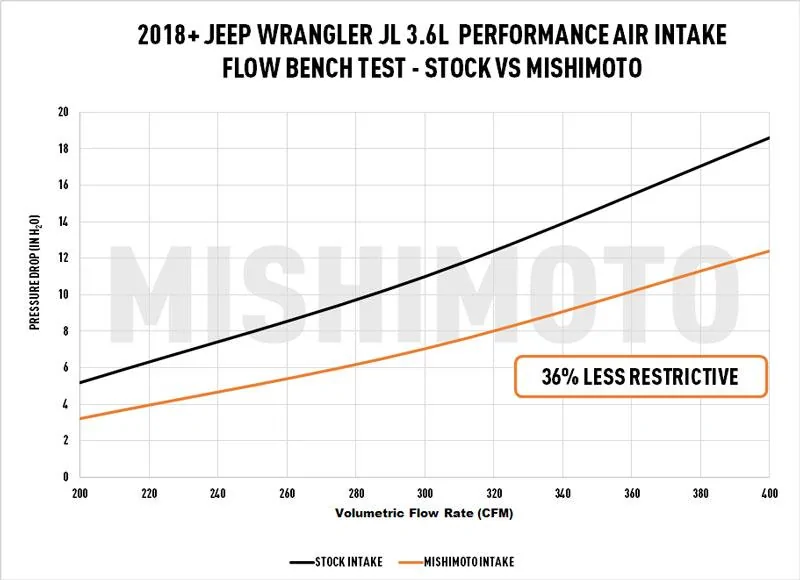

I'd like to see flow bench results from OEM and any of these intakes that claim power increases. And then flow bench the plenums. Air, unless mechanically compressed, will only flow so much volume through an orifice.
I'd be happy to share the data we have from R&D :)
Here are our dyno results (average over 5 runs, after driving the vehicle 100+ miles to allow the ECU to adapt to new airflow characteristics):
Jeep Gladiator Cold Air Intake... 400-MMAI-JLP-18S_1
And here are our flow bench results for the stock intake vs. our intake:
Jeep Gladiator Cold Air Intake... 400-MMAI-JLP-18S_2
Here's the raw data for the flow bench too, flow is measured as pressure drop across the intake in inches of water:
Flow Rate200 CFM300 CFM400 CFM
Stock Intake5.2 inH2O11 inH2O18.6 inH2O
Mishimoto Intake3.23 inH2O7.05 inH2O12.4 inH2O
We didn't flow bench the intake manifold, but given the consistent power increase, we don't believe the manifold, head, or exhaust are the limiting factors on the stock 3.6L. We did retain the branch resonators (sized appropriately for our intake volume), which help improve VE and avoids moving the powerband outside of the useable range.
Thanks!
-Steve

I didn't want to mention it, but since you opened that can of worms. Just going by the dyno charts posted it would appear that HP and torque are lower at normal operating range. Which is that 1500-3000 RPM range where you spend most of your time driving normally and wheeling.

I guess what I should have said is that our intake maintains peak torque and power in the same range as the stock intake, though we did make about 5 hp in the high 3K RPM range as well.
