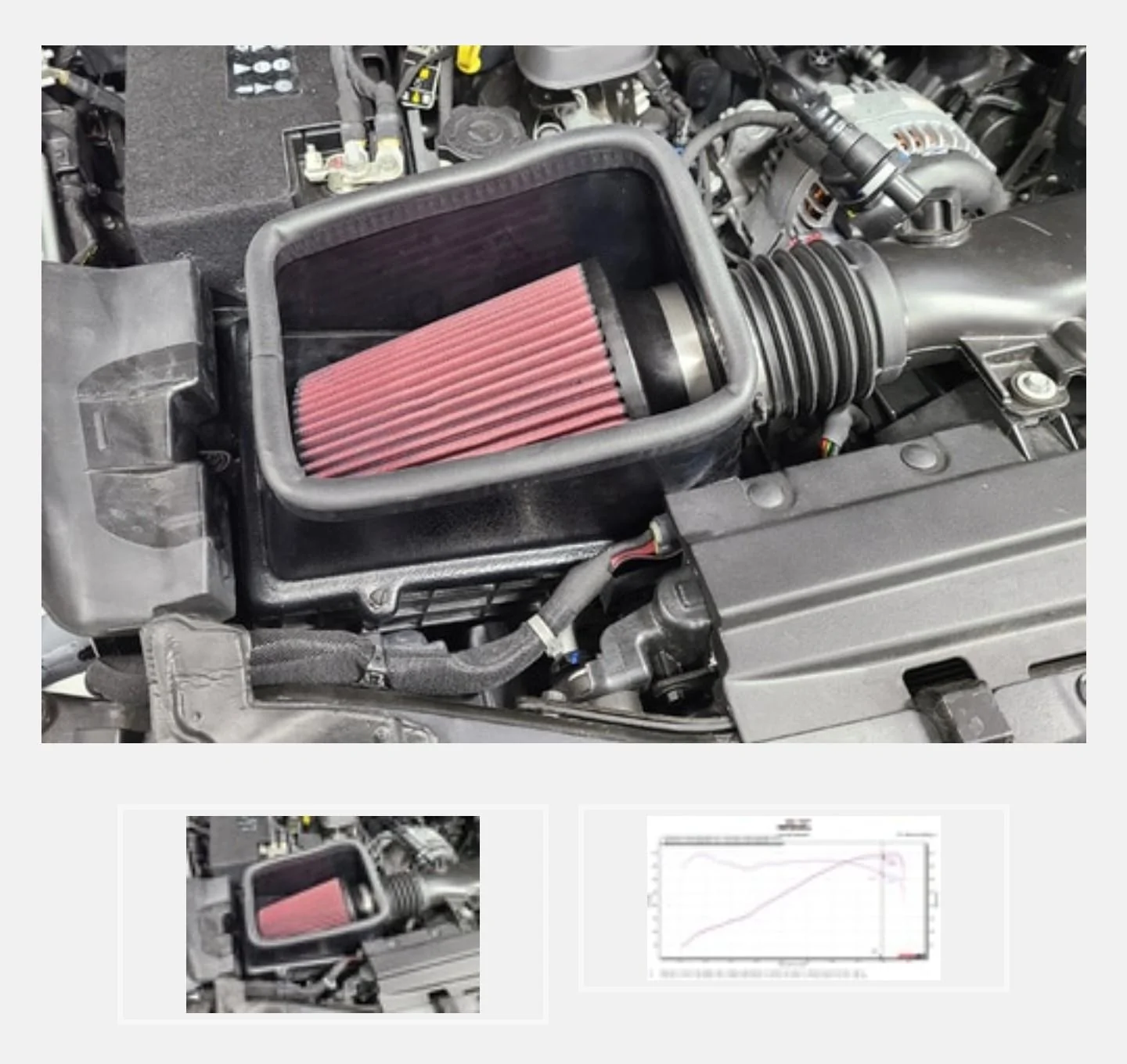

So I don't know if this question has been asked or answered i guess.
Whats the difference between the Open Filter intakes and the ones in the closed enclosures with the small open slot. Do they both give the same amount of air flow?
For example these two:
It's all appearances and sound with the open one likely being louder. People are forgetting there's a little thing called the throttle body that is going to be the ultimate bottleneck in the air intake system. The problems that older vehicles had such as smaller tubing, inlets, and filters are a thing of the past and a CAI will be for looks and sound, nothing more.
I have yet to see a dyno result with nothing more than a CAI that shows meaningful HP gains on a modern gas engine (emphasis on gas... diesels are another story entirely). The gains you'll see are well within the margin of error that would come with gas quality or small environmental changes.

That's why I just went with the JLT set up. It just has the filter and heatsink casing while using the stock inlet. I'm just looking to get a little growl from the engine.

Most of these intakes do not address the stock flow restriction, which is not that significant. The junction between the filter box and intake tube is where the boundry layer starts. If that is small it dictates the flow to the rest of the pipe, no matter what. As for the filter media and such, the OEM stuff is the best comprimise unless you go with a significant additional amount of surface area, and it still has a similar micron filter rating as stock or better. Dirt, dust, and general air garbage will jack up your piston ring seal, which is pretty important and sensitive in the 3.6L's quest to be power dense.
The big curve ball the JT and JL throw at you that no one has spoken about yet, is the fact the ECM controls the throttle body opening, completely and most times different to what you command. The throttle body control is closed loop to the torque demand in the engine. The throttle boddy also has a closed loop position control to help it regulate its position. You start throwing signifcant different intake flows at it, it may run at reduced throttle opening, for a given speed, completely negating what you are trying ro accomplish. Just my two cents. They do look cool
