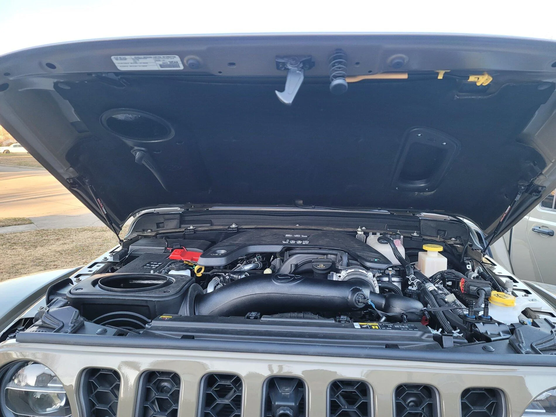

I recently installed the S&B cold air intake kit along with the Rubicon only hood scoops on my Gladiator. I made a quick video about it if you don't mind taking a few minutes to give it a view.

I have the same setup on my rig too.

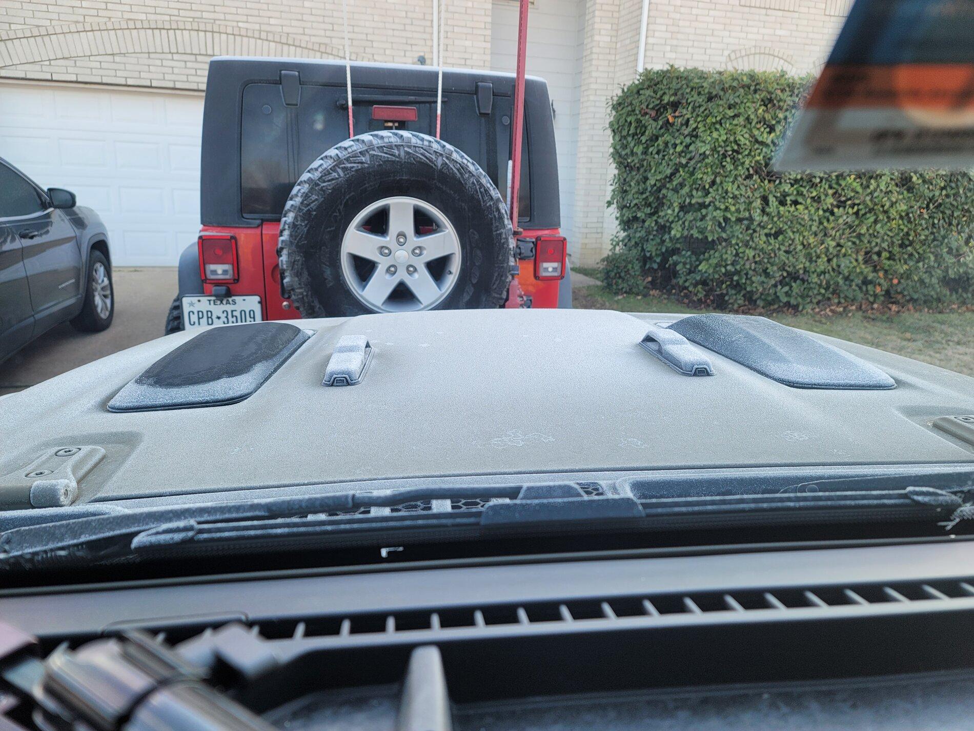

I also noticed during the last cold spell here in N. Texas which frosted everything over that the left-hand vent thawed out while the engine was warming up and the right-hand intake remained frosted over throughout the day of driving - cool-enough to see that the system somewhat works as designed.

Nice try! Obviously a fake video because the airbox switches sides! You thought no one would notice!
Im joking! That is a super clean install man. I want to do something like that for my Mojave. Awesome job!
Mine's on the opposite side from OPs because I have the N Texas version and he has the S Texas version. ;)
