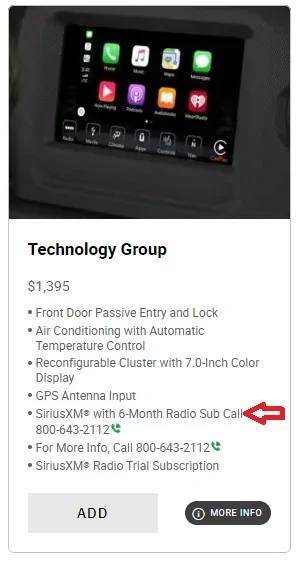

When i was doing research to buy my 2023 Sport Gladiator , i went to the build a Jeep website and under the entrainment section it said the Uconnect4 7" radio had XM as part of the radio , great . So when i took delivery and after signing papers about the XM service i find it did not have XM radio installed which i consider false and misleading information by Jeep . I had mentioned to the salesman that i had a lifetime subscription to XM and that it was important to have it , of course he did not say anything . Anybody else get hit with this surprise ?

Have to read the fine print on the website. Says "available" with XM. You have to get the Technology Group package to get the XM radio.
If you have the basic cluster and no passive entry door locks, you will not get the XM radio.

You are correct in that it says "available" but i still contend it is misleading . What do passive entry door locks have to do with XM radio ?

Because it is part of the Technology Package with the other options determine how the vehicle wire harness are configured. Do not get the Technology Package, do not get the wiring setup for XM that uses a dual use XM and GPS antenna.
I agree, "available" can be misleading but it can also have dual meaning in that it is a selection rather than something necessarily static. You are not the first person who has ordered/bought a Sport and been surprised in not getting something because the Technology Package was not selected. At the end of the day, Jeep built the truck how it was ordered by whomever. Your salesman did you dirty more than Jeep corporate did.
FWIW, it is technically doable to install the XM/GPS antenna and harness on your own and sell/swap your radio for a 7" XM capable radio.
