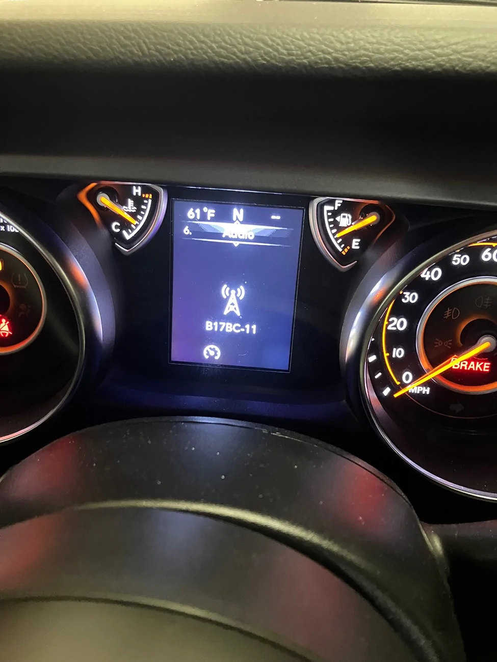

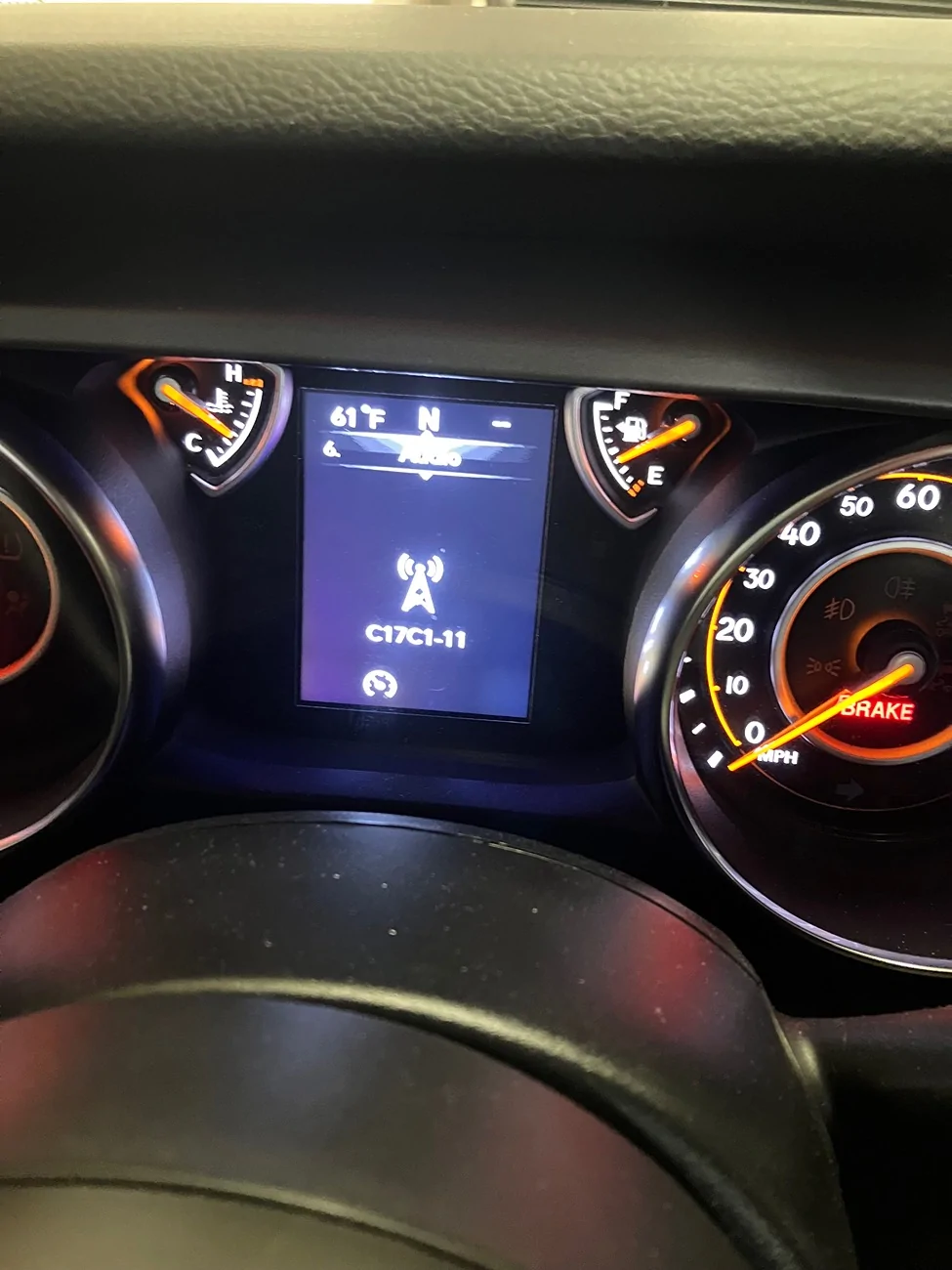

Well this stinks. New battery is in and the dash cluster screen still stays lit. AUX battery isolated at the main and fuse F42 pulled. No issues at all on startup. No crazy Christmas tree lights. I did pull codes from my Tazer and got these yesterday..

UPDATE: Issue is fixed! Once I replaced the battery and disconnected/isolated the aux battery I found the dash stayed lit. I was worried there was a deeper computer issue from the codes I pulled (see images) along with some "module no response" from the TCM and one other module. That lead me to consider un-marrying the tazer to make sure the issue wasn't related to it (and to prepare to bring to a dealer for diagnostics) but I decided to run through the entire fuse box first. Luckily I started at the fuses closest to the fender and found the DTCM (drivetrain control module) fuse F101 was just barely not all the way seated. I pulled and re-seated it and viola, dash is off!! I guess some bumps on my most recent road trip dislodged it just enough to cause an issue. Not sure why that fuse would cause the dash to stay lit to be honest, but new battery is in, aux is disconnected, and no issues...for now.
BLUF: I pulled and re-seated DTCM (drivetrain control module) fuse F101 and the dash went off.
