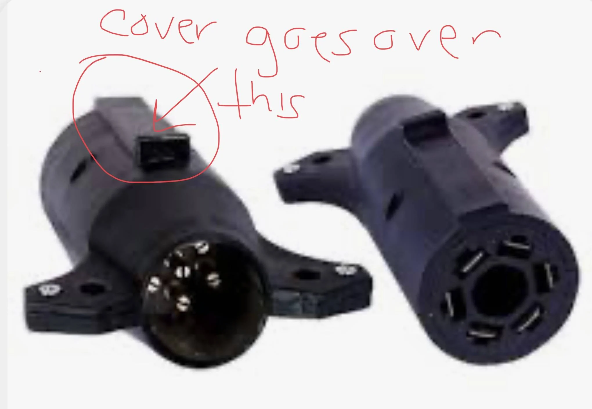

the 7 pins from trailers always have a flat edge on the side that goes directly under the truck 7 pin cover because it helps lock it in as the lid from the truck pin cover catches over it.
I guess you could paint the top bright yellow, but the flat piece should always tell you what part goes directly under the cover and in the case of the gladiator that is up.
IT should be almost impossible to put in in wrong as the flat piece would not go in.

That's a great idea to paint the TOP a bright color so there's no guessing :) :) :)
Gonna happen as soon as I get the trailer home again.

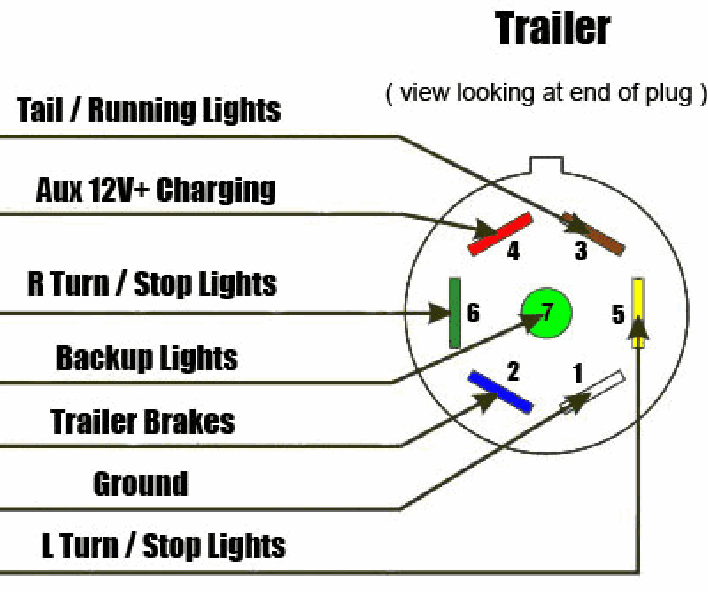

As far as the right turn signal blinking when the left was on - that won't cause a fire! That's low current. Having current go to the wrong bulb is absolutely not the cause. All that would happen is the wrong bulb by triggered. How could that cause a fire? You can swap the wires around manually so that if you turn on the truck left signal the right trailer bulb will blink.
There's only one way that the truck left could be on and the trailer right be on, or the truck right be on and the trailer left be on.
Check out what would happen if the connector was up-side-down.........
Turn on left turn signal and the pulse goes to the RIGHT trailer turn signal.
Turn on the right truck turn signal and the power goes to the left trailer turn signal.
Just like ground and power get flipped, the turn signals get flipped.
Jeep Gladiator Update: Trailer/Truck Issues 1694738200580
What are the odds of a burned harness flipping the turn signal signals to the trailer? Almost nil. Those two wires would be in contact with each other meaning if you turned on either turn signal, then power would go to both trailer bulbs. Think it trough logically.
Burn the wires so the turn signal wires going back there touch - now turning on either truck turn signal sends power to both trailer turn signals because the wires are in contact.
In order for ONLY the wrong bulb on the trailer to come on, the connections have to be flipped, not merged.
They don't all have such a profound "flat part" like pictured. Some are lower....
It can be done, it has been done, I've found 3 people who did it, and admitted it, and showed pictures, there's threads on the RV forums about this.
