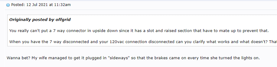

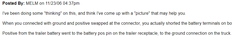

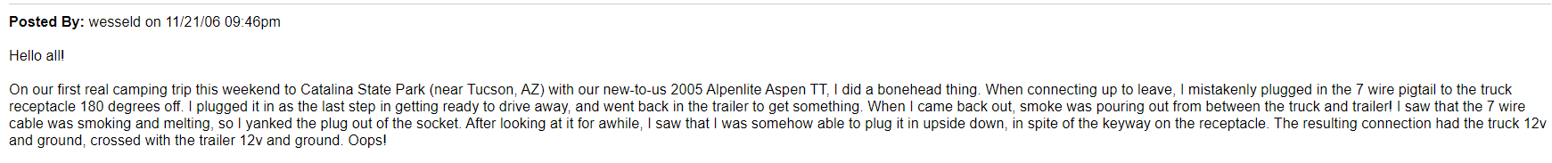

Some say that's impossible, can't happen - and yet I have found two instances of that exact thing happening. A quick - oops, that's wrong, turn it over, insert it correctly, but it was enough to heat wires, melt and merge insulation and do some damage.
I've experimented and most connectors are way too tight to even do that a little, but some trailer connectors are just a loose enough fit they can be flipped and just make contact - not be plugged in, but the contacts actually do touch inside during that brief moment.

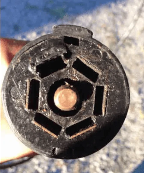

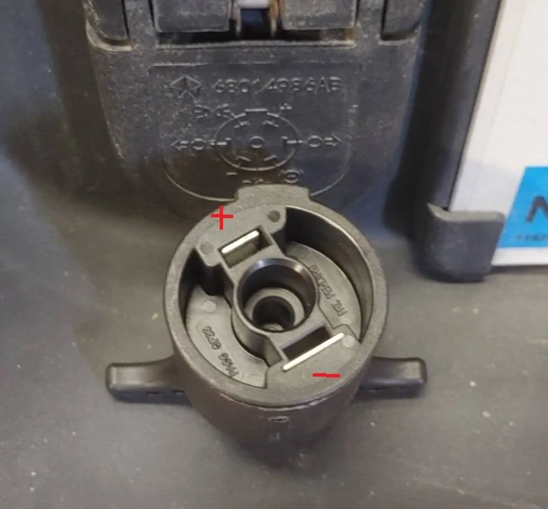

Here's the positioning of the high amp constant hot wire compared to the ground - 180 degrees off. And look at how far out the contacts in the socket stick! Doesn't have to be fully inserted to actually touch the pins in the truck connector.........
Jeep Gladiator MORE Trailer/Truck issues...post dealer visit...(see last post by me starting the same) 20220519_095027
And for the non-believers -
Jeep Gladiator MORE Trailer/Truck issues...post dealer visit...(see last post by me starting the same) trailer5
Jeep Gladiator MORE Trailer/Truck issues...post dealer visit...(see last post by me starting the same) trailer3
Jeep Gladiator MORE Trailer/Truck issues...post dealer visit...(see last post by me starting the same) trailer2
