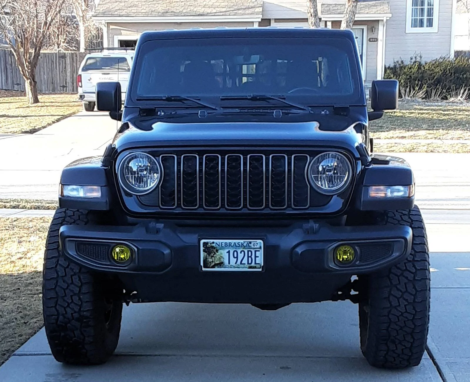

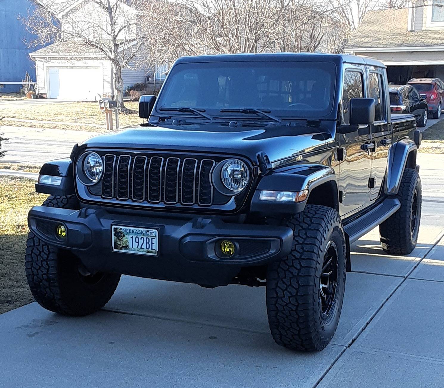

I got mine assembled and put on. Most every tab lined up well enough but I wasn't able to get every clip installed due to fitment issues, but most are in and it feels solid. Assembly was a bit of a pain in the ass for an old man like me. Tedious with all the clips and such but that was it.
I've got $425 in this, $175 for the grill+$250 paint. If I was to do it over again, I'd pay Distinction Applied the extra $100 or so for the aftermarket grill to get a painted & assembled grill delivered to my house.
Jeep Gladiator Updated 2024+ grille installed on my 2020 JT (temperature readings added) 20250308_171941
Jeep Gladiator Updated 2024+ grille installed on my 2020 JT (temperature readings added) 20250308_171954

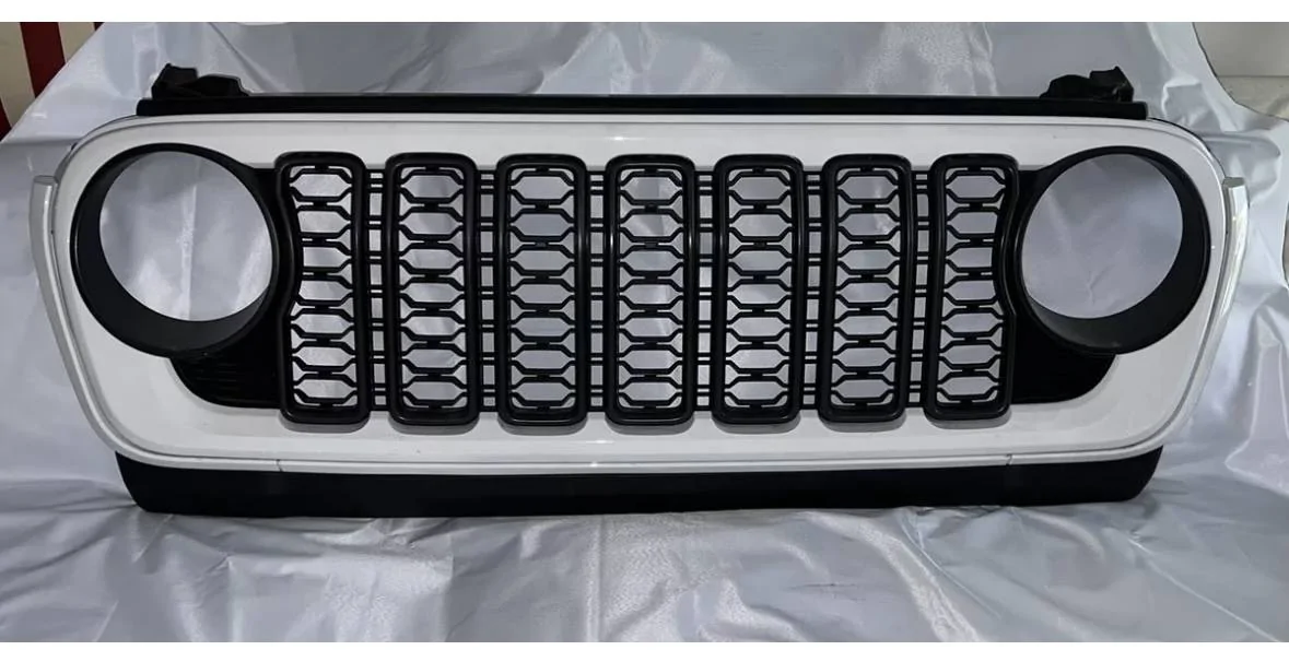

Hey everyone, I finally took the plunge and bought a takeoff 2024 grille, requires no paint since it’s bright white already, but doesn’t have the front camera cutout. Can anyone confirm what I need to make it work? From what I gathered it’s :
7HR05RXFAA texture grille
68566612AA camera bracket
Here is a pic of what I bought and have coming :
Any updates? Does the 7HR05RXFAA grille insert have the lock cutout?
