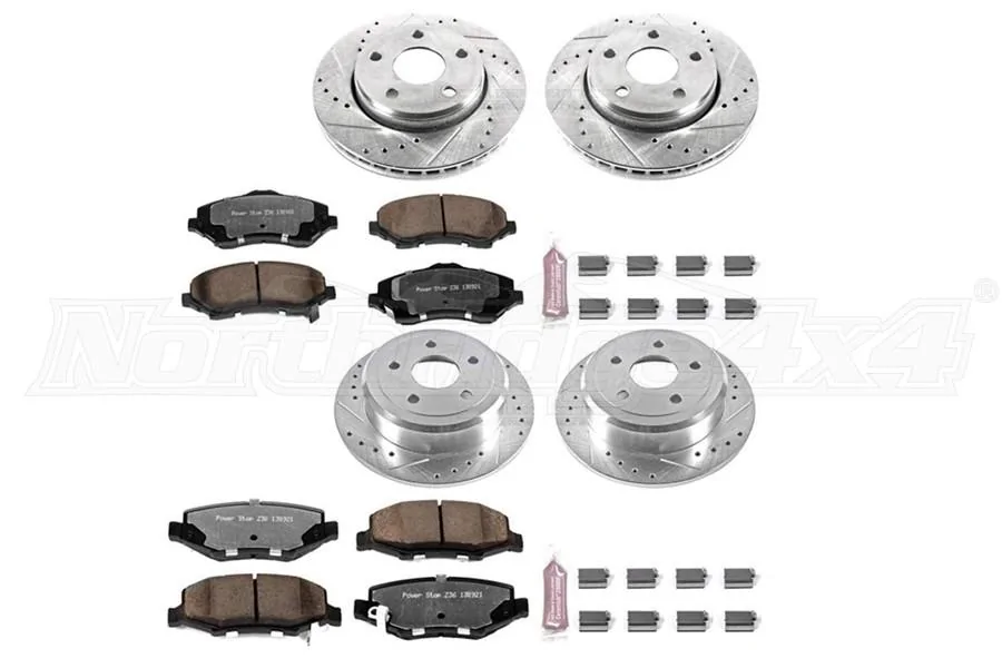

The Power Stop kit make a big difference in stopping power and they have a few different kits available.
Their basic kit is the Autospecialty, which is pretty much and OE type replacement kit with upgraded pads:
https://www.northridge4x4.com/part/...r-stop-autospecialty-front-and-rear-brake-kit
The middle package is their Z23 Evolution kit, which has drilled and slotted rotors and upgraded pads:
https://www.northridge4x4.com/part/...r-stop-z23-evolution-front-and-rear-brake-kit
Their top shelf kit is the Z36 Truck and Tow kit, which has the drilled and slotted rotors and their Z36 ceramic pads and is perfect for those with bigger tires and/or do some heavy hauling and towing:
https://www.northridge4x4.com/part/...op-z36-truck-and-tow-front-and-rear-brake-kit

The answer im looking for. This is great, thank you
