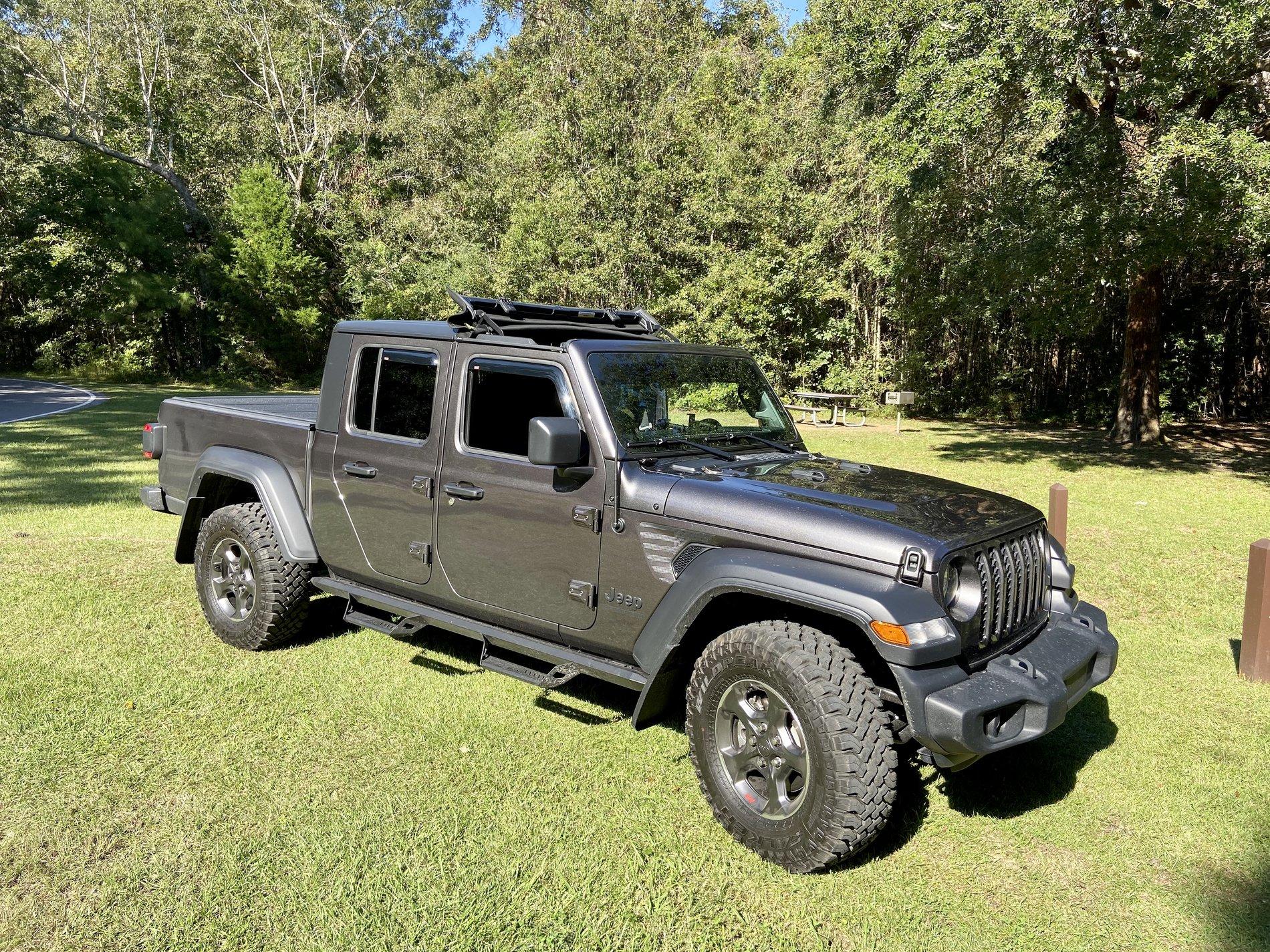

Turned out good. At 70 MPH speedo was reading 4 off. Corrected by the RC correction unit. Speedo now matches two independent GPS units. Had to use 32.5 inches as the new tire height. Truck now feels much better on the highway and around town. Very solid feel.
