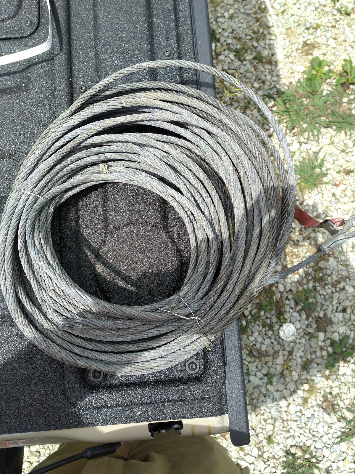

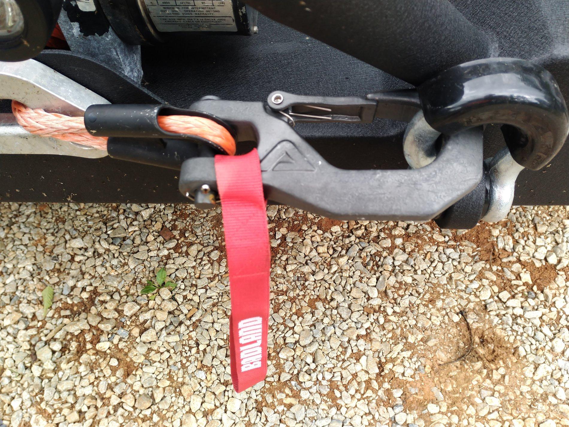

Check out H.F. winch line a hook and AL fairlead is in that range. I bought a hook from there. I local found a place selling winch line by the lbs and got a bunch of it. On my next days off I'm changing out my winch, I will be moving the hook to new winch. The H.F. line is larger dia. But safety in over size line. Otherwise Q-tec has some good ones too with a known company to back up product, and other 4×4 know company's. The line I replaced on my Ramsey was from Q-tec (over due on replacement) now if you don't use the winch much it might not be cost effective to change, no sun damage to cable. That's the OEM Ramsey winch cable 20 plus years old. Been in weather for over 15 years. I changed it out due to high and heavy use.

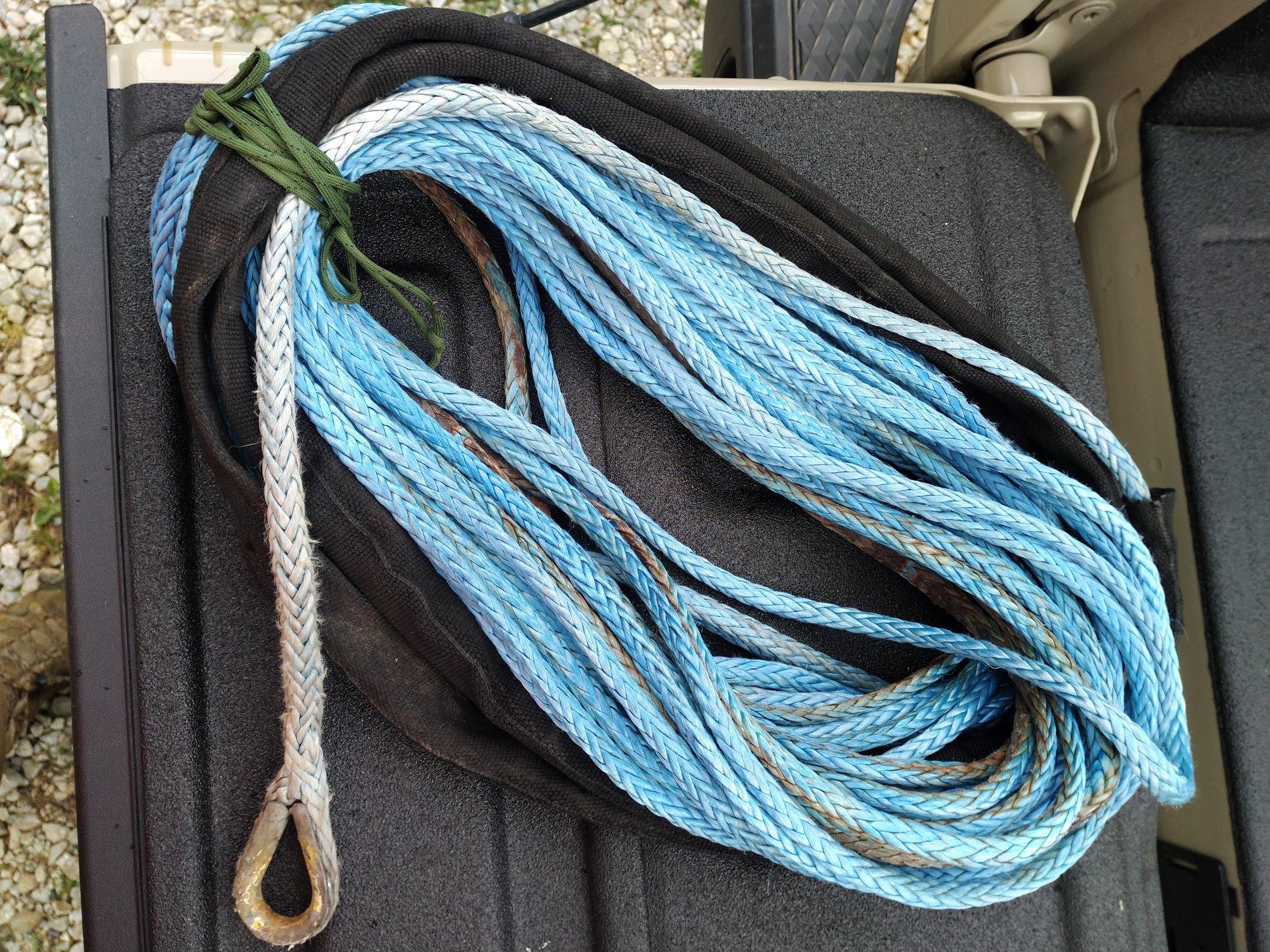

I thought it was a larger dia than that. :like: heck I probably have 10 plus synthetic winch lines scattered around my vehicle's and a few well used old lines. Time to get moving for work tonight.
